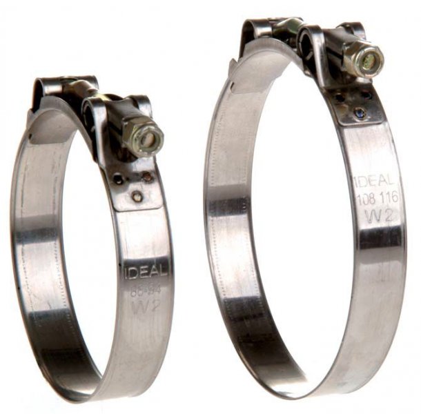

Jabiru Phil Posted May 11, 2013 Posted May 11, 2013 PhilWhy wouldn't you use them on an aircraft, do you have a particular concern? They don't seem to bite into the outer part of the hose like stainless threaded clamps, I was considering them for radiator and fuel hoses, I was looking into the correct sizes to order, given that there are no sharp ends sticking out and no worm drive to fit in confined spaces I thought they might be just the job. RA These are seriously great clamps, but as stated unless you have the EXACT fit the hose blows off, happens all the time in the field. I would use Super Clamps if a more secure fit is required. They are a bronze colour with nuts instead of screw driver to tighten Phi

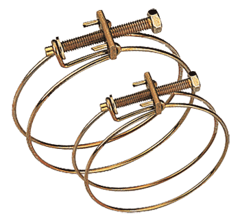

Head in the clouds Posted May 11, 2013 Posted May 11, 2013 I favour T-bolt clamps personally, and wire clamps are good too if not over-tightened. Both provide even ring-pressure. Admittedly they don't address the low-profile issue Rank is after.
facthunter Posted May 11, 2013 Posted May 11, 2013 The thin stainless worm drive ones can be opened up easily and threaded over a pipe, and they have no bulk except where the worm is.. I find the wire ones cut into the rubber too much nev

rankamateur Posted May 11, 2013 Author Posted May 11, 2013 RAThese are seriously great clamps, but as stated unless you have the EXACT fit the hose blows off, happens all the time in the field. I would use Super Clamps if a more secure fit is required. They are a bronze colour with nuts instead of screw driver to tighten Phi Thanks Phil I use superclamps on five inch layflat to feed my irrigation system but the aren't very tractable in small water and fuel hose sizes, they would get a bit cumbersome around an engine installation I think. The best approach to getting the right size fit might be to back off a worm drive clamp on an existing installation and put the calipers on the hose where it is already installed, all the fuel hoses should use the same sized stem for each application. The can't work loose aspect is just as important to me as the compact design. Steve...
