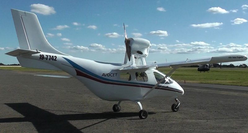

AVOCET Posted May 24, 2013 Author Posted May 24, 2013 Sorry about the bad photos , ill take some more tomorrow with the prop on & the cowels, What looks like a spinner is a 30 amp alt that bolts onto the vac pump attach spline on the 3300 . Not the belt version , this leaves the jabiru alt intact for a backup . Yes it's got a new turret , got some help from an aeronautical engineer to design the basic structure , but it's just like a wing on its edge with a spar , a lot better looking than my first attemp Cheers mike 1

Jabiru7252 Posted May 24, 2013 Posted May 24, 2013 Thanks! When I studied programming, interface design and "don't make me think" sofdware were important aspects of software design. With todays dumbed down programming the simplest things can become a real pain in the bum. Anyway, here's a picture of that Avocet at Gawler. By the way, Avocet is an aboriginal name for a bird that crashes into trees when landing. (Not really, that's a joke). Glad Mike has not suffered any permanent serious injury. P.S. If you rub out the engine, the plane has really nice lines, a tribute to the designer. 1
AVOCET Posted May 24, 2013 Author Posted May 24, 2013 Yes , there are 25 moulds for the fusalerge & vertical stab , I've used the jabiru 250 wings and undercarriage , wing struts are theirs but 30 mm longer , also had to have control cables made to length , Cabin width is 50" & with the rounded fusalerge & has plenty of elbow room , 8 inches between pilot & passenger , Duel control columns ,throttle in the center . Fuel injected , liquid cooled ,dynon skyview, Cruise 105 kt at 2950 rpm ,22 lt/hr stall 42kt MTOW empty weight 375kg . 62" wood prop ( Brent Thompson , only one I could get to make a pusher , does a great job) The take off & landing are pretty much the same as a j230 1

Keenaviator Posted May 25, 2013 Posted May 25, 2013 The Avocet looks to be the ideal platform for a twin - wing mounted engines. It would be a very pretty aircraft and would really perform. 1

AVOCET Posted May 26, 2013 Author Posted May 26, 2013 Hi Phil , good to hear from you , I've got an insurance job at the moment so ill have a bit of materhorn white jabiru . I painted the avocet with materhorn white Cessna , it slightly creamier , and not as glairy as the jab paint , come over for a cuppa and I can do some touch ups for you . The 250 wing can lift a lot more weight than the 230 wing and has a lower stall speed 38 kt They are prity much the same price Cheers Mike

AVOCET Posted May 26, 2013 Author Posted May 26, 2013 The Avocet looks to be the ideal platform for a twin - wing mounted engines. It would be a very pretty aircraft and would really perform. Yes I agree , it's possible to modify the 250 wing to mount engine pods , however as a tractor the prop arch's a bit close to the cockpit , same with the turret mounted tractor ( this my original design , but the prop arch was right over the top of you head ,not a good sales piont !) So as a twin IDE go for a pusher setup , Could be 2x rotax , or D motors , or 2x 2200 liquid cooled , It's a great idea , just need some one to put up the $$ (maybe a few more ) and we are off , any time your ready , Cheers ,mike

Keenaviator Posted May 26, 2013 Posted May 26, 2013 I was thinking the tractor arrangement would work well for c/g. The prop arc of many twins seems close to the cabin.
AVOCET Posted May 26, 2013 Author Posted May 26, 2013 I was thinking the tractor arrangement would work well for c/g. The prop arc of many twins seems close to the cabin. I guess they are , but most twins are a lot bigger than the avocet , so they would seem a lot closer , I've set it out & you carnt even get out of the door without passing through the prop arch . I've had a look at the c/g and it will work as a pusher , better assametrics as well . Pushers work well ,especially with liquid cooling,
Powerin Posted May 26, 2013 Posted May 26, 2013 I guess they are , but most twins are a lot bigger than the avocet , so they would seem a lot closer , I've set it out & you carnt even get out of the door without passing through the prop arch .I've had a look at the c/g and it will work as a pusher , better assametrics as well . Pushers work well ,especially with liquid cooling, How about this configuration?

AVOCET Posted May 26, 2013 Author Posted May 26, 2013 How about this configuration? Yes, I saw this up in bundy , theres no danger to pilot /pass.the avocets got a different wing position , it would make pilot & pas. And engines in front of the leading edge , even so the twin jabs need a fair bit of tail ballast I would think .
Deskpilot Posted May 27, 2013 Posted May 27, 2013 The original accident pics shows the prop in a pusher config... To me the prop flange now appears on the front of the donk in the single faired image..(tractor config)?? I for one wouldn't want to fly something with the prop directly over my head. Has to be a pusher. I do wonder about the leverage in pitch the motor has but. 1
