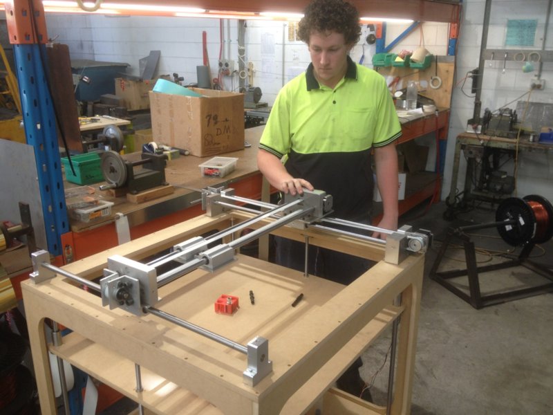

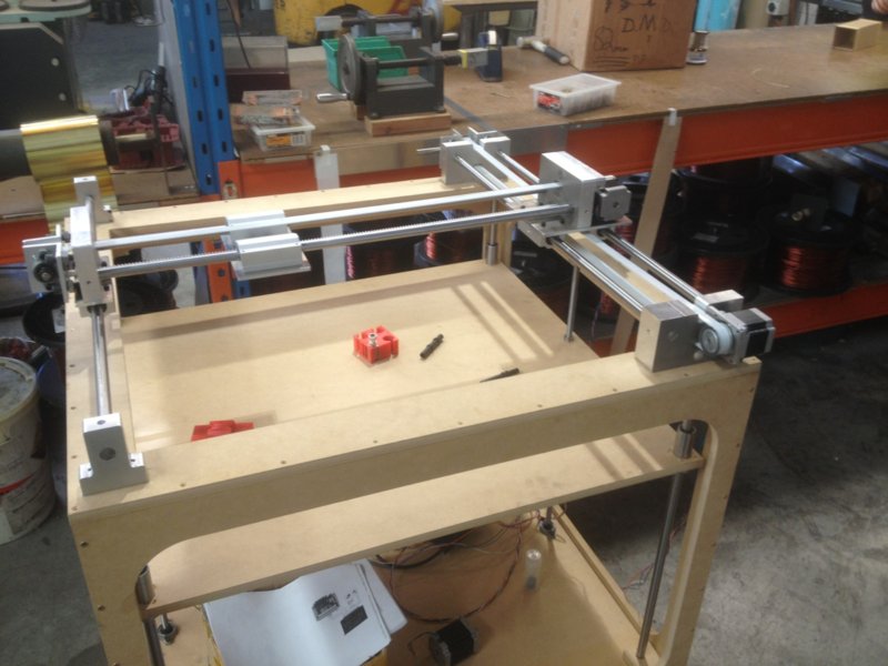

Kyle Communications Posted November 1, 2014 Posted November 1, 2014 Haven't had a chance to get back to the one we are making at work....looks like we are changing from the belt drive to ball screws on X & Y. The belts work ok but the tensioning is a pain over the distance of each axis. This one is 750mm cubed 1

AVOCET Posted November 1, 2014 Author Posted November 1, 2014 Loo Quote Haven't had a chance to get back to the one we are making at work....looks like we are changing from the belt drive to ball screws on X & Y. The belts work ok but the tensioning is a pain over the distance of each axis. This one is 750mm cubed [ATTACH=full]32686[/ATTACH] [ATTACH=full]32687[/ATTACH] Looks great , Nics also using top qual ball screws as we figured the belts might be problematic .

Kyle Communications Posted November 2, 2014 Posted November 2, 2014 Quote Loo Looks great , Nics also using top qual ball screws as we figured the belts might be problematic . We have ball screws on the Z axis. There are 2 for it one at the front and one at the rear they are driven with 2 steppers in parallel. This test frame is MDF but the real one will be plasma cut from steel. 1
