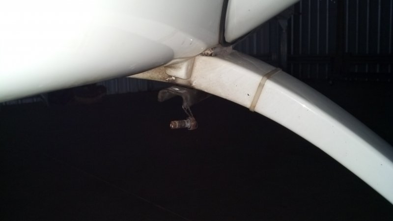

Jabiru7252 Posted May 25, 2013 Posted May 25, 2013 The aircraft, an FK9 was flown at least once with this bolt broken. The bolt was NOT hanging down as shown in the photo, it was in place so the defect would be hard to spot. Makes one wonder just how meticulous one should be doing the daily inspection or preflight. The bolt is on the pilot side forward of the undercarriage. In my opinion, heavy braking may have caused the bolt to give, but, what would I know? Hope this post is of use.... 1
ayavner Posted May 25, 2013 Posted May 25, 2013 wow, shocking! could have been a bad crosswind landing with a too-heavy side load? I always try to check for excessive play in the undercarriage, wonder if my usual check would have found this or not? hmmmmmm 1
cheyenne Posted May 26, 2013 Posted May 26, 2013 The standed check on the Jabiru under carrage bolts is to grab the strut and push the leg forward with your foot any movement detected, then check the bolts. 1

facthunter Posted May 27, 2013 Posted May 27, 2013 U/C retaining bolts near to fracture would be hard to detect. If this is a common fault remove and inspect/replace at a set interval. Dependent on where you use the plane. Any hard landing should be subject to an inspection It's more likely this resulted from a series of loads rather than one. It it was just one it should have failed The thread itself is a crack start point in many situations. Nev
Jabiru7252 Posted May 27, 2013 Author Posted May 27, 2013 The standed check on the Jabiru under carrage bolts is to grab the strut and push the leg forward with your foot any movement detected, then check the bolts. Yes, I give my plane a good wobble about with brakes on and watch carefully for any movement. This plane, an FK9, not a Jabiru is very similar to the Jab with respect to the under carriage so the same check could apply. This bolt has snapped off flush so the remaining bit might be fun removing. I might sit back with a beer or coffee and watch with interest the job undertaken.
Compulsion Posted May 27, 2013 Posted May 27, 2013 The job was done yesterday. A real bitch for Mick. Stuck solid and took a lot of hard work. Last time I walked past the hangar Mick was still trying. 1
bexrbetter Posted May 28, 2013 Posted May 28, 2013 You should do what us race car blokes do, grab a handful of spanners and go run them over every nut and bolt you can see, it only takes a few minutes and it's surprising how many look sound but are just sitting there, just waiting .... 3 1
motzartmerv Posted May 29, 2013 Posted May 29, 2013 Not familiar with the FK9, but the jab service schedule is to replace the bolts at every 500 hours ( I believe). So its probably not a bad idea for other types of similar U/C design. With this design, and the sprung undercarriage, the normal failure point for a heavy landing is not the bolts, but the monocock somewhere else, ie the wall of the fuse etc. The bolts and u/c are normally found to be ok.
frank marriott Posted May 29, 2013 Posted May 29, 2013 Just did the 500hr replacement - interestingly 2 bolts had a slight bend - I can't blame anyone for a heavy landing as I am the only one who has flown it, I don't recall anything significant in the landings but nobody else to blame.
motzartmerv Posted May 29, 2013 Posted May 29, 2013 Frank, I doubt you would have bent them with a heavy landing. We just did ours a few months back, and our training j230 copps a pretty hard time, and its bolts were not bent. Was it the first round of replacement for you? I know they changed the bolt types a few years back.
frank marriott Posted May 29, 2013 Posted May 29, 2013 Frank, I doubt you would have bent them with a heavy landing. We just did ours a few months back, and our training j230 copps a pretty hard time, and its bolts were not bent. Was it the first round of replacement for you? I know they changed the bolt types a few years back. Yes, just clocked up 500hrs - they were not bad, cracked or anything visible but obvious had some stress load at some time. 2008 model. I would have thought in the training mode they would have a good workout at times.

Old Koreelah Posted May 30, 2013 Posted May 30, 2013 U/C retaining bolts near to fracture would be hard to detect. If this is a common fault remove and inspect/replace at a set interval. Dependent on where you use the plane. Any hard landing should be subject to an inspection It's more likely this resulted from a series of loads rather than one. It it was just one it should have failed The thread itself is a crack start point in many situations. Nev Whatever happened to "bleeding bolts"? Seemed the ideal solution the problem of invisible cracks,
AVOCET Posted May 30, 2013 Posted May 30, 2013 I've found on the jaby type U/C that grass or rough ish dirt strips really vibrates the U/C ,on the avocet you get a good view of the wheel & leg and i was suprised how violent it moves back & forth ,even on the taxi , it looks like the bolts are loose . I would think this has a fatigue effect on the bolts , as I have replaced several over the years with slight bends . It used to be the back bolt on the old Jabys Doesn't seem to be as much of an issue if they are only used on the Tarmac . Cheers Mike
Old Koreelah Posted May 30, 2013 Posted May 30, 2013 I've found on the jaby type U/C that grass or rough ish dirt strips really vibrates the U/C ,on the avocet you get a good view of the wheel & leg and i was suprised how violent it moves back & forth ,even on the taxi , it looks like the bolts are loose . I would think this has a fatigue effect on the bolts , as I have replaced several over the years with slight bends . It used to be the back bolt on the old Jabys Doesn't seem to be as much of an issue if they are only used on the Tarmac . Cheers Mike You're right about the Jab UC getting taking a caning, Mike. While landing on a rough grass strip the inner RH leg bolt suddenly failed. Old mate instructor beside me was unfazed as we skidded to a stop, dragging the R wingtip across the tussocks. Good design: prop didn't touch the ground, and I was able put a seat cushion on my head, the wing on top of that, as the bolt was replaced. Then back in the air!
