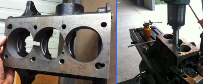

bexrbetter Posted January 3, 2014 Author Posted January 3, 2014 Just to keep you guys informed, things are going very well but on the the company side of things - although I know you want to see engine building action, without company structure it just can't happen. These are bad times to do things in China as well for me, I have my Western Xmas slowdown and then in about 2 weeks time the Chinese start their slowdown for Spring Festival which is January 30 this year (they go by the Lunar calender and it's different each year). I did get to some destruction testing the other week though, checking out oil gallery routes and wall thicknesses on the throwaway blocks my silly machinest put his machining fixture locating holes right in line with 2 of my stud holes as the keen eye will see here ...
turboplanner Posted January 3, 2014 Posted January 3, 2014 Has happened to all of us, and I may have even mentioned this sort of thing previously.# Working from two dimension drawings into three dimensions, or even from 3 D Cad, the mind doesn't seem to visualise everything in 3D, but with the benefit of hindsight the odd mistake just looks so obvious. Its just part of the design stage. # e.g. a major diesel engine manufacturer's oil galleries are somehow restricted, and it's necessary to use very expensive oil to solve the problem.
