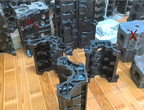

bexrbetter Posted July 29, 2013 Author Posted July 29, 2013 What caste? Very clever! how about an engine to compete with the two strokes. I have a little secret experiment that is undeway actually, it's about halfway developed. My good friend Mal Beare's "6 Stroke" engine has a place in aero as well because the secodary crankshaft running at half speed can direct drive the prop and when Mal gets his current troubles sorted out I might be chatting to him about it. And then there's the 2.4 litre lightweight V8 (smooth 180hp very cheap) we got on the drawing board along with the 1.6 flat 6 - not short of backups! But I am a one step at a time guy and I just had a phone call while writing this that I need to be at the casting works this Thursday or Friday - I will get pictures. 1

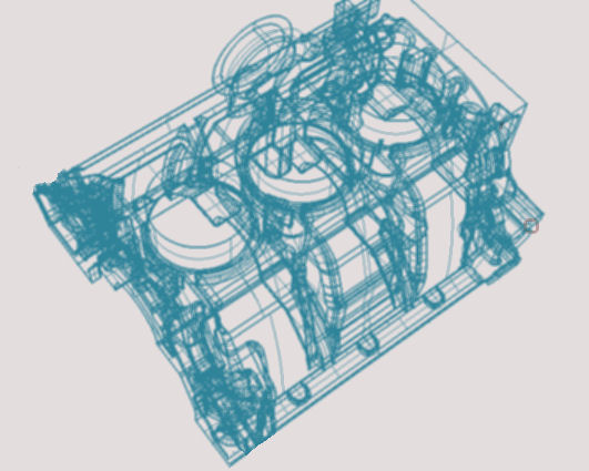

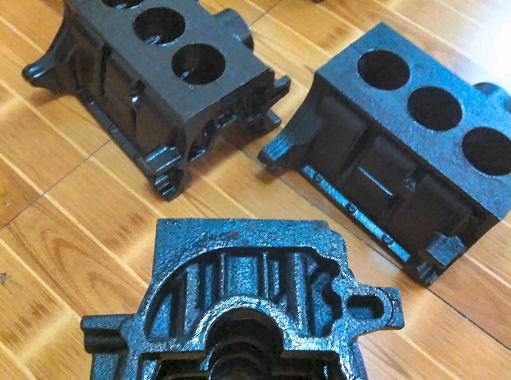

bexrbetter Posted August 7, 2013 Author Posted August 7, 2013 Anyway, the mold company are getting along nicely with my finalised crankshaft housing design. Look familiar .... Still a long way to go but off to a good start These are sample batch of raw castings straight out of the molds for me to measure and inspect and change where required .... 4
Old Koreelah Posted August 7, 2013 Posted August 7, 2013 Wow, first baby pix! A very exciting time for the new dad... 1

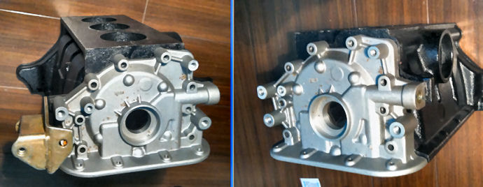

bexrbetter Posted August 7, 2013 Author Posted August 7, 2013 Wow, first baby pix! A very exciting time for the new dad... Lets hope there's not too many shitey nappies and broken sleep ... Here I just sat the oil pump onto the crank housing along with the alternator bracket - the height of the crank housing was determined by the oil pump as you can see (about 5mm will be machined from the height). As I have mentioned previously, the whole idea is to use mass production items where possible and the oil pump here is an example.... 4

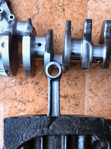

bexrbetter Posted August 11, 2013 Author Posted August 11, 2013 I wanted to size a few things up today but alas my crankshaft won't fit into the unmachined housings, will have to wait until I receive a few of the machined ones around the 20th. You can see the aproximate stick through of the con rod ... 2

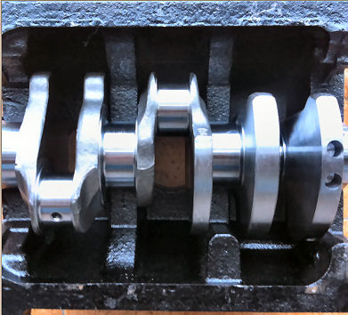

geoffreywh Posted August 13, 2013 Posted August 13, 2013 good looking forged? crank....nice big journals... how you gonna arrange the mains bolts? right through?

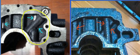

bexrbetter Posted August 13, 2013 Author Posted August 13, 2013 forged crank....nice big journals.. Good eye and you're not kidding, 800cc triple yet uses 50mm mains! That also translates into decent overlap of the BE journals and it's quite short adds up to make a hell of a stiff and robust crank for the job. the mains bolts? right through? Yuh, if you look at the castings carefully you can see the bosses for them. Those bosses are the biggest reason for the new castings, was too difficult just to cut an existing engine down although I looked far and wide for a suitable one but anyway, has worked out well. Not bolts of course, studs. Here you see my experimental cut up and drilled through housing that influenced the new one's design, especially stud bosses arrowed .. Studs will be part of the center housing and the crank housings will slide on, then the main caps. Messy assembly work for me but not complicated and certainly easier than a Subaru for example and no harder than a VW Congratulations....... Thank you, appreciated.. 1
