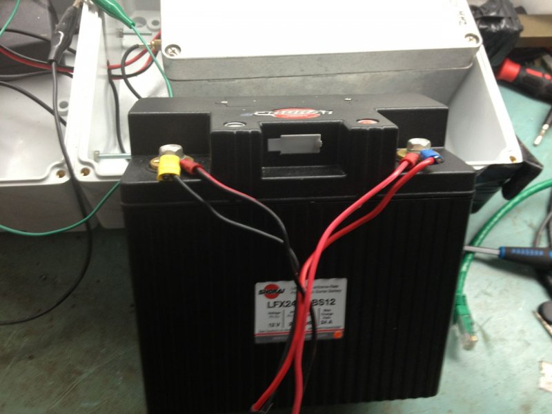

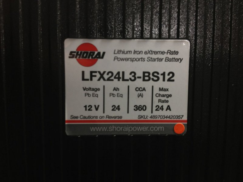

Kyle Communications Posted June 1, 2013 Posted June 1, 2013 I have just purchased a Shorai battery it is 24 amp hour 360 CCA they are quoting the 6 year or so mark. it weighs only around 2 kg. They are using them in motorbikes and also aircraft in the USA. They are the S04 technology

Kyle Communications Posted June 2, 2013 Posted June 2, 2013 Battery charge volts when the engine is running should really be no more than 14.5 volts otherwise you will overcharge and overheat your battery. Ambient heat in the engine compartment is also another killer of batteries. Steve the Shorai is not for the aircraft starting but for my CPAP machine and also to charge all my portable devices then when I am flying I plug it into a anderson socket arrangement I will have in the front to keep the battery charged while flying it will be used to start the aircraft if my normal battery goes flat or falls over. The Shorai will mount in the front of the cabin under the pax position or in front of the joystick area I have decided yet and will plug into this nice socket with protective front spring loaded cover this gives me access to power as well that is on the line side of the aircraft electrical system so the master does not have to be on. The only thing with the Shorai is you do need to keep the battery balance charged. The little connector in the middle at the top of the battery is for this so if you haven't got a battery charger for A123 cells then you need to buy their charger. I have those type chargers here so I just made up the lead and balance charge the battery with it Odessey batteries and similar are a pure lead battery and weigh a ton. The one I had weighed 15kg for the same size as this Shorai that weighs a touch over 2 kg 1
