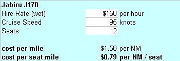

Hi OME, Thanks and I did understand your question which I think I responded to in my first post. The point of my second post was to demonstrate why I think the original calculation doesn't mean anything as I can't see how one cannot consider other costs as these are what comes out of our pockets to get from A to B. I think it would be more useful to do a comparison based on all costs. Each aircraft will have different operating and maintenance costs. However as aircraft owners each have different use and maintenance profiles, perhaps the best way would be not to base calculations on owners costs but on average wet hire rates. A J170 based on hire rates is shown below. If you have a specific purpose for not including these other costs, then sorry I have missed the point and I don't wish to hijack your thread. Thanks. Eric.

....Do the calculation again using 100 hrs per year and see how you get economies of scale.
Yes agree, the breakeven point for owning vs hiring my J170 is about 140 hours per year. I did the sums before buying my aircraft to justify ownership vs hiring and decided that the spreadsheet must be wrong so I threw the spreadsheet out and went with my heart instead. Baked beans on toast for 3 meals a day so I can fund my habit ain't so bad. Eric
It helps if you put a (generous) dollar value on the satisfaction of owning your own aircraft and flying when you want to. A bit like the goodwill value of a business. It makes the real cost of ownership a little less depressing.
