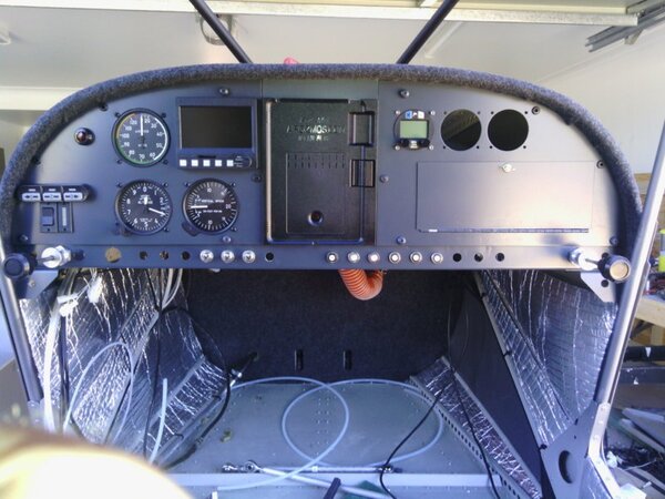

Kyle Communications Posted December 18, 2013 Posted December 18, 2013 I found it Ross….I want mine mounted in the dash Airgizmo makes one for the purpose. I am running out of space in the dash was hoping to get the avmap in the dash as well but it may not all fit

Kyle Communications Posted December 18, 2013 Posted December 18, 2013 mine will be flush mounted in the dash

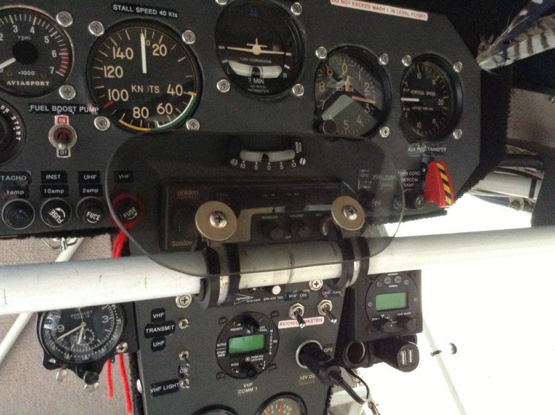

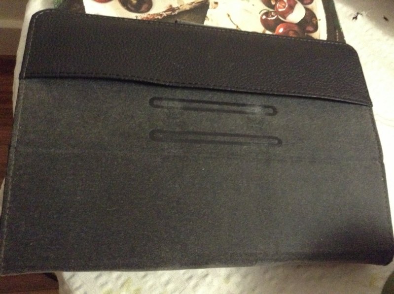

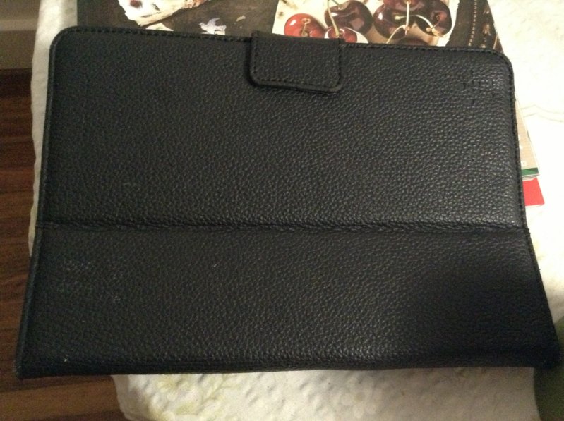

Guest Maj Millard Posted December 18, 2013 Posted December 18, 2013 Pic please? Ok.....you go and buy a leather Belkin case for your mini Ipad, when you fold it over it has a pocket along the top side. I fabricated the simple mount from lexan and a couple of clamps, which attaches to the convenient bar in front of the Lightwing panel ( could also be attached to a flush panel with some additional work ). The Belkin cover sits right on this, and is secured with a simple aluminium clip that slides down on the cover to secure it. Quick and simple to fit, and simple to remove so you can take it with you. Ipad never needs to be removed from the cover. Sometimes simplicity just wins the day !.................Maj....
