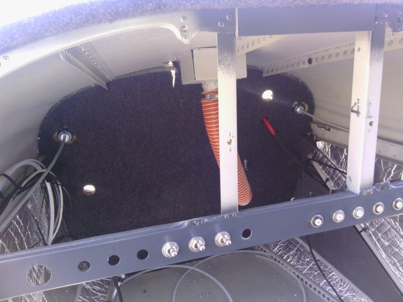

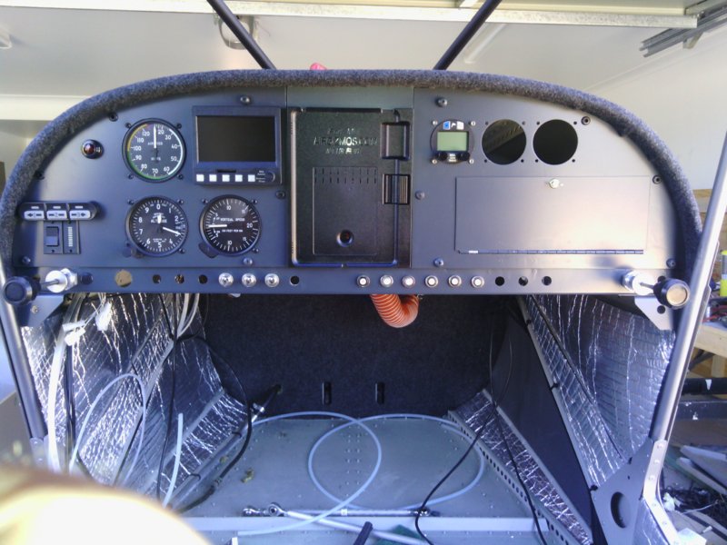

rick morawski Posted December 29, 2013 Posted December 29, 2013 Yes please RickCan you post sone pics of the install First pic shows how i cut off the vertical part of the panel sub frame and added in 2 new ones made of 1" x 3/4" angle closer to the center, 6 1/4" apart to take the airgizmo. Second one shows the panels in situ. They are two separate parts on either side of the airgizmo panel. The right panel has a glove box in to fill it up a bit because it looked a bit sparce, also handy for POH and what nots. Still got to finish the wiring but getting there, hoping to have it finished and test time flown before Natflly. 1
Kyle Communications Posted December 29, 2013 Posted December 29, 2013 I like the pNEL RICK YOUR STARTER SWITCH YOU HAVE PUT DOWN ON THE SWITCH BAR ALSO THE THROLLES…HOW HAVE YOU DONE THOSE THROTTLES THEY LOOK LIKE THE ONES FROM AIRCRAFT SPRUCE BUT ITS DUAL?????..crap sorry about the caps not going to retype…..what are the tabs/switches above the trim switch and indicator…I see you have fitted a glovebox as well. It looks like you didn't use the bottom switch cover rail either Is she flying yet?

rick morawski Posted December 29, 2013 Posted December 29, 2013 I like the pNEL RICKYOUR STARTER SWITCH YOU HAVE PUT DOWN ON THE SWITCH BAR ALSO THE THROLLES…HOW HAVE YOU DONE THOSE THROTTLES THEY LOOK LIKE THE ONES FROM AIRCRAFT SPRUCE BUT ITS DUAL?????..crap sorry about the caps not going to retype…..what are the tabs/switches above the trim switch and indicator…I see you have fitted a glovebox as well. It looks like you didn't use the bottom switch cover rail either Is she flying yet? No flying not yet, maybe Jan or Feb. The little switch panel above the trim is elect flaps controller, I can set the flaps to up, half or full with a button push without taking my hand off the throttle. Yes the throtle controls are from ACS, they go to the throttle torque tube thingmy same as the solid rods, but i like them down on the lower panel - comes easier to hand I think, also easier to take out the panel without having to dismantle your throttles.
