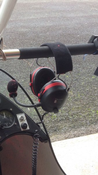

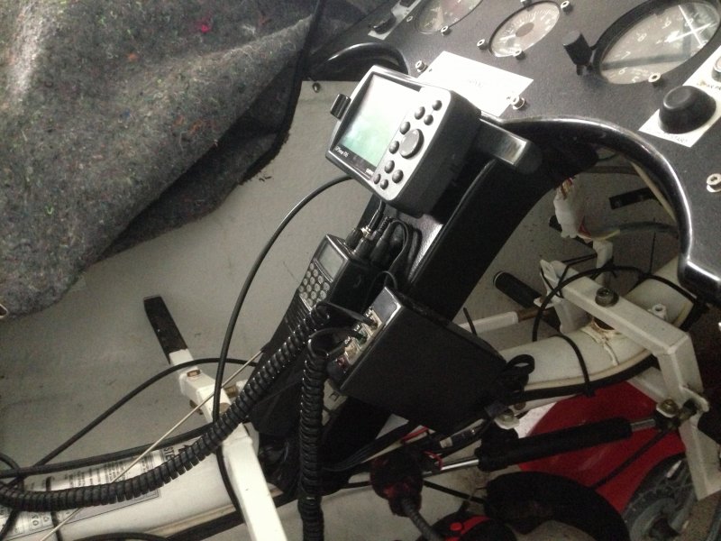

Mark11 Posted July 16, 2013 Posted July 16, 2013 One of my peltor headsets has a dodgy mic I have no idea of the model as it came with the trike I also have no idea what the intercom system is - can't find a brand on it I also am not sure the connector - looks like a telephone plug RJ12 I have a few options 1) try to fix it 2) get a new or working second hand - my difficulty here is finding one with the right plug The head set is comfortable and works fine, so not interested in spending a fortune Open cockpit I forgot to bring it home to pull to pieces! Anyone ever fixed one? Anyone have an old one they no longer need ? It will be the passengers headset! Mark

Patrick Normoyle Posted July 17, 2013 Posted July 17, 2013 It's an aerial pursuits system, I have the same in my drifter. Not hard to problem solve, call me if you want some ideas. 0408931040, or Send me a message. I'd start by pulling the headset apart and check for loose or broken connections.

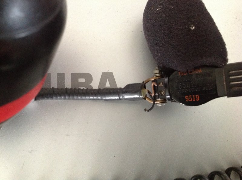

skeptic36 Posted July 17, 2013 Posted July 17, 2013 My pax one stopped working last flight, pulled the foam off, and right there in front of me was a broken wire,right up close to the mike. Wish all my wiring problems were that easy.
Mark11 Posted July 17, 2013 Author Posted July 17, 2013 It's an aerial pursuits system, I have the same in my drifter. Not hard to problem solve, call me if you want some ideas. 0408931040, or Send me a message. I'd start by pulling the headset apart and check for loose or broken connections. Thanks Patrick Good to know what intercom it is - it works perfectly My passengers headset stopped working and pretty sure it's the mic - he could hear me, but I couldn't hear him I'll pull it apart and look for the loose wire Cheers Mark
Mark11 Posted July 17, 2013 Author Posted July 17, 2013 My pax one stopped working last flight, pulled the foam off, and right there in front of me was a broken wire,right up close to the mike.Wish all my wiring problems were that easy.[ATTACH]23023[/ATTACH] Great pic- thanks skeptic That will be the first thing I do this weekend Cheers Mark

Herm Posted July 17, 2013 Posted July 17, 2013 I Thanks PatrickGood to know what intercom it is - it works perfectly My passengers headset stopped working and pretty sure it's the mic - he could hear me, but I couldn't hear him I'll pull it apart and look for the loose wire Cheers Mark f you want to be sure if its the mic or not try a simple test. Swap the headsets and see if you have the same problem. This way you will be able to make sure the problem follows the headset and is not a problem in the intercom. Mic inserts are very cheap and you can buy them at Jaycar electrical for a few dollars. When you remove the wind sock foam you may find number details on the mic that a pats supplier will understand. 1
Mark11 Posted July 17, 2013 Author Posted July 17, 2013 If you want to be sure if its the mic or not try a simple test. Swap the headsets and see if you have the same problem. This way you will be able to make sure the problem follows the headset and is not a problem in the intercom. Mic inserts are very cheap and you can buy them at Jaycar electrical for a few dollars. When you remove the wind sock foam you may find number details on the mic that a pats supplier will understand. Thanks herm Ill be able to put my soldering iron to use again! For anyone owning a Pajero (mine is NM), if you ever find a problem with a faulty temp gauge, I know how to fix it - you just need a soldering iron!
