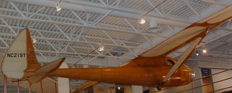

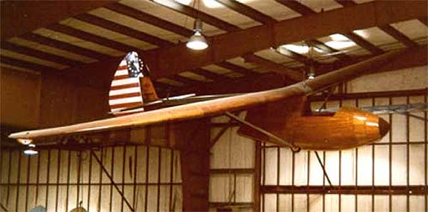

Deskpilot Posted August 11, 2013 Posted August 11, 2013 Just an image or 2 of graceful, wooden planes. 2
Soleair Posted August 11, 2013 Author Posted August 11, 2013 Wow! Those planes are just so beautiful. Bet they wouldn't need much power to push them along, either. Why aren't SLMG more popular?
