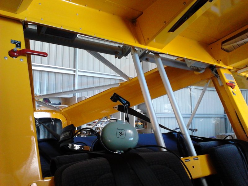

biggles Posted August 14, 2013 Posted August 14, 2013 I have two isolation valves. One for each wing tank. Makes fuel management possible and prevents transfer between tanks. Can't say I would like any other set up.[ATTACH]23274[/ATTACH] [ATTACH]23275[/ATTACH] I have same set up . Both cocks normally open , and on pre-start check list . Bob 1

frank marriott Posted August 14, 2013 Posted August 14, 2013 Nev On all the later models (don't know about the earlier ones) the two tanks are gravity feed to a header tank so short of a blockage with fuel in one tank there is continual supply. I have read of the ones with a tap on each tank but I gather they were kit built. The incident I read about was a test flight on someone's aircraft by a pilot who had only flown the factory set up had fuel problems after the header tank ran out. He was not aware of the head high on/off taps. Biggles ".I think the move to the float driven LEDs was designed to overcome the problem ." On mine at least, the dash mounted LEDs read the same as the wing root mounted ones - just easier to read on an instrument scan.
