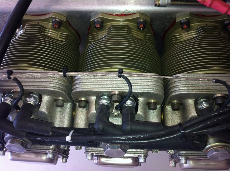

AVOCET Posted August 12, 2013 Posted August 12, 2013 I've just done the CHT mod that jabiru recommend ,it gets rid of the 14 mm ring that goes under the spark plug that can let hot gas escape and give a high head temp reading . I was pleased that all my heads now read pretty even , I always had a high reading No3 due to leaking gas .(no more ) The mod is called ::: AVDALSR085-1 CHT mod It took about 40mins to do the 6 sensors , The hardest thing is snipping away the old 14 mm ring with sharp side cutters and not damaging the wire that's welded together at the ends .i just snipped away a bit at a time until it falls off the wire then crimping on the new ring . Cheers Mike.

facthunter Posted August 12, 2013 Posted August 12, 2013 The ones under the plug are not ideal. That is for sure. They would change the effective heat rating of the plug, and be likely to cause a lack of sealing ( as you state). How do you like your liquid cooled heads? Nev

AVOCET Posted August 13, 2013 Author Posted August 13, 2013 L The ones under the plug are not ideal. That is for sure. They would change the effective heat rating of the plug, and be likely to cause a lack of sealing ( as you state). How do you like your liquid cooled heads? Nev LCH work great ,check out the R/tec website Cheers
