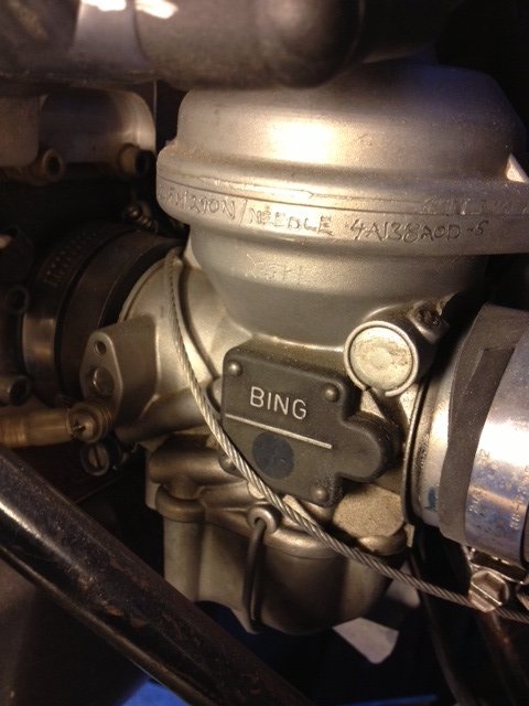

facthunter Posted September 2, 2013 Posted September 2, 2013 Separately. OK Injecting some oil into the intake before shutting down is a good short term fix. I would use an outboard oil for the extra corrosion inhibiting aspects of it's formulation. Strictly speaking the outboard oils are not for aircooled applications. It won't stay there long after starting next time anyhow. I wouldn't get it anywhere near the carby as it might run into some passages and affect it's calibration/performance. The trick is to get it evenly distributed. To do that it would have to be a fine mist over a period of time SAY 15 seconds. This might be a bit hard to achieve . If you are in doubt remove the cowl and one plug from each cylinder and spray a bit in each one.. If you are adding upper lube to fuel you need hardly any. Probably an egg cup to each tank. The only oil I would use there is a recognised two stroke oil as other may foul plugs produce deposits,not mix well and lower the octane rating. Oil in fuel can make it "GO OFF" sometimes. Don't let fuel get stale in your tanks anyhow. If it's mogas chuck it in the old car. If it's avgas you shouldn't do that unless it is a pre converter 1982. model. Nev
Old Koreelah Posted September 2, 2013 Posted September 2, 2013 Thanks for that, Nev. I seem to have got away so far without significant rust in the bores because of our dry climate, but when I start big trips that my change. I might install an oil injector between carby and intake system. My Bing has what seems to be the ideal spot; a blanked-off hole as shown in the image.
