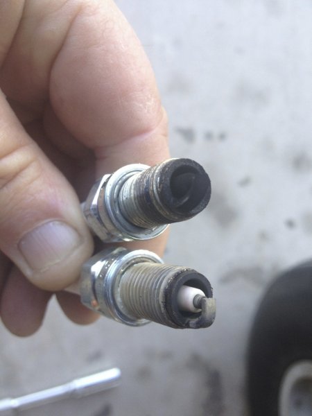

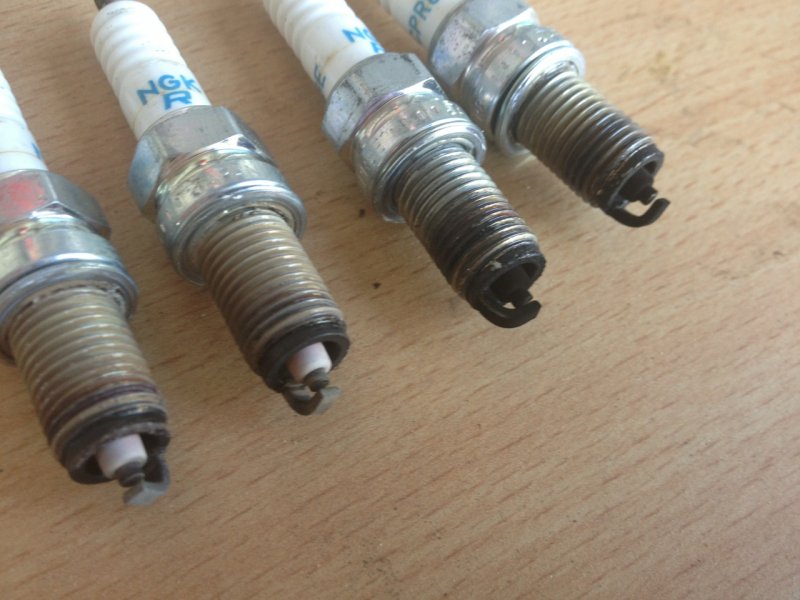

Kyle Communications Posted September 1, 2013 Posted September 1, 2013 Hi All I would like some advice on the plugs out of my 912ULS please. I did a oil and filter change today and pulled the plugs out to have a look at them to make sure they were ok. The attached pictures show their condition. Is this normal? The 2 left plugs are from the opposite rear cylinders and the 2 on the right are from the 2 front cylinders. You can see the 2 from the rear are burning quite well maybe a tad lean but I didnt expect to see the front plugs so dark. The carbys are fed each side so the rear plugs have a shorter inlet manifold length and the front plugs are furtherest away from the carbys. I am no mechanic but I did expect some difference between them but not as much as can be seen. Expert advice and solutions if any needed please Mark
Guest Maj Millard Posted September 2, 2013 Posted September 2, 2013 Mark, without knowing how many hours on your engine it is hard to comment accurately . Those plugs look ok to me for a low hour engine. The 912 s will continue to pass a bit of oil past the rings until they fully seat in, which can take up to 100 hrs or so depending on how you run it. Nikasil cylinders are very hard and take a while to seat the rings. The 912 can take several hundred hours before it is fully settled in. Mine has just done 750 hrs and is now starting to really sing !...I have run those engines with 2000 hrs + and they become smooth as, like little turbines. The two foward cylinder plugs will be a bit richer normally, because those front cylinders are running a bit cooler due to the direct blast of cooling air. Not much you can do about this as it doesn't seem to really worry them. Burn colour is always read on the centre- post ceramic, ensure you have the correct plugs, (DCPR8e) and gap them by the book. You could check that the idle air jet on the exterior of the carb is set at 1.5 turns out as required. (Both carbs) Last thing you want to do at this point is to fiddle or adjust anything in the carbs themselves, and do not ever try to adjust the float levels. Go fly more, things will only get better !....................Maj...

Guest Maj Millard Posted September 2, 2013 Posted September 2, 2013 Yes thanks Mark, It's still seating the rings I would say. The 912 does tend to run too cool in most installations. Up here where it's warmish most of the year, I run with my coolant radiator half blanked off all year round, and with the oil cooler half blanked in the cooler months. Even then I still run at the bottom end of the green on both, with the standard Rotax coolers..( At cruising altitudes anyway) For plug gaps I like about .024 " which is just a light tap or two from out of the box ( factory gapped at .025".). Additionally I 'm only turning about 53-54 max RPM due my current prop and cruise pitch, however I may back it off a degree or two soon, just to liven things up a bit. Also the quality of the mogas we run now is quite variable in my opinion. If you run a touch of avgas now and then, even a mix, you'll find the plugs clean up a bit even though you do get a bit of lead deposit on them. Hope you and all are well down there .......Cheers..................Ross

cscotthendry Posted September 2, 2013 Posted September 2, 2013 Mark: I have about the same number of hours on my 912uls and my plugs look the same as yours. I too was puzzled as to why the starboard side rear cylinder seemed to be running about the right color and the port front was dark and sooty. That said, I'm getting 17-18L/Hr at 5,000 RPM which I'm told is about right. BTW, I'm assuming that you've done a carby balance...

Kyle Communications Posted September 2, 2013 Author Posted September 2, 2013 I am running 50/50 Glycol and demineralised water. Scott the plugs look exactly the same as each other both rear look the same and both front look the same. carb balance was done a while ago at the same time as I got Reg Brost to balance my prop at about 20 hrs I think it was. My fuel flow meter says at cruise at 5000 rpm at 7500 ft I am using around 13.7 litres per hour at lower levels it comes up to around 15 litres per hr I average around 16 litres per hr with climb and cruise and this holds true with the markings I did on my tank sight gauges after a long flight

crashley Posted September 2, 2013 Posted September 2, 2013 how long did the engine idle for before you pulled the plugs a rotax will run very rich on two cylinders while at low power I was told by a rotax agent that the only way to check the plugs was to shut the mags off after flying at full cruise power for 30 minutes and then check the plugs 2
Kyle Communications Posted September 2, 2013 Author Posted September 2, 2013 The aircraft was flown for about 80 mins on friday then I started the engine up sunday morning to warm it up before changing the oil so I suppose it was idling for about 5 or 6 mins while it warmed up to 50deg oil temp. I did give it a couple of 3000 rpm runs towards the end though
Ultralights Posted September 2, 2013 Posted September 2, 2013 the 912 operators/maintenance manual has a possible cause, oil temps to low. i had the same issues coming into winter, 2 cylinders looked perfect, 2 a bit sooty. 2 pieces of tape covering about 1/3 of the oil cooler, all look perfect now. in cruise its best to keep the oil temps at 90 minium. my engine has 960 hrs on it now.
facthunter Posted September 2, 2013 Posted September 2, 2013 Till you run your engine at high power for a while the soot will remain. Idling invalidates the "reading" Nev
