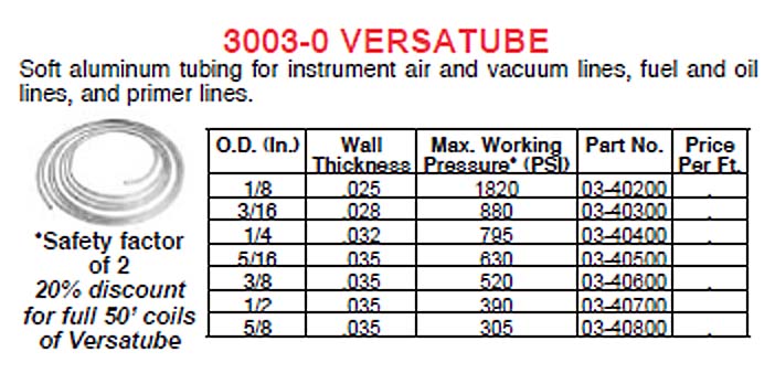

Dafydd Llewellyn Posted August 29, 2014 Posted August 29, 2014 Maybe there's a reason why Cessna etc don't use flexible fuel line where it's not necessary. The alternative is to get yourself a 37 degree flare tool and use aluminium tube, in accordance with FAA AC 43.13-1. You need to learn about AN hydraulic fittings; the aluminium (blue) ones are OK outside the engine fire zone. Inside the engine fire zone, use steel fittings (the JIC series are compatible with 37 degree flare, but they are not cheaper than the AN steel fittings, in my experience. For fuel containing alchohol, use stainless steel fittings in the fire zone). This option is much more labour-intensive, but you only need to do it once, and you won't be poisoned by the aromatics etc that leach through flexible lines. If you're getting fuel smells through your flexible lines, this means the plasticisers in the lines are being lost; the lines will become brittle. Flexible lines do not have an indefinite life. Use them only where relative motion exists, e.g. between the engine and the firewall. 1 1
Downunder Posted August 29, 2014 Posted August 29, 2014 Maybe there's a reason why Cessna etc don't use flexible fuel line where it's not necessary. The alternative is to get yourself a 37 degree flare tool and use aluminium tube, in accordance with FAA AC 43.13-1. You need to learn about AN hydraulic fittings; the aluminium (blue) ones are OK outside the engine fire zone. Inside the engine fire zone, use steel fittings (the JIC series are compatible with 37 degree flare, but they are not cheaper than the AN steel fittings, in my experience. For fuel containing alchohol, use stainless steel fittings in the fire zone). This option is much more labour-intensive, but you only need to do it once, and you won't be poisoned by the aromatics etc that leach through flexible lines. If you're getting fuel smells through your flexible lines, this means the plasticisers in the lines are being lost; the lines will become brittle. Flexible lines do not have an indefinite life. Use them only where relative motion exists, e.g. between the engine and the firewall. Would love to..... I have the knowledge and ability but it's a "24"...... 1 1

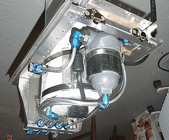

Dafydd Llewellyn Posted August 29, 2014 Posted August 29, 2014 Yes - well, that's one of the ways manufacturers make those aircraft "affordable". Here's the collector tank for the Blanik engine conversion: 1
