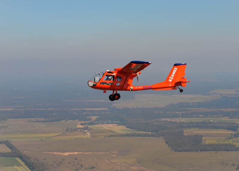

djpacro Posted November 1, 2013 Posted November 1, 2013 Just adding a note about the Husky "moose stall" in that particular configuration - in a turn flying through its own wake the tailplane can stall resulting in a violent nose down pitch. Exciting at high altitude. I have flown the Optica quite a bit so have followed the Seeker development with some interest and I keep in contact with young Mick H.

Dafydd Llewellyn Posted November 1, 2013 Posted November 1, 2013 That would be a most interesting comparison. I've never been within touching distance of an Optica; however I've studied it, and it always struck me as being a piece of excessive cleverness for its job. The Seeker is a far simpler concept, and I suspect, far less costly to maintain (tho it's not the epitome of easy maintenance by any means). The airflow kit that gives the Seeker its remarkable handling was not evolved during Mick's time there; it radically transformed the stall handling. I've never experienced the sort of tailplane stall you mention - but the Seeker has VGs under its tailplane; it's not elevator-limited in the normal sense; you can get the wing centre section to stall at any CG in the permissible range; but the effect of that amount of stalling prevents the elevator from driving it any deeper into the stall. So under the circumstances you describe, the tailplane is probably a considerable way from stalling. Say "Gudday" to Mick for me, please.
