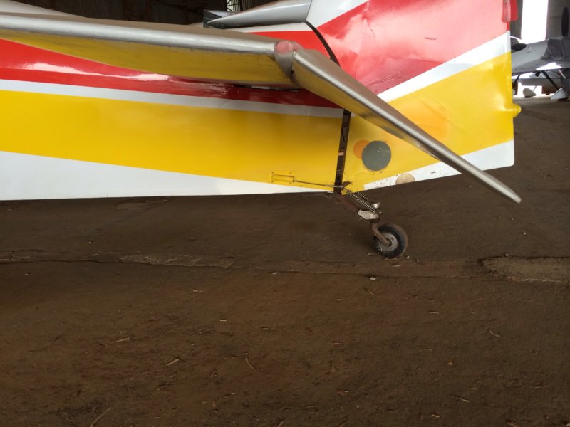

djpacro Posted November 8, 2013 Posted November 8, 2013 This Jodel tail configuration suggests strong adverse interference of the elevator on rudder effectiveness if the stick is moved forward during a fully developed spin.
Dafydd Llewellyn Posted November 8, 2013 Posted November 8, 2013 [ATTACH]25167[/ATTACH] This Jodel tail configuration suggests strong adverse interference of the elevator on rudder effectiveness if the stick is moved forward during a fully developed spin. Sure does. This is, of course, why the standard spin recovery procedure is: Full opposite rudder, centralise aileron, PAUSE; EASE the stick forward. The pause is to let the rudder do what it can, before the downgoing elevators blanket it. The problem with that is, that as the elevators start to pitch the thing nose-down from a flattish spin, the rate of rotation tends to increase, (same principle as a twirling ice-skater pulling her arms in), and that increases the centrifugal flattening couple on the fuselage, so the whole business may end in stalemate. That's the main reason why there are aircraft that will not recover from a fully-developed spin. The Chipmunk demonstrates the increase in the rate of rotation, which certainly slows the recovery, but the balance of the various effects is just sufficiently favourable that they will (eventually) recover if you keep the stick hard forward. One of the "remedies" for a marginally-blanketted vertical tail, is "strakes" running forward from the tailplane roots (like dorsal fins, only on the tailplane instead of - or as well as - on the fin. When you see that sort of thing on an aeroplane, you know it had spin recovery problems - or at least, that the designer anticipated them. The Piel Emeraude is an example.
facthunter Posted November 8, 2013 Posted November 8, 2013 Like plenty of others. ie Beech Staggerwing. Your shot shows the effect well and the recommended technique is not to use full forward stick (initially at least). Pilots should be aware of differing techniques for different Aircraft. Note this post got stuck and should have been before Dafydds. My computer has been dying... nev 1
