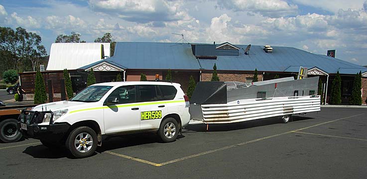

Guernsey Posted September 28, 2013 Posted September 28, 2013 Supa Pup 4 and Aeropup. Both folding wings. Alan.
winsor68 Posted September 28, 2013 Posted September 28, 2013 Unless you cant get, or cant afford hanger space, or absolutely need to trailer it, think again. Think about trailer rash, trailer damage from road bumps, vibration etc , the pain in the but about setup and preflight checks and then x that by 2 to be real..... We looked into it and it seems perfect until you investigate it and find out the reality.By all means if you need it then go for it, but please research it to death first. Those tiny little bolts and those big wings are not really designed for Australian roads and they are more designed to fit more aircraft in sheds or hangers. My family travelled thousands of kilometres towing sailplanes ... including plenty of dirt ... It can be done ... the Sailplane fraternity has been doing it for years... As previously pointed out ...the correct equipment makes all the difference.
