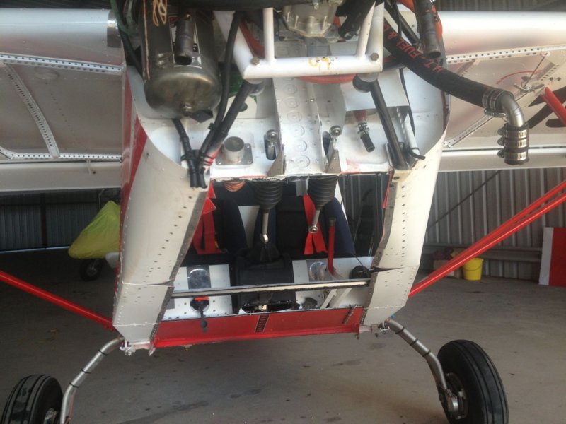

Kyle Communications Posted October 6, 2013 Posted October 6, 2013 Mick and myself were up at the hanagr today to get a few things done and out so I can get a exact list of parts. Once I was able to have a really good look at things the problem seems to be the nose wheel fork rippng off the nose leg strut seems to be the failure. You may remember I replaced the aluminium side brackets at the bottom of the firewall that supports the bottom nose leg bearing with stainless steel ones I made. This seems to have given a lot more strength to the base of the firewall and this bearing bracket. I believe this is why the fork ripped off as there is such minimal damage to the firewall. I have seen a few nose leg repairs on savannahs and always the firewalls have been bent badly at the bottom and need to be replaced. maybe the stronger bottom brackets I made helped this to have little damage. The only real damage was the crinkled floor which is now out. I am going to modify the pilots rudder pedals as well to be longer and reposition the toe brakes I will add this to my other blog when I do them 1 1 1

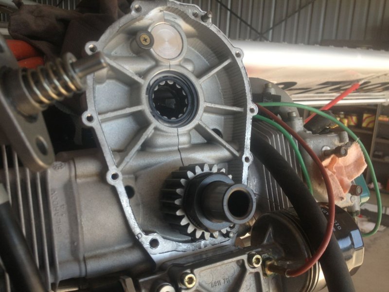

Kyle Communications Posted October 7, 2013 Posted October 7, 2013 I have just made the list of parts that I need today from ICP will get the pricing for the insurance company. The parts will come airfreight so really only a week or two wait on them. I would rather use new parts it will also make it easier to go back together being like a big mechano set anyway. The gearbox is out and going for inspection the engine remains in the aircraft it will have the deflection test done which is quite easy to do this will prove the crankshaft it isn't mandatory to do this if your gearbox has the clutch in it like mine does but for peace of mind I am covering all bases. I have the pricing for all the seals and bearings for the gearbox and the price of the shaft if necessary but I don't this this will be necessary...I hope. Last price I need I will get tomorrow is the 72inch prop and spinner
Guest Maj Millard Posted October 7, 2013 Posted October 7, 2013 I recently put a 912 gearbox back together. The book calls for a 'black max' type sealant on the mating surface. I talked with Wal and ended up using Loctite 515 which is a good all rounder, and no sign of any oil leakage at all. You'll find the 515 easier to source than the black max and it's easier to use, and is often used in the industry.......................Cheers Ross
Kyle Communications Posted October 8, 2013 Posted October 8, 2013 I was speaking to Floods yesterday getting prices etc for the overhaul..they told me it was Loctite 5910 was the one for the gearbox 1
