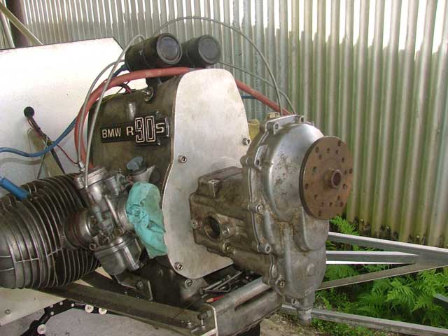

RickH Posted December 21, 2013 Posted December 21, 2013 I Have an R90S BMW which I converted to take a Rotax Gear box. R90 puts out 67HP at around 6200(from Memory) Somewhere else on this forum there are photos but I will try to upload Fresh one. The Gearbox I used for the setup was a n 'E' Type unfortunately had split front case. and so has never been mounted to the machine I had originally intented it for.(ended up finding a hirth engine at the right price). I set this up using the rubber donut from rotax but I believe there were issues with the vibes between the motor and the prop causing the engine cases to crack, those with whom I was able to get in contact recommended using a centrifugal clutch as it seems that the problem was caused by the engine and prop pulses at low RPM and I was assured that the clutch would solve the problem. BMW's were designed for high speed cruising and therefore no problem with maintaining continuous high RPM. I believe the clutch retails in the vacinity of around $1500.00 add another thousand for a decent electronic ignition and $1000.00 for new gearbox case and maybe another K or two for unseen expenses and it all starts to add up, not to mention the $1200.00 bucks for the CNC machining of the adaptor plates this does not include the time I put into the CAD drawings for the machining(prohibitive if you have to pay some one else for the CAD info)needless to say I never got further than the initial conversion as I managed to purchase an F30es Hirth with very low hours for a lot less than what I was still looking at outlaying. My advise would be to simply purchase a unit ready to go, no more headaches and most likely a warranty Having said this, included below is a photo af the engine and should anyone care to take on the completion of the project it could be yours for $2000.00. Engine has had full recon ie. Rings, bearings, gaskets, timing chain etc. RickH 1
