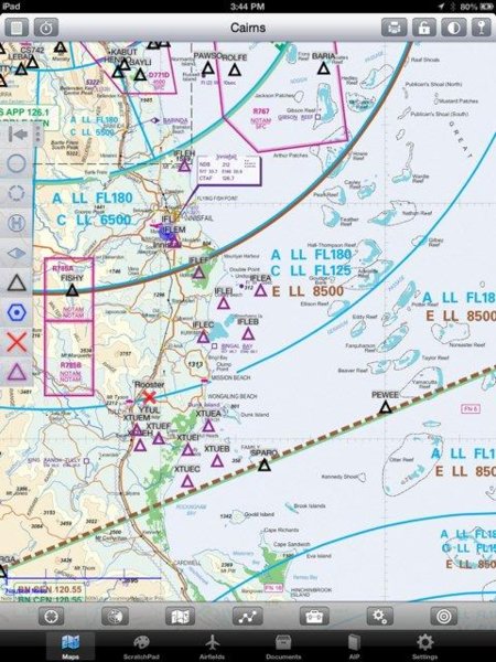

frank marriott Posted October 6, 2013 Posted October 6, 2013 Just a tip. If you are using ozrunways for your maps then you can turn on the IFR waypoints should you wish from the tab on the left side of screen.
Guest Maj Millard Posted October 6, 2013 Posted October 6, 2013 Frank that's all good , however why should I, flying VFR on a perfect VFR day (we can only be VFR anyway) have to work out some IFR approach, because some wanker decides he wants to play IFR, on a perfectly clear day ?... He's got eyes also, and we were never at anytime near, or crossing over any approach line into Innisfail. We were tracking parallel and well to the east of it. Had I not made my VFR position call (optional), he would not have even known we were anywhere in the area. It's CTAF airspace, and the onus is just as much on him to 'see and be seen' as it is on us , and all other VFR users. To his credit he was actually monitoring the VFR area frequency (126.7) as required. I have on occasions encountered other Chinooks in this same area who have not been on CTAF freq, and just boring along at 80 kts waiting to hit somebody !.. CTAF means ...'Common traffic advisory frequency'......and as I said in another post they are just as responsible in that airspace as we are to conduct a ' see and avoid ' watch...Additionally, there are both Ultralight and Parachute symbols at Innisfail airport , so it's even more important that they do so.........Maj...
