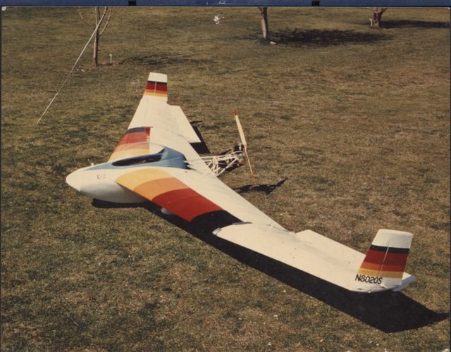

Guest ozzie Posted October 7, 2009 Posted October 7, 2009 the Mitchell U2 is a great design that flew on 10 hp in it's stock form.
Guest Maj Millard Posted October 8, 2009 Posted October 8, 2009 Yes, Chuck Yeager had a go at the U2, (and Mithell P38), during research he did for an article he did in Penthouse Mag, entitled 'The Light stuff '. He also flew a couple of other ULs of the day. He said he enjoyed it, and it reminded him of the days at Edwards experimenting with towed lifting body aircraft.
