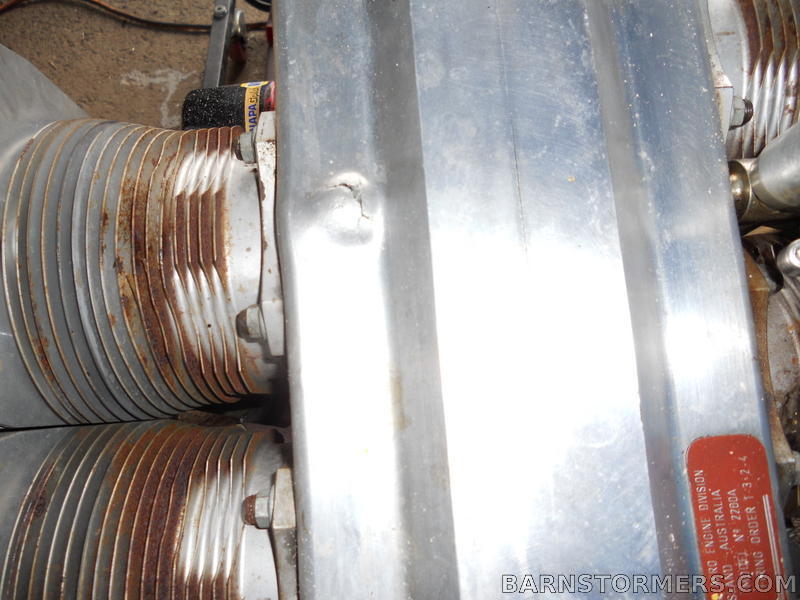

biggles5128 Posted January 21, 2013 Posted January 21, 2013 Tim's Tornado threw a rod @ 300 hours... FT, can I ask what brand of oil filter is being used on this jabiru engine??
fly_tornado Posted January 21, 2013 Posted January 21, 2013 engine is for sale on barnstormers if you are interested.
