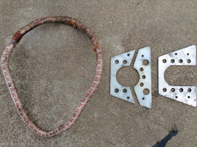

Next the annoying knock in the nose leg. After removing the muffler-can for access, I removed the leg completely to find that the lower nylon bush plates had worn badly, allowing the leg itself to contact the alum plates. The bungee also appeared due for renewal, and was also removed. It had become hard and not real flexible anymore. I couldn't find any cracks in the lower brackets after a good clean up, so they will go again.
These brackets on later model have probabily been beefed up, and I know Mark Kyle has made his of stainless which doesn't sound like a bad idea, as they do have quite a job to do. The leg itself had some minor scuffing, but is otherwise fine. Some of the rivets attaching the lower plate to the belly are loose, and I may drill them out and replace with -3 bolts, for a more secure attachment.
The red nylon buffers under the main landing gear leg are also gone, so they will be replaced also.

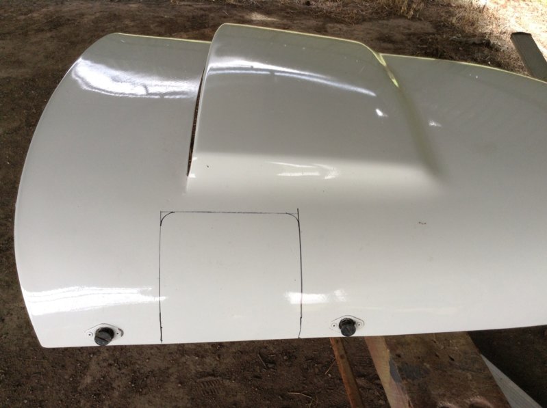

One thing I like about the Savannah is that most critical things are easily accessible, with few exceptions. I am also fitting an access hatch to the right side of the top cowl, so that the oil and coolant levels can be checked prior to flight, without the need to remove the top cowl every time.
So off to Reg Brost for some bits, and she'll be ready for the next 700 hours in true Savy style. Of course all this new stuff will have to be tested, so I may get to fly her again next week sometime.....Both myself and the owner flew her a couple of weeks ago, but he decided to ground her with the bad knock in the nose leg, which was probabily the right move.....My four favorite aircraft to fly : Lightwing, Storch, Savannah and Drifter .....I have been lucky enough to fly all four in the past two months !........Maj....012_thumb_up.gif.cb3bc51429685855e5e23c55d661406e.gif

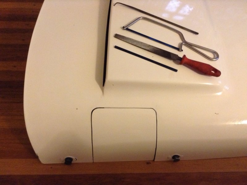

Some I use a jigsaw on ( variable speed one) but I 'll probabily use a small saw on this one, or maybe even a hacksaw blade. I'll post some photos when I do it ok............Maj....
interesting post, my savannah is 30 hrs off its 1000 hrly, i already have a pile of parts the replace and upgrade, didnt think of the nylon plates, and thanks for reminding me to order a new bungee for the nose gear. fortunately the red nylon buffers on the main gear are still there, though they have moved around a bit, one is in its original position, the other is in the centre.

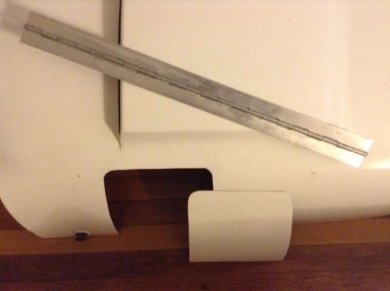

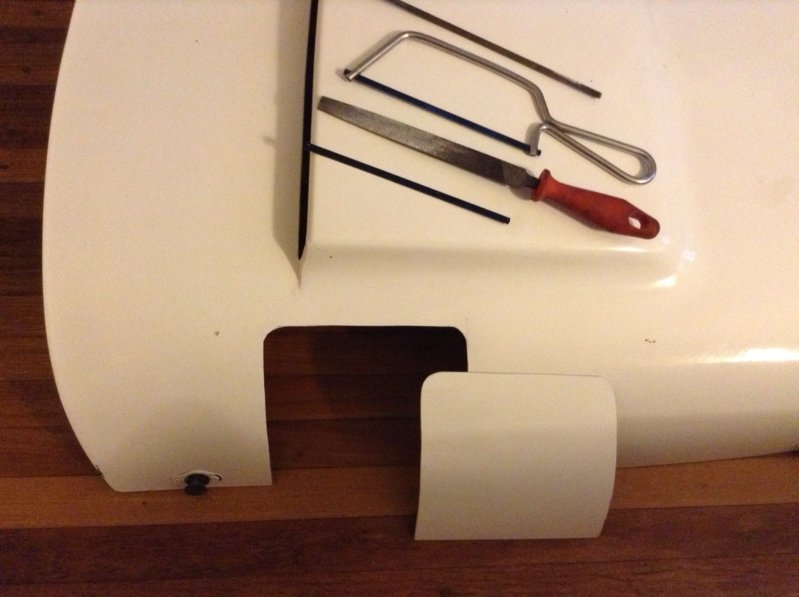

Stage 2 on the cowl inspection flap............the upper line and the two rounded curves were cut by hand with a new small blade. By leaning the blade over on the corners you can get a nice corner curve. A jigsaw with a fine blade would work also for those who don't want to do it by hand. All tools used shown.......the hatch has been cut out in the second photo...

Found the same. the nose-leg nylon plates, bungee, and other minor wear and tear items.

I just ordered a bunch of parts for mine coming up to 600 hrs in 2 years and the new bungy was top of the list, there is a factory approved mod for the nose leg bracket doubler and mine was LAME fitted at around 260 hrs, with nearly 1700 landings all is good. Other than working rivets and the control hinges and bushes which wear she is going great guns. A solid investment and great all round performer.
