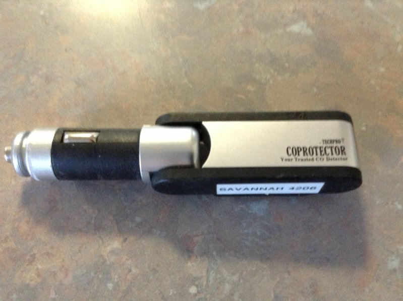

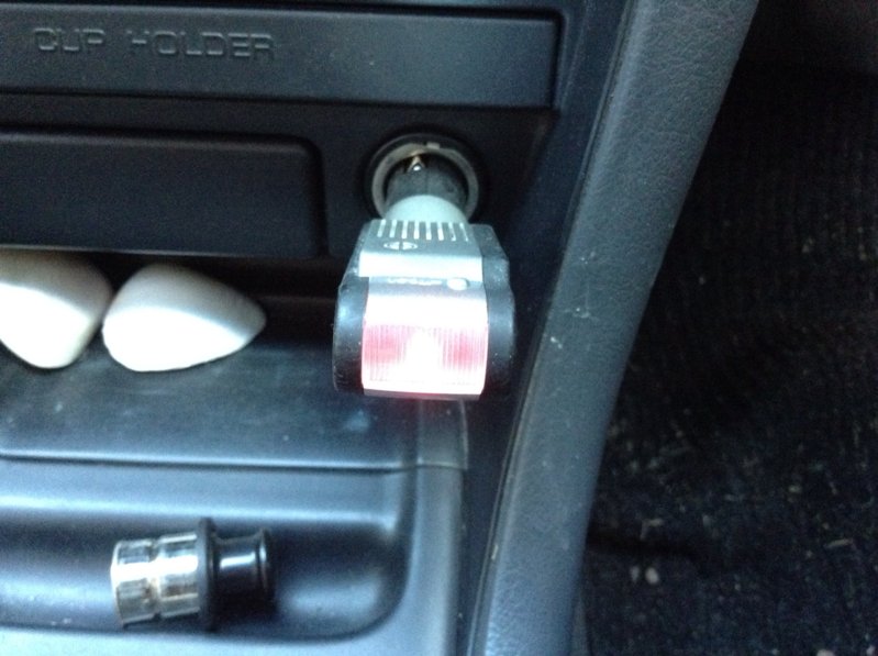

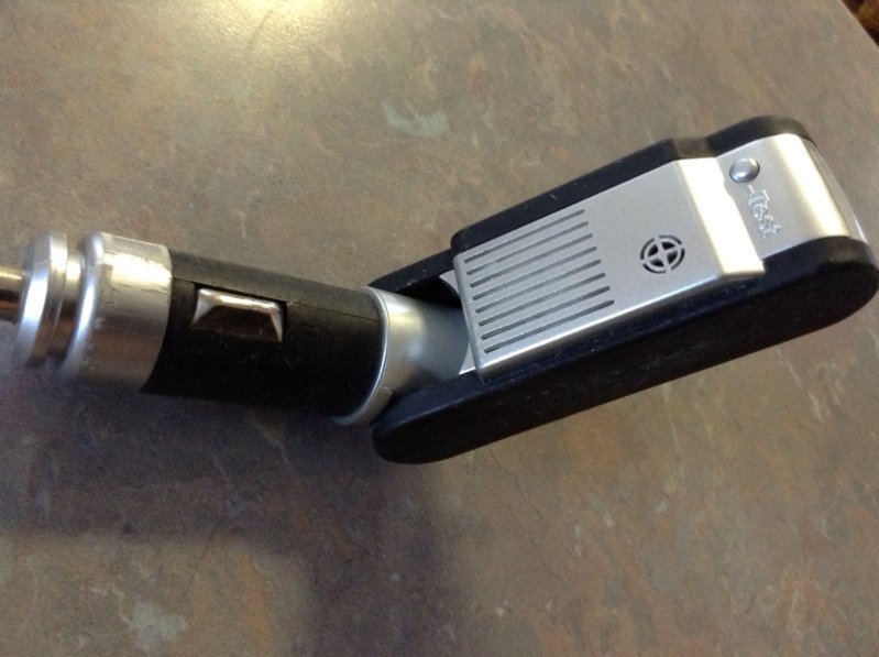

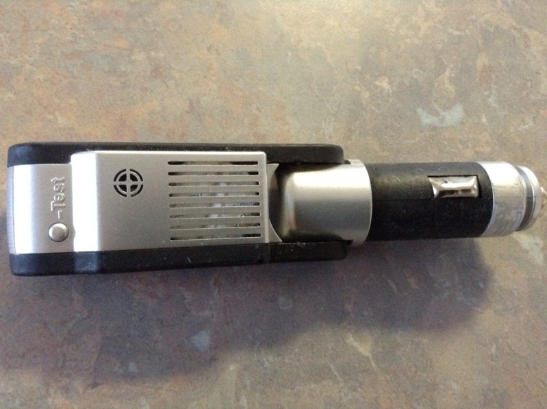

Guest Maj Millard Posted November 30, 2013 Posted November 30, 2013 A friends aircraft has a very neat little Carbon monoxide detector plugged into the power socket. It is one of the nicest little units I have come across, and I would like to find a supplier. When plugged in a green light is aluminated, and a red light blinks if Carbon monoxide is detected. If only a small amount the red light blinks slowly, if a lot it blinks rapidly. It also has a push to test button. Have googled the brand name but nothing came up.......any help appreciated..........Maj.....
Head in the clouds Posted November 30, 2013 Posted November 30, 2013 Punch this into your search bar and you'll find lots of references - HIH. https://www.google.com.au/search?q=techpro+co+protector&oq=techpro+co+protector&aqs=chrome..69i57.9000j0j4&sourceid=chrome&espv=210&es_sm=122&ie=UTF-8#es_sm=122&espv=210&q=techpro+co+detector
M61A1 Posted November 30, 2013 Posted November 30, 2013 http://www.prnewswire.com/news-releases/techpro-electronics-launches-coprotectortm---the-worlds-1st-electrochemical-carbon-monoxide-detector-specially-designed-for-use-in-cars-57109587.html
Guest Andys@coffs Posted November 30, 2013 Posted November 30, 2013 BTW important to note.....These electronic CO detectors have a limited lifetime sensor, in general they are only good for 5years then ned to be replaced. The better quality ones also have a LED 2 or 3 digit display that show the measured PPM which can be enough to give you confidence that it is working where as a non flashing LED tells me it either hasn't found anything...or it isn't working..... There is a manufacturer of these in the states that from memory are in the big spruce catalogues, where given the 5yr limitation on the sensor they have a trade in offer for a replacement device and the cost of that isn't the same as buying a new one.....but freight from AU may well make up the difference.... What ever you use it needs to have a good visual alarm...a beeping piezo alarm in a cockpit with the hp generator at TO revs will struggle to be heard. A really bright flashing LED that is focused via a moveable neck to hit you right in the eye will do it Andy
rankamateur Posted November 30, 2013 Posted November 30, 2013 They were released in Jan 2009 so now have 2 months to run before replacement. wonder does the five years count on the shelf or only in use? If business has been slow, new ones might soon be expired.
