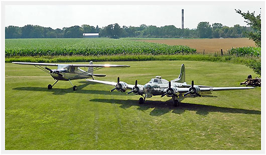

I wouldn't mind making a B29 either. Unfortunately, most of the other multi-engine bombers wouldn't scale, according to the guy who built the B17. I think it had something to do with the cockpit space of the scaled airplane requiring noticeable alteration to the lines of the plane.

The B-17 has a large rudder which would help control it. Lot of work for one person. Be an interesting Rotec radial project, but end up fairly heavy. Perhaps a scale Avro Anson. It had fixed pitch props Nev

Nev ,the B17 rudder is big, was it a joint effort to keep it straight ,or hydraulics, I'm amazed when you see the condition some of them limped home in, it would've been a handful in good nick, loosing a heap of systems and flight controls would've been unbelievably hard work!
I'd say it was for directional control authority on take off . Vmc (g) and Vmc(a). A lot of military aircraft used to lift off before achieving the figures (which is somewhat hazardous). In the air, at a reasonable flying speed, you could compensate by flying one wing down if the rudder was not fully operative and an engine out (hopefully feathered) Nev
