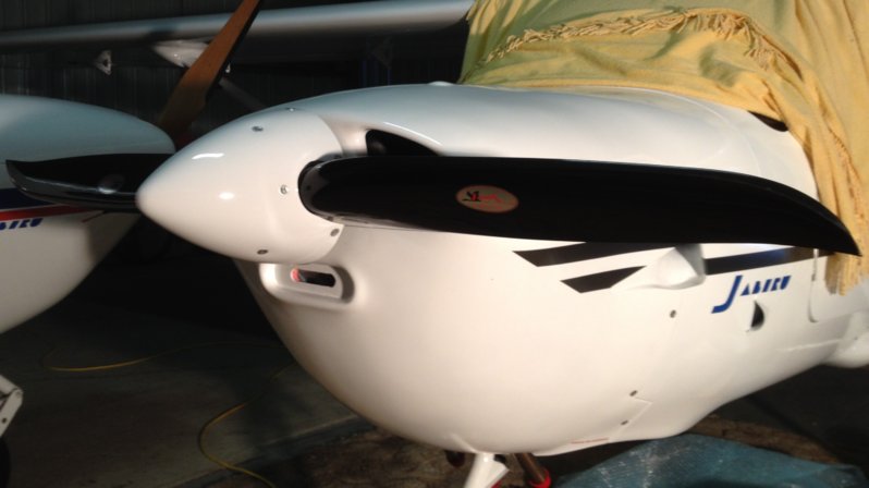

Just fitted my new Jabiru Scimitar prop (60 x 38). I had to slightly modify the spinner and backing plate to work with my cowls. All we need now is some decent weather for a test run.
Laurie.
11344307_Scimitarpropandspinnerfitted18-09-02014.jpg.7812da4cf47e8e2d5af7ffd44ccd9bab.jpg
