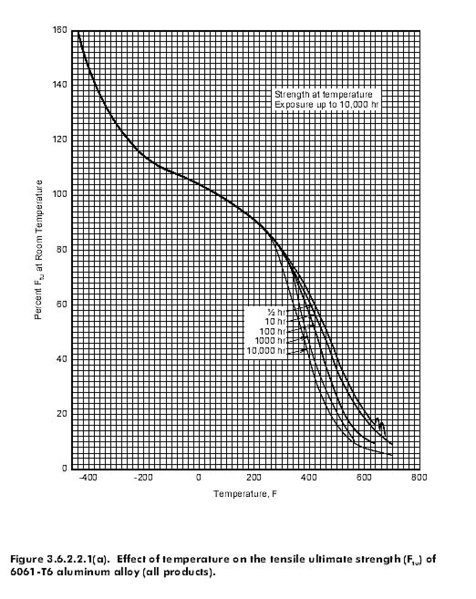

turboplanner Posted December 24, 2013 Posted December 24, 2013 To my knowledge we have never publicly seen a metallurgical report on a failed through bolt and associated area. Several of us have attempted over the years to try to come up with a solution, but without this basic information there's no starting point. FH, I can't see where 230 degrees would take you when the chamber temperature could be anywhere from 1500 to 3000 degrees and the piston to cylinder wall performance from what I've read from owners seems to be good. The exhaust valve issues also seem to have a separate cause which some people have put forward theories on, but that issue to me would seem to be relatively easily solved. To me, it just needs a logical step by step analysis first, then some action after rather than any radical change.
facthunter Posted December 24, 2013 Posted December 24, 2013 The 230 degrees C is an operating limit on the high side but affecting the material strength so it's worthwhile to run at that temp or higher in a test. The combustion effects are practical too as it's a possible situation to be encountered. These are only sample suggestions, but I hope you get the drift. Be nice to measure piston temps too because I've seen plenty of gudgeon pins coloured blue. as well as sections of the bores. Nev 2
Dafydd Llewellyn Posted December 24, 2013 Posted December 24, 2013 Well if you can manage to run it for 5-6 hours in a work day 5 days a week its going to be a lot of months before you have some good reliability numbers. Basically 100 hours per month or so. So what numbers are you wanting to see before you buy and on how many engines do you want to see it done on? Personally i would want to see 500 plus hours on several engines to establish some good credibility. And perhaps 1000+ on one engine. And if i was running the show and had the cash, i would want to do that before i sold any. Its easier to fix things in house then once they are all over the place or after you injure someone. Yairrsss . . .that would be nice, IF one had the money. Let's see, now: CS-VLA calls for an endurance run of 50 hours, in 25 2-hour segments. Each of those segments has one hour of cold start, idle, full power, etc, and one hour at full throttle at maximum temperatures of CHT, oil, etc. This is quite separate from the various tests that must be performed for detonation, vibration, crankshaft torsional resonance, backfire testing, etc. All this has to be done with a "representative propeller" - you can't simply shove it on a Dyno. For certification, CASA has to be present for all of this. For a 128 HP engine, that's going to consume around about 1000 litres of fuel, plus about 150 man-hours, plus 500 around KwH of mains power to run cooling fans, etc. - say $20,000 in direct costs, taking into accound transporting the fuel, etc. Then there's the cost of the test engine, which has to be fully "conformed" prior to the test run. It also has to be fitted up with thermocouples in all sorts of places. There's another $25K or so. Then there's the cost of the test cell itself. Care to estimate what that costs? Workplace health & safety? Noise? And the engine has to be put through a power rating run before and after, because one of the aims is to show that 50 hours of torture at maximum everything, has merely run the engine in a bit - it should be producing more power at the end of the run than at the start of it. That means the test cell must be capable of running the engine at standard sea-level conditions Once the final rating check is completed, the engine has to be stripped and inspected, also under CASA's surveillance. CASA charges around $180/hour currently. You're looking at at least $ 100K to do just this much, and that's only if it all works perfectly the first time. You are asking for a procedure which - apart from the endurance run being increased to 150 hours - is appropriate for an engine to be used for carrying paying passengers in scheduled airline use. You want ten times this? AND you want an affordable engine? BTW, test-cell running does not normally expose the crankshaft to propeller gyroscopic couples, or inclined airflow. The best way to include those effects is to put it in an aeroplane and fly it. 1
Yenn Posted December 24, 2013 Posted December 24, 2013 That 230 deg is nowhwere near the combustion temperature, but it is the average heat of the cylinder head. there are several reasons why the head is lower in temp than combustion, such as the fact that combustion only lasts less than a quarter of the cycle and also incoming air and fuel are acting as coolant as well as the cooling airflow over the fins. From memory to get an aero engine certified such as a Lycoming it has a test regime to follow, which includes some run time with no oil. I can't remember the exact requirements, but they are probably on the FAA web site. 1 1
