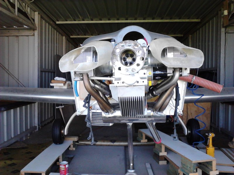

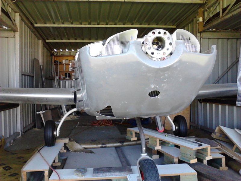

kgwilson Posted December 27, 2013 Posted December 27, 2013 Jabiru changed from the small 'Repco-type' oil cooler to a five-row (from memory) Stewart-Warner type (and also changed from the finned-sump, that was not successful as an aid to oil cooling) a fair time ago. I think that happened with the introduction of the J160. Not on the 3300. Mine is the new model with roller followers etc & the sump is finned. See attached pics. I also have a 7 row Positech cooler with a separate airflow via a NACA duct in the lower cowl so if I have any problem with oil temp being too low I can restrict the airflow easily by installing a butterfly valve. There is a 250mm sealed tunnel from the back of the duct to the cooler. I spent a fair bit of time reading various documents on cooling air cooled piston engines starting with the 1981 NASA report 3405, some EAA articles etc & found the information very valuable. Getting the airflow right is one of the most important aspects of maximising the life of your engine. The big cooler & long oil lines from the engine will probably add around 1/2 litre to the total oil capacity. 1
Oscar Posted December 27, 2013 Posted December 27, 2013 Not on the 3300. Mine is the new model with roller followers etc & the sump is finned. See attached pics. I also have a 7 row Positech cooler with a separate airflow via a NACA duct in the lower cowl so if I have any problem with oil temp being too low I can restrict the airflow easily by installing a butterfly valve. There is a 250mm sealed tunnel from the back of the duct to the cooler. I spent a fair bit of time reading various documents on cooling air cooled piston engines starting with the 1981 NASA report 3405, some EAA articles etc & found the information very valuable. Getting the airflow right is one of the most important aspects of maximising the life of your engine. The big cooler & long oil lines from the engine will probably add around 1/2 litre to the total oil capacity. My apologies - I haven't spent much time looking at 3300's! Strange that Jabiru has retained the finned sump, maybe just hasn't re-done the casting (the presence of fins is in no way a problem, it just does sod-all for cooling the oil..) That Positech should do the job a treat.. and by not having introduced high(ish) pressure air into the lower part of the cowl from the oil-cooler air dump side, you're certainly doing your heads and barrels cooling the best possible favour. That's a very nice looking install - we're trying to clean up the one in our ST1 but I don't think we could get it half as neat. P.S. you might find it interesting to talk to CAMit about their oil take-off adaptor - could suit you rather well!
