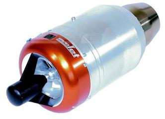

And to counter the loss of power when starting why not mount two rc jet engines?
http://www.evojet.us/
Can get 23-51lbs/104-220Nm thrust per engine. one on each side mounted on wheel spring, weighs 1-2kg each.taz.gif.c750d78125a77f219b0619b1f23e3e90.gif

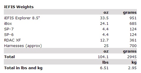

Dont know yet but it seems reasonable if you look down below, i have those 3,57 kg + a 10,4" screen(~1,2kg). ~5kg.
two 1,3KG autpilots but they go in after the weighin.

Haha, forget it =)Dont know yet but it seems reasonable if you look down below, i have those 3,57 kg + a 10,4" screen(~1,2kg). ~5kg.
From MGL homepage.
[ATTACH=full]27791[/ATTACH]
V6 radio 230g
Transponder Garrecht (VT-01UltraCompact) 0,57kg
3,75kg, is that less?
Without knowing the actual weight of the 'steam' gauges, I wouldn't know exactly. But, on a hunch I would say that you would have saved at least 3 kg.

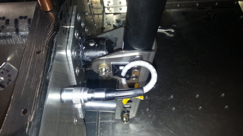

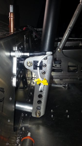

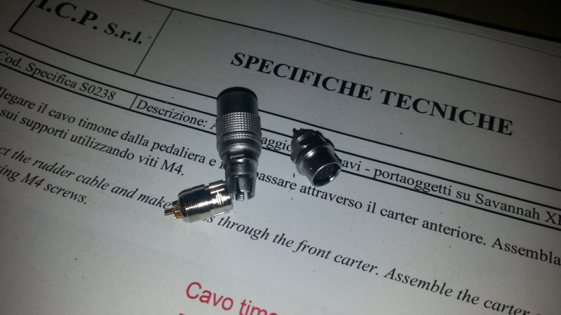

So i got my connector from my ray allen handle installed, really neat.

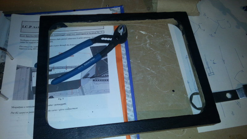

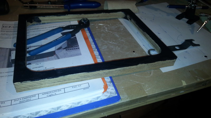

And i tried installing the wooden frame for the chute, but icp sent sunken screws to fasten it with and i cant flush the holes this late in the build, thus making the screws stick up awkward so i have to get ordinary flat screws.

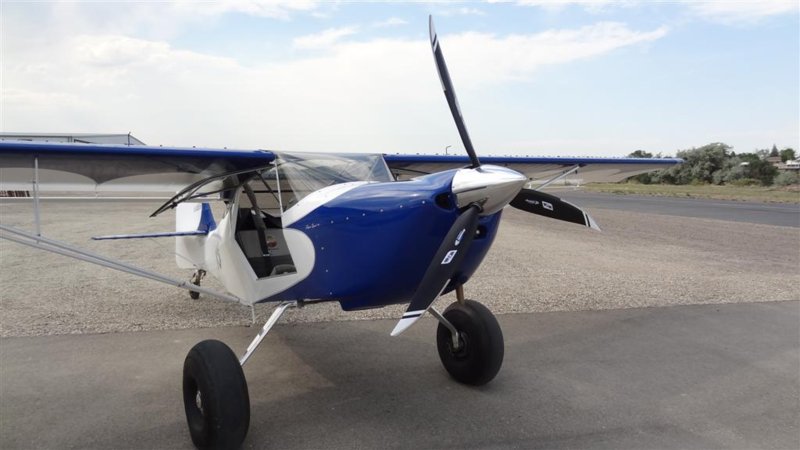

Nah stuff the polishing...I painted mine this time....stops the ugly looking marks the bare alu gets...if you polish it you will be making a rod for your back dude
  Quote
But look at the one on the Kitfox!
