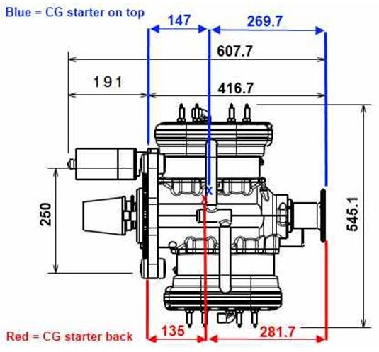

The engine is really tiny. 416mm from mount to top of prop shaft...

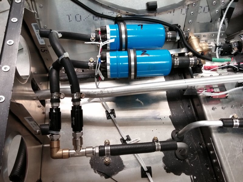

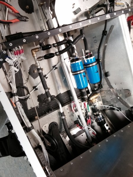

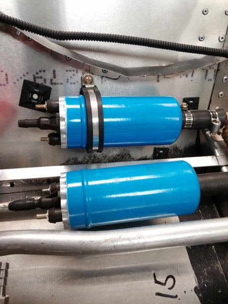

Today i got fuel pumps installed, dual pumps with flow valves.

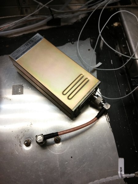

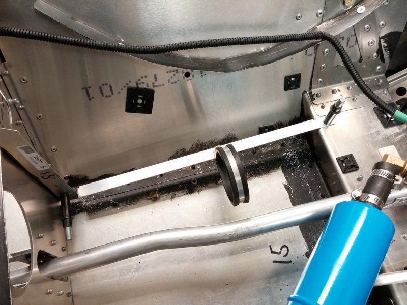

Also tested where to put my transponder.

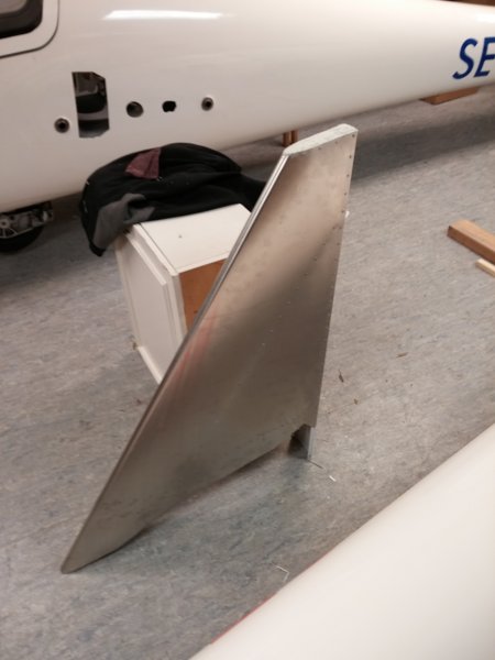

And remade the fin that i destroyed earlier.

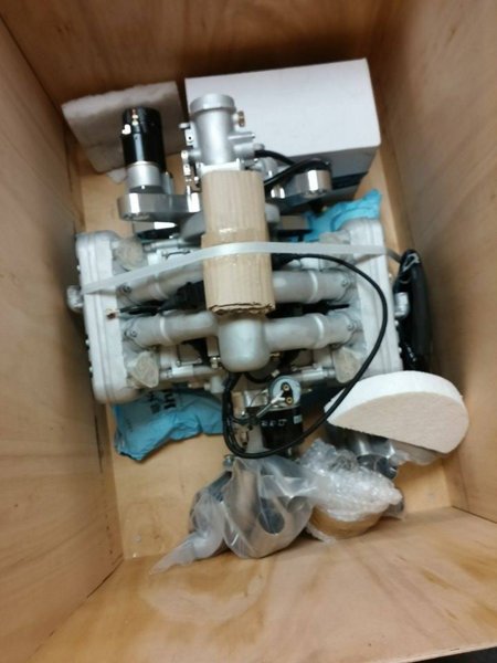

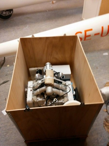

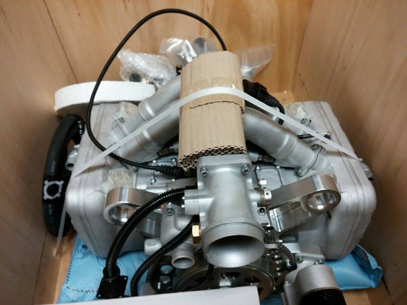

On Monday i will get the engine, Alain from D-motor called me up Friday from Belgium to check if i got engine, thats nice..

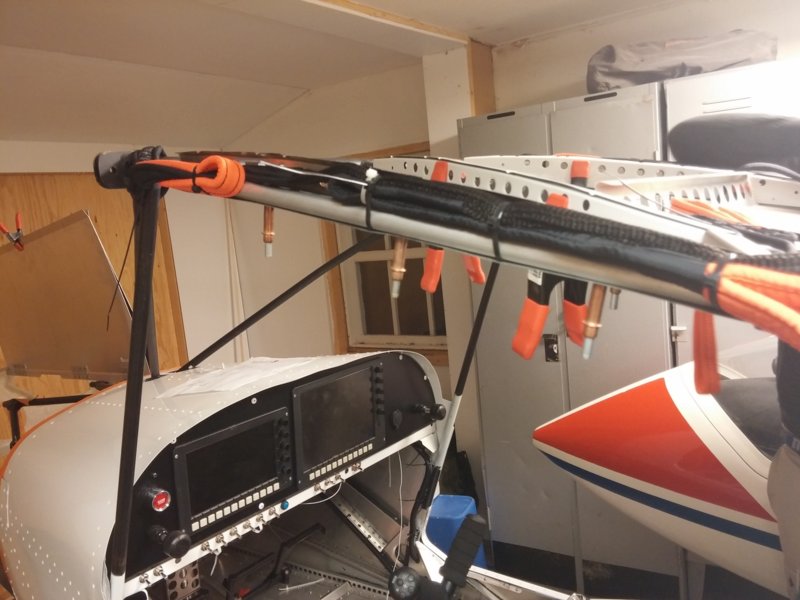

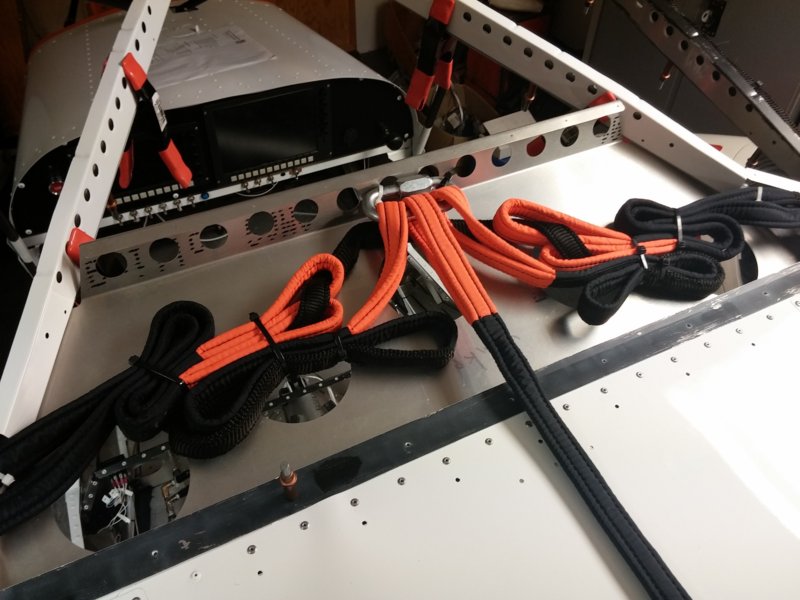

So i got the Cockpit done, with parachute bridles it was allot of work.

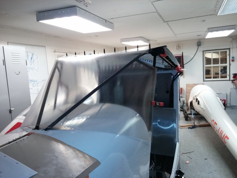

Also Got the windows on, they are tinted, front windows uses 3M Crystaline 90, and top window uses lightest tint.

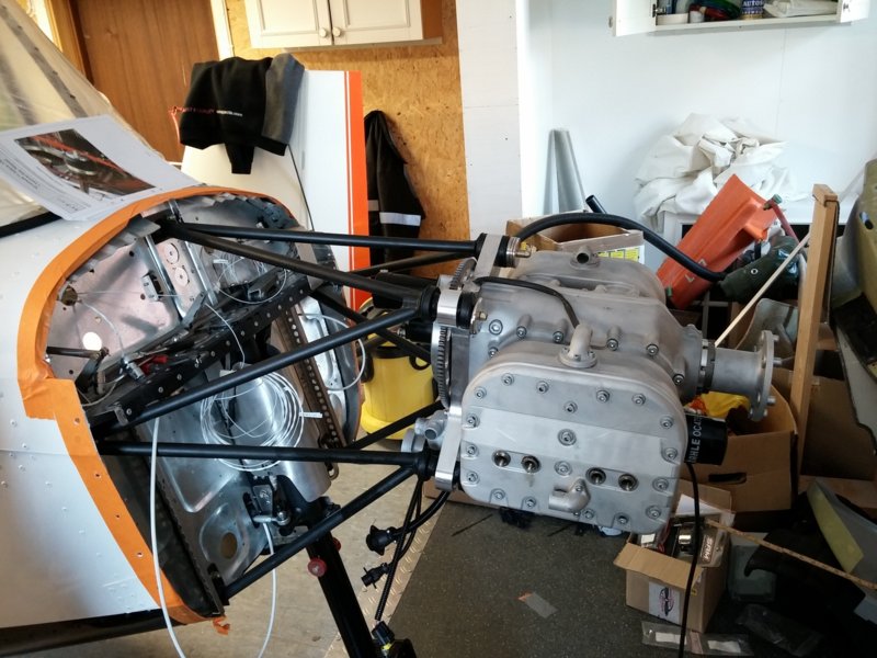

Also tested the Engine on the mount.

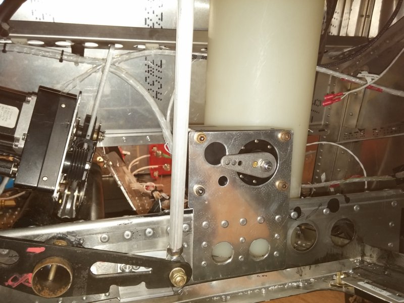

Also the Autopilot got moved, this time i put it were ICP wants it, found installation instructions from ICP South Africa.

I had to shorten the mount a bit, the jabiru bushing was larger, great tool this.
So i got the Engine up and it looks lovely.
Thing was that i needed the prop shaft to extend out of cowling, either change the shaft(allot of work) or shorten the Cowling(also allot of work), i went for shorting the cowl, wish i hadt now the hood doesnt fit 036_faint.gif.544c913aae3989c0f13fd9d3b82e4e2c.gif, just another issue to solve.
But at last it stands on its own legs.
So ive shortened the Cowl about 5cm and aligned it, so much work....
