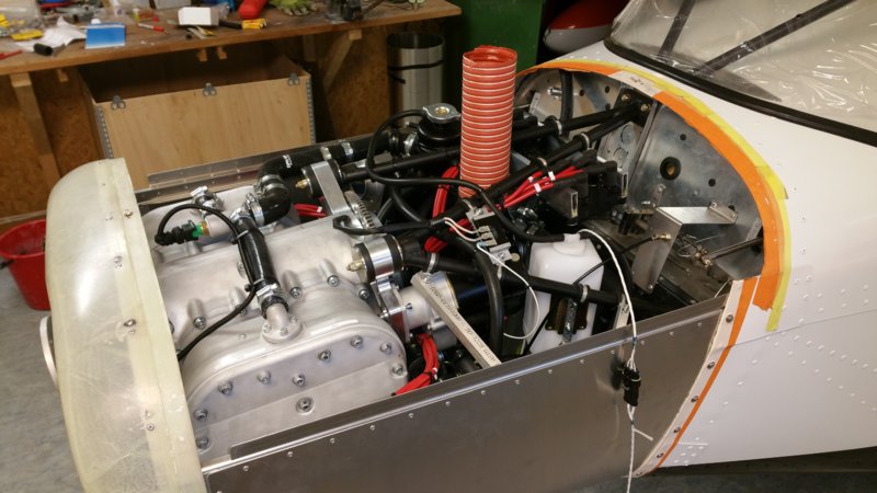

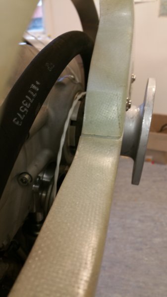

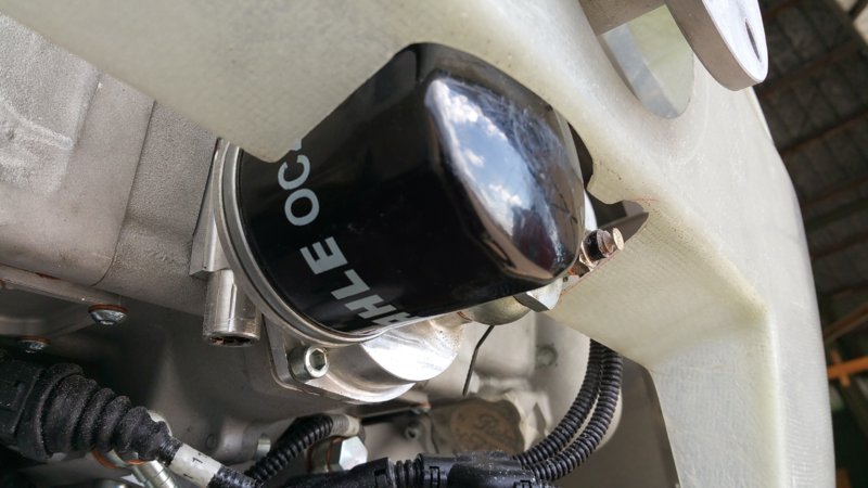

Had to make a cut-out for the oil filter, i kinda regret now that i didn't just buy a prop extender, but i walked this road when i shortened the cowl.

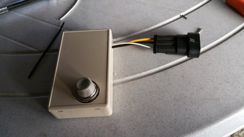

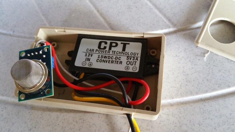

I Finished my Carbon monoxide sensor =), ill just connect it to my Efis and it will warn me on screen if its active, lets hope i never need to find out if it works.

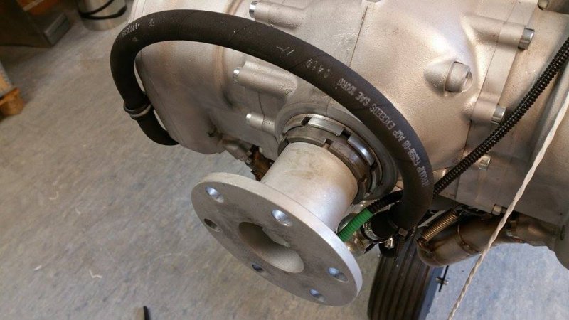

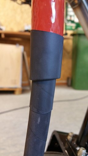

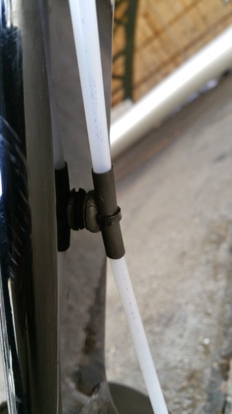

Also putted some shrink tube over the brake lines.

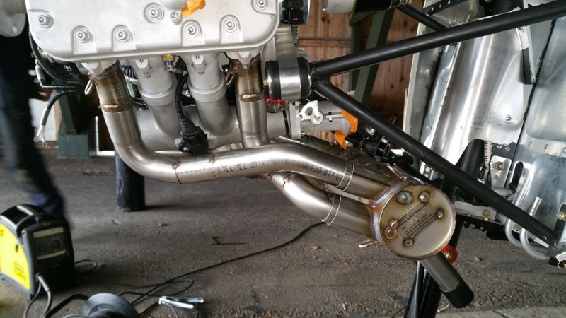

On Monday there's a guy commin to tack weld my exhaust, i also ordered a new hood from icp, i got a kink on it, stupid hood should come pre rolled from factory.
Ever wonder if engine manufacturers thinks twice? so tight i even had to turn the screw facing other way and i still think its to tight.

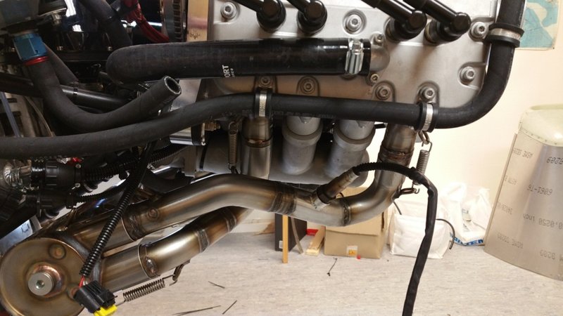

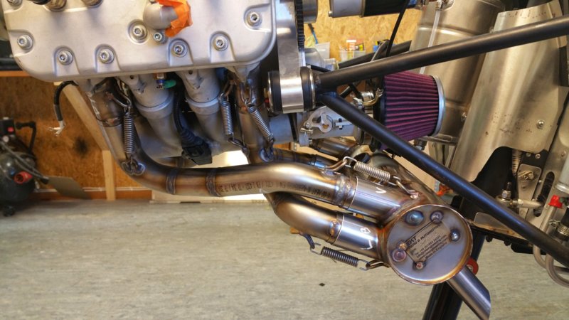

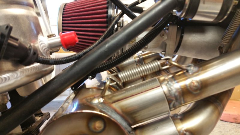

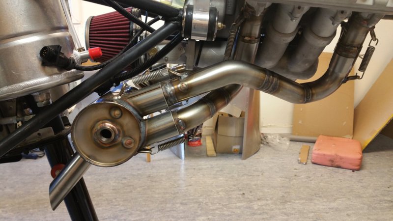

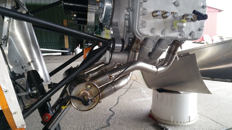

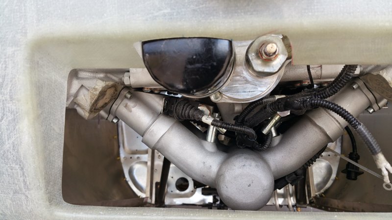

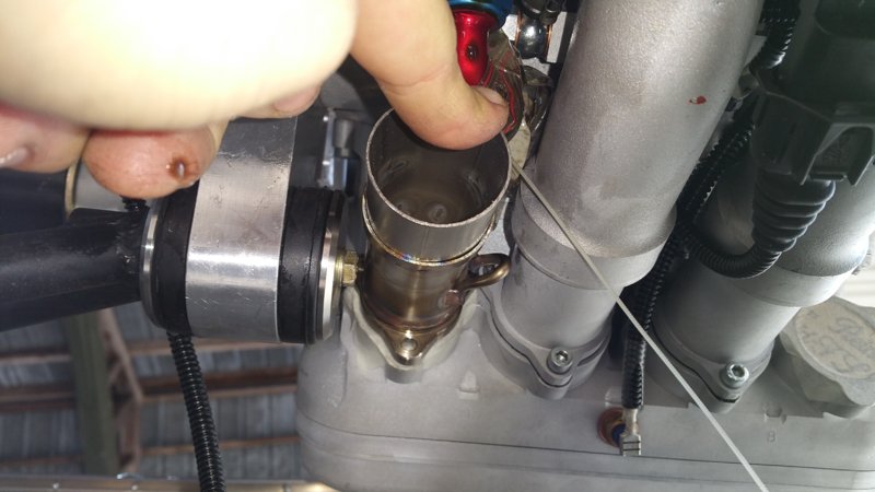

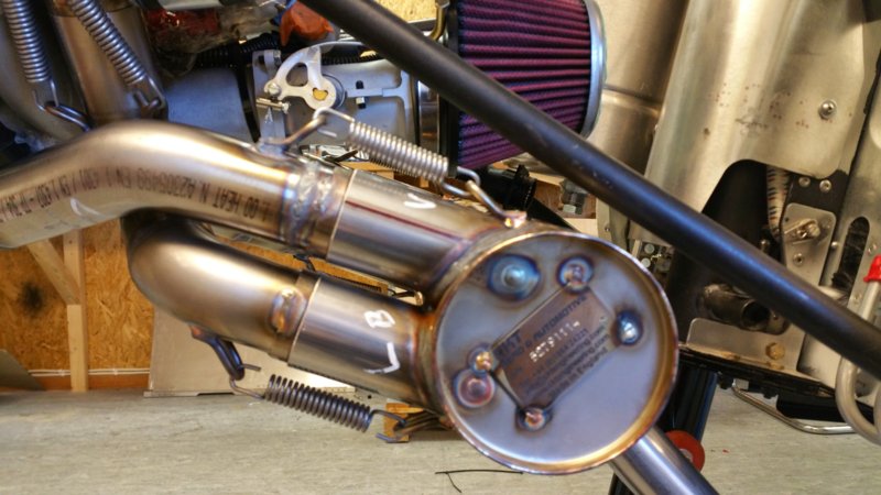

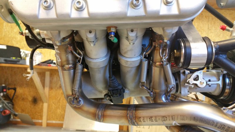

Did the exhaust today, just tacked it so a real welder can do the fine work later.

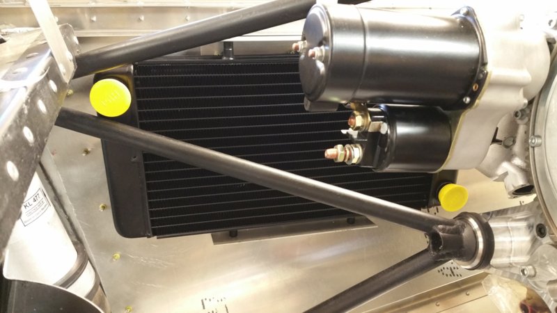

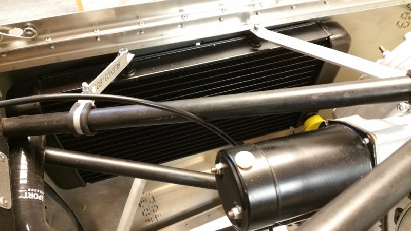

Now where do i put the radiator?????
Just another day in paradise =)
Added the front fin.
The oil can got there.

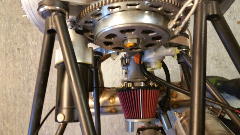

And adapted the Coolergrill to fit around the oil filter, ppretty happy with it considering i dont have any special machines.

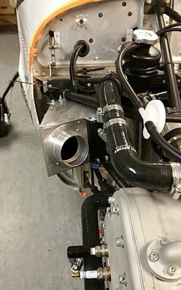

The radiator is big like hell and i solved it by ducting the air from the front to the sides.

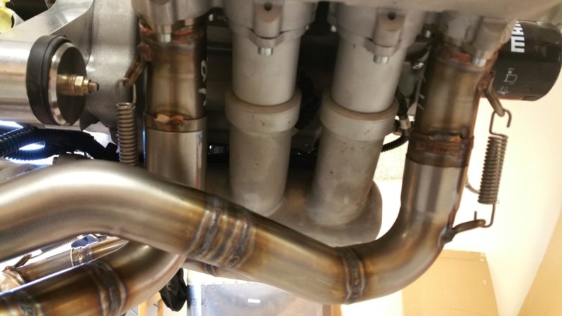

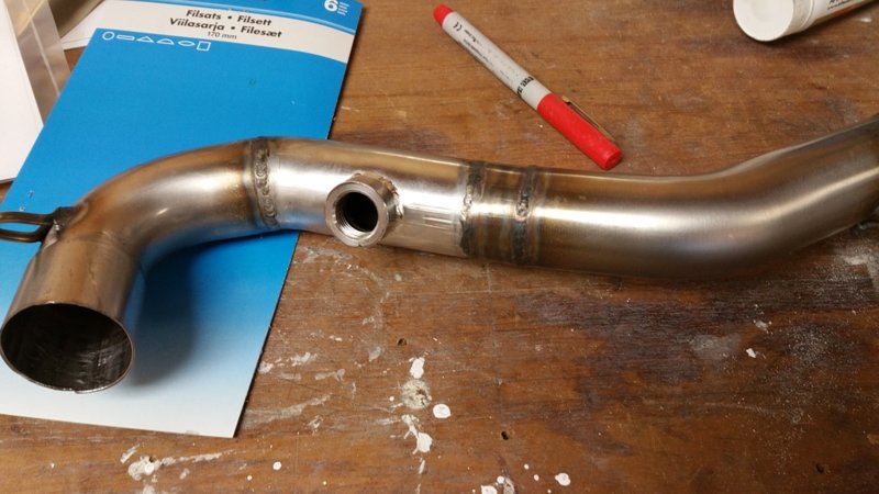

So i got a licensed guy to weld my system, was NOT cheap, he needs to pay his weldinglicense, just one of those hidden costs when buying a engine without a finished exhaust.
I had to pay $1000 AUD to get the stamp so the inspector can see it in the logbook later on.
Anyway it looks good.

Holy crap...1000 bucks for a sign offdaylight robbery
It seems he didnt use any backing gas, had a angry call with him, i got free repairs 4ever, annoyed but still its just an exhaust, just oil and sot.
Been having inspections since my old inspector died, redoing all aint fun.

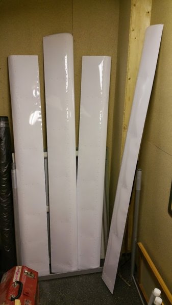

Sanded a few parts and left at the painter.

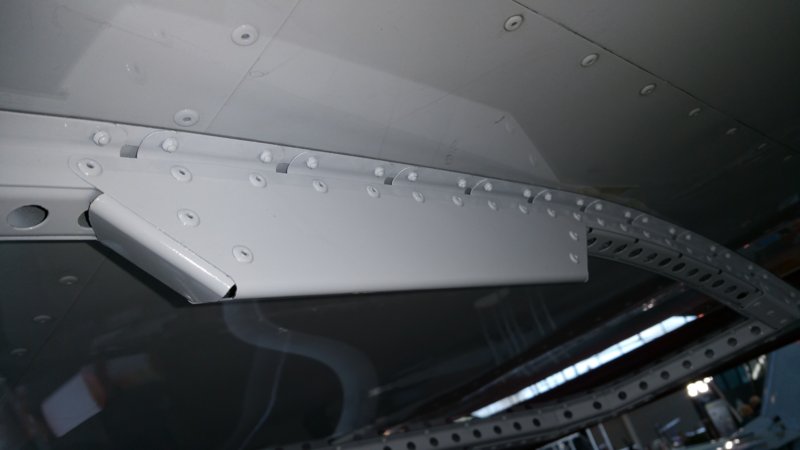

Decided to remake the leading edges of the wings, they got a ugly dent.

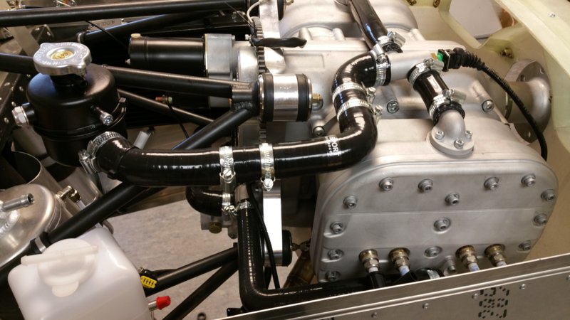

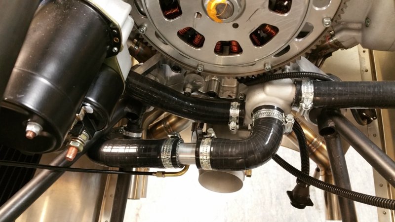

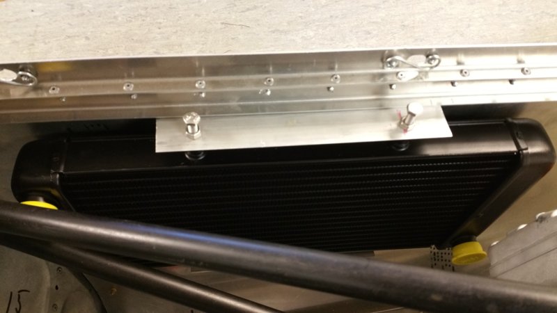

I moved the Radiator to sit on the engine mount and installed some silicone hoses.

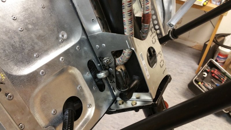

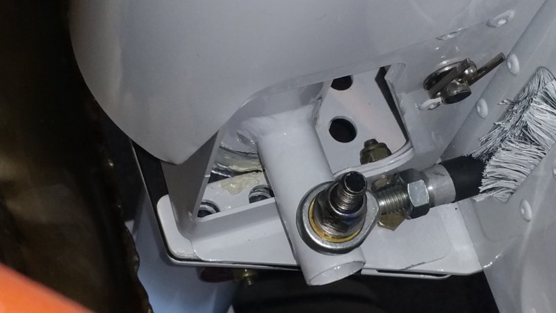

Better nosewheel support

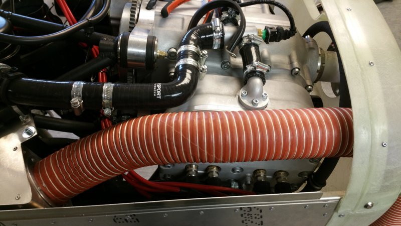

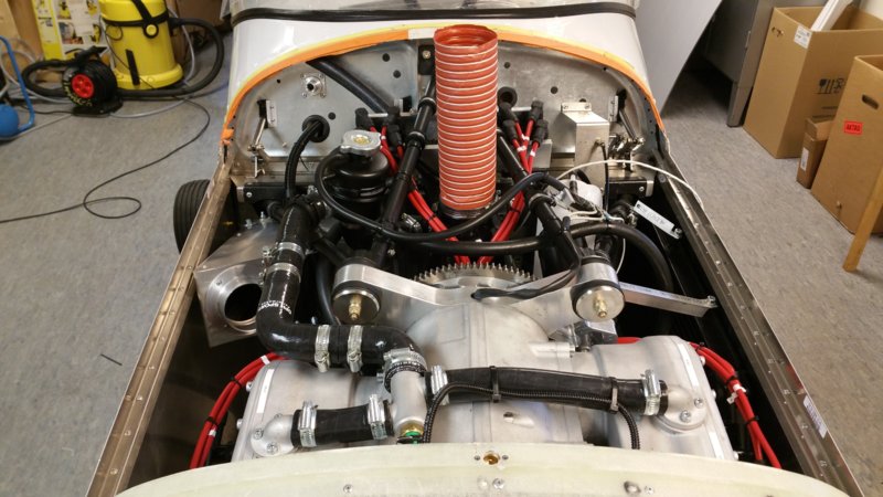

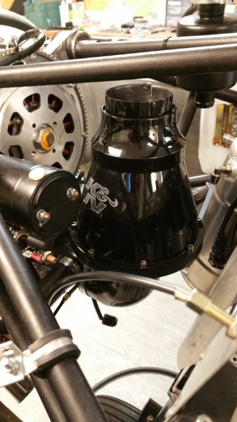

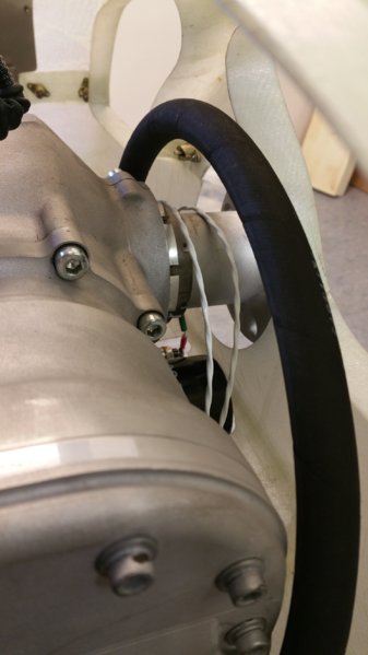

I got a new Airfilter box,, i use what i can find, problem is now how i get the air to the radiator, oilcooler and air box...... how can i duct it?

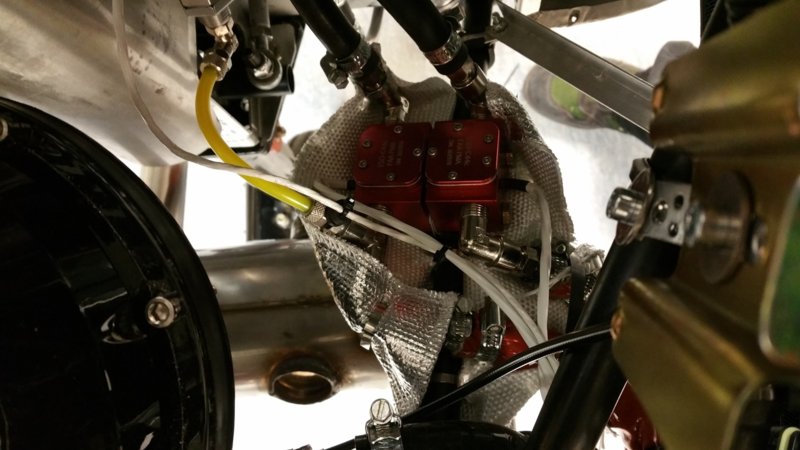

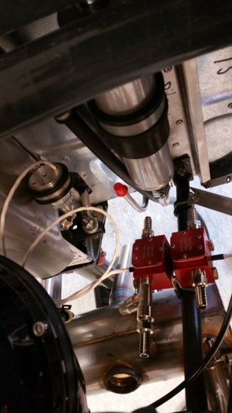

Getting the flowmeters installed.

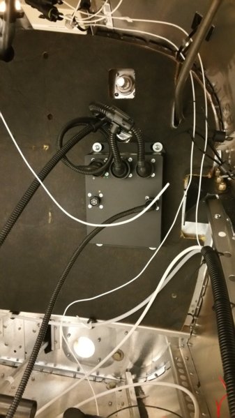

Also got the ECU mounted.

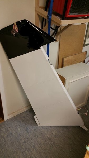

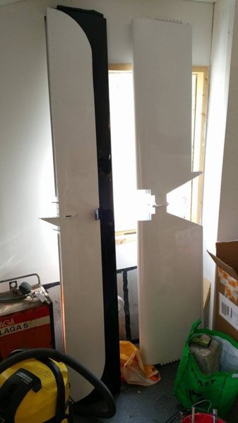

Ailerons are painted and so are the rear rudders that i am picking up tomorrow.

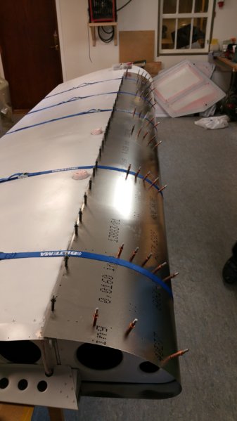

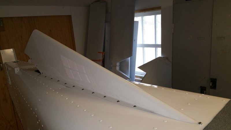

Ripped of the leading edges, since they got damaged in transport, already got new.

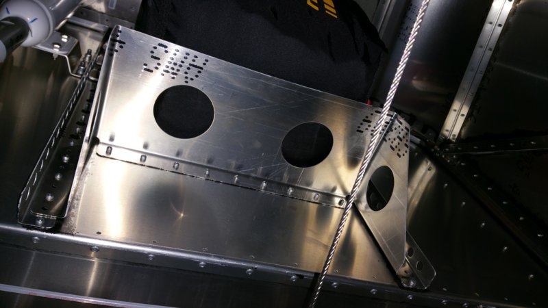

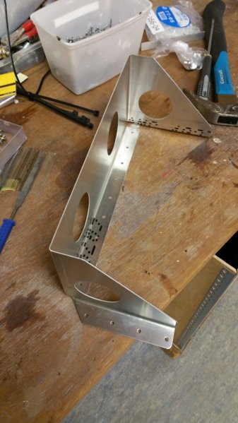

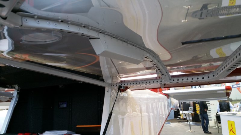

Also got the shelf for the parachute installed, a new thing required for warranty from junkers.

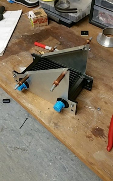

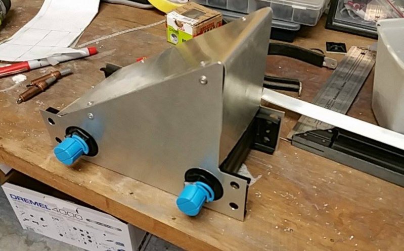

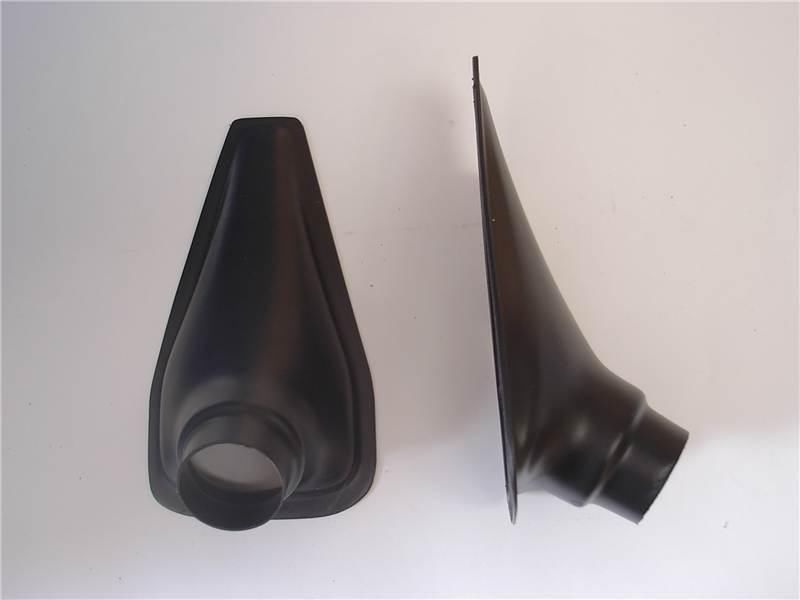

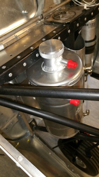

Made myself a oilcooler funnel, now where do i connect this?

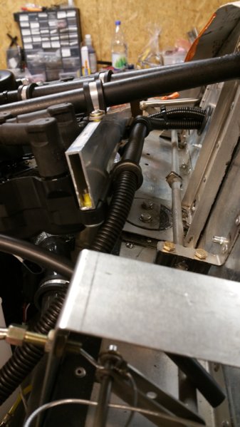

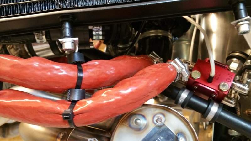

Got some Oil hoses installed, anyone know when i need to use firesleeves?

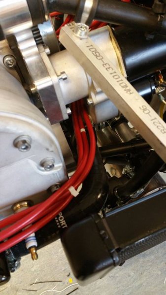

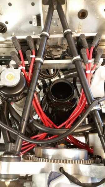

Installed the Ignition coils.
And the alternator regulator

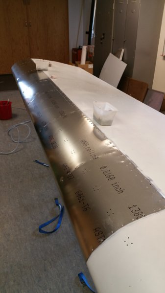

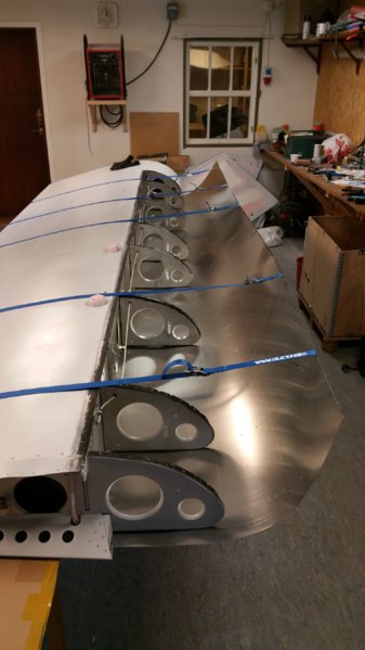

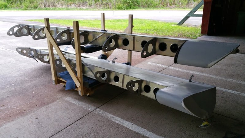

I got the wings back together, alot quicker when you have a helping hand.

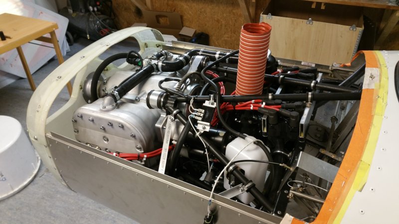

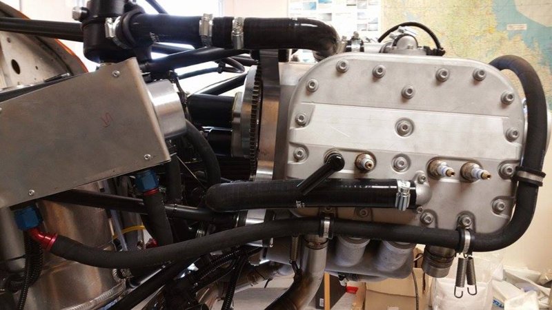

More stuff with engine.
Oil hose leaps free,

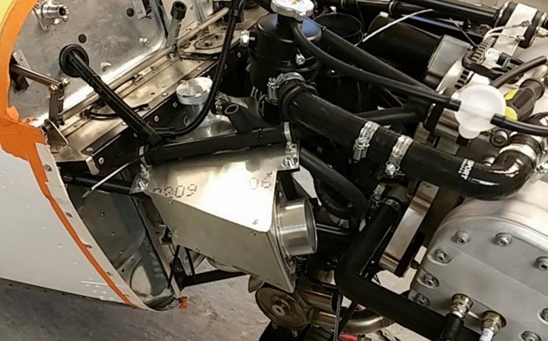

And air from front should do to the oil cooler.
Its really coming together.
I moved the Lambda plug more forward, D-motor recommended a move.

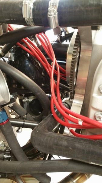

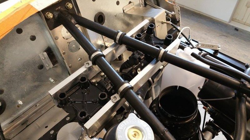

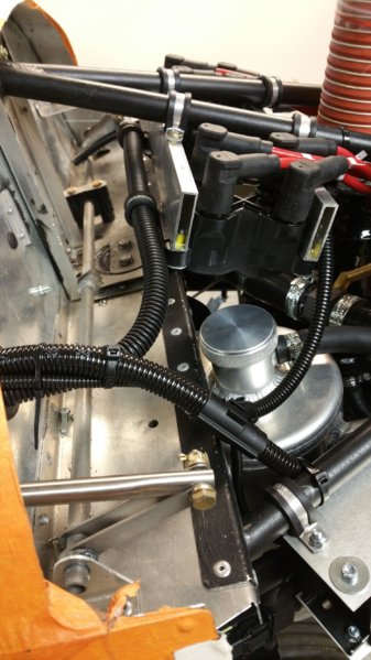

Got the power cables into the engine bay, i think it looks really neat.

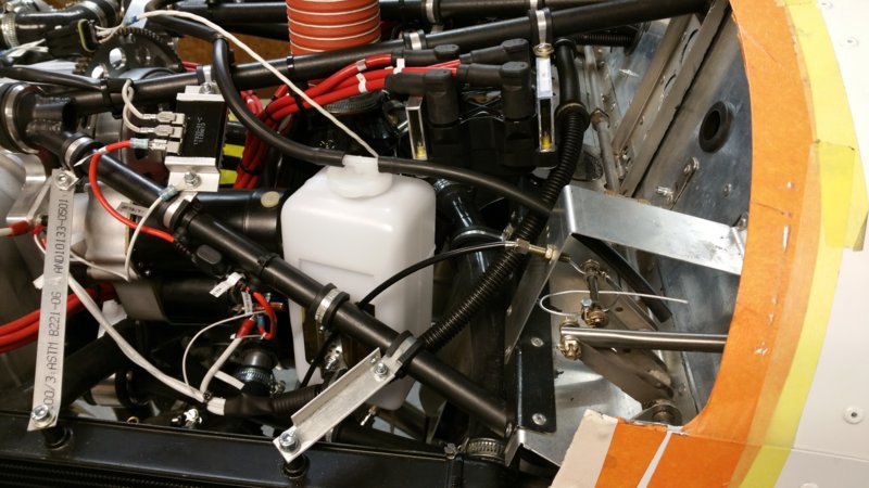

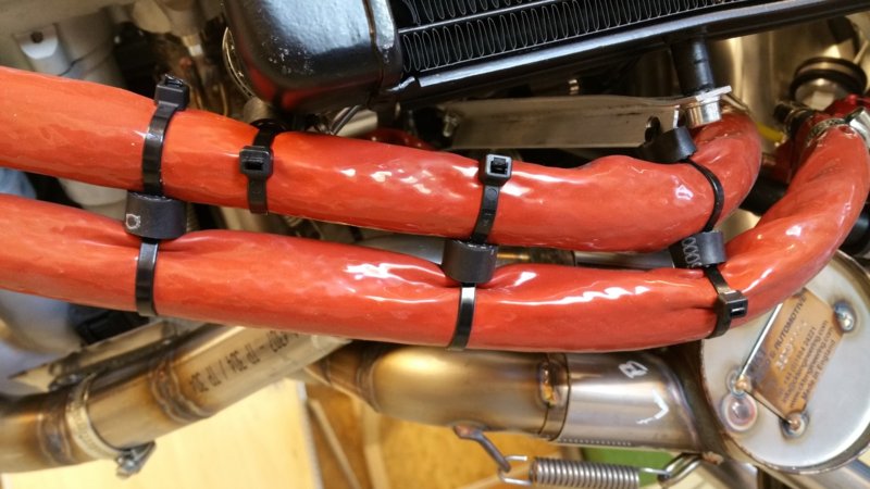

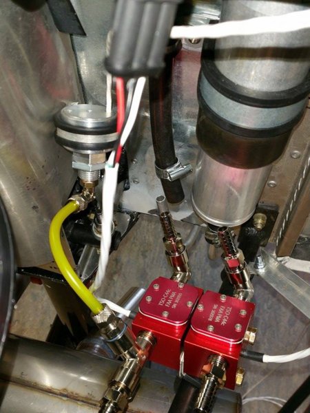

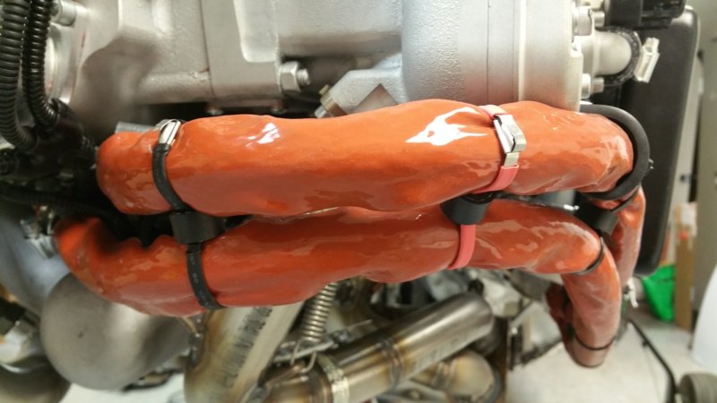

I played around with Fire sleeves, got them mounted around the fuel lines and that oil line underneath by the exhaust.
Also i felt i needed a heat shield as the fuel flow meters was really close to the silencer, anyone know a better solution? strapped it there with steel stripes.

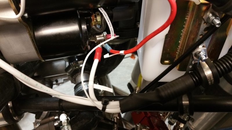

Another thing is to never couple wires at midnight:yuck:, everything goes wrong and it gets ugly.

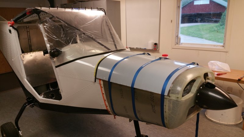

  • Create cowling hood - started

  • Create air ductings for cooling
