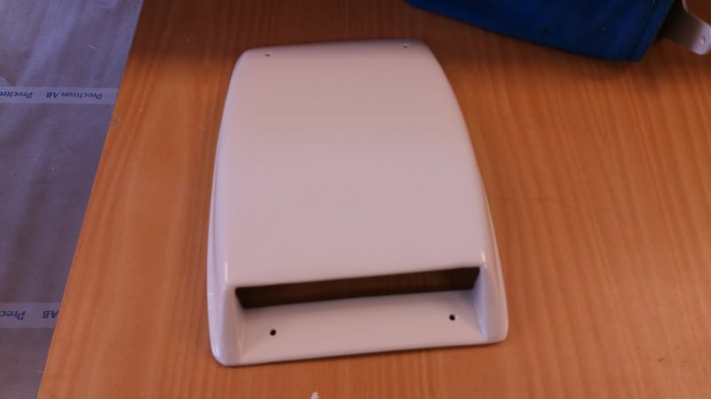

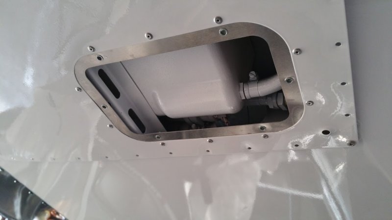

Got the new tank cover up and had to copy the inspection holes over to the old cover that didn't have it.[ATTACH]37534[/ATTACH] [ATTACH]37535[/ATTACH] [ATTACH]37536[/ATTACH]

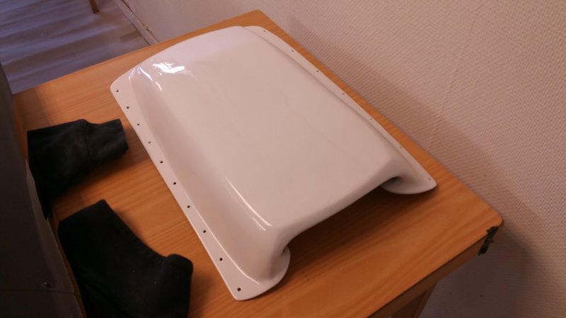

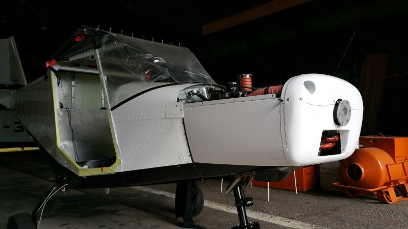

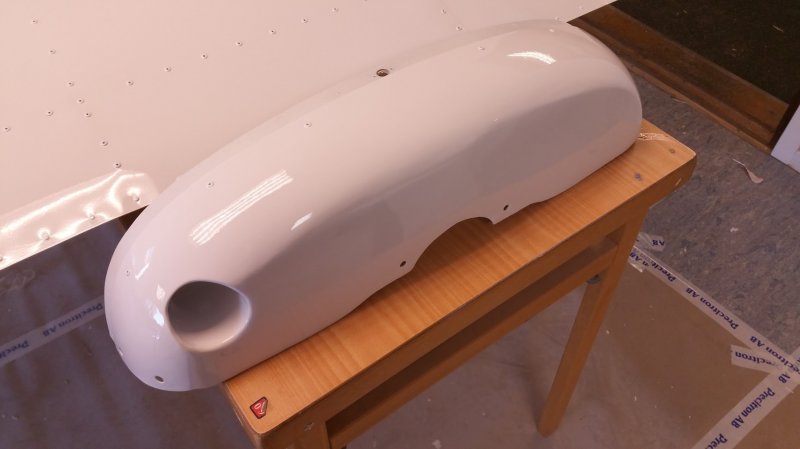

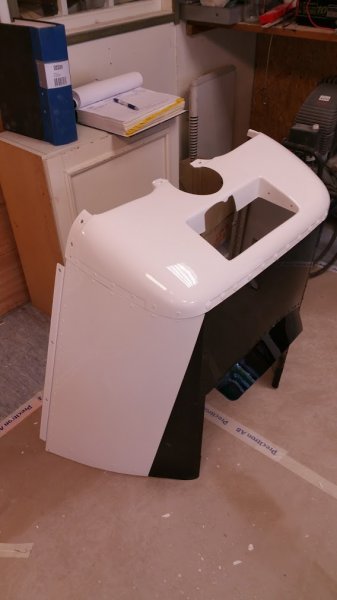

And i test mounted the cowl again to decide where to put the black line, i had to put it under the air intake.

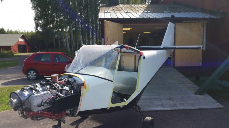

Tomorrow one of the wings are going to the painter over the weekend and the other one next weekend, so within one month she will have her wings 080_plane.gif.36548049f8f1bc4c332462aa4f981ffb.gif

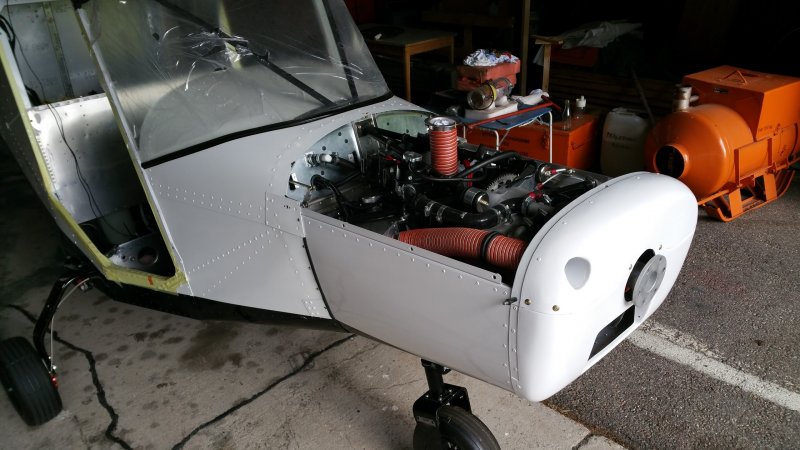

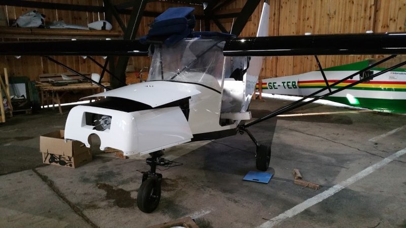

A question about the cooling intake on the port side of the cowl: Is there a reason why you are cooling the engine this way rather than the conventional front intake?
Big radiator and tight cowling, should bee some photos earlier showing it

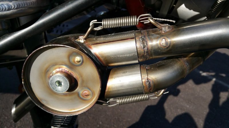

Also got the springs on the exhaust secured.

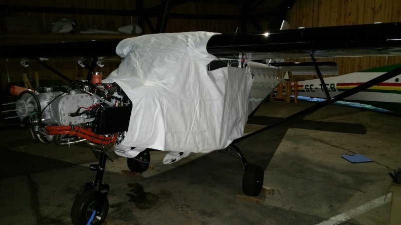

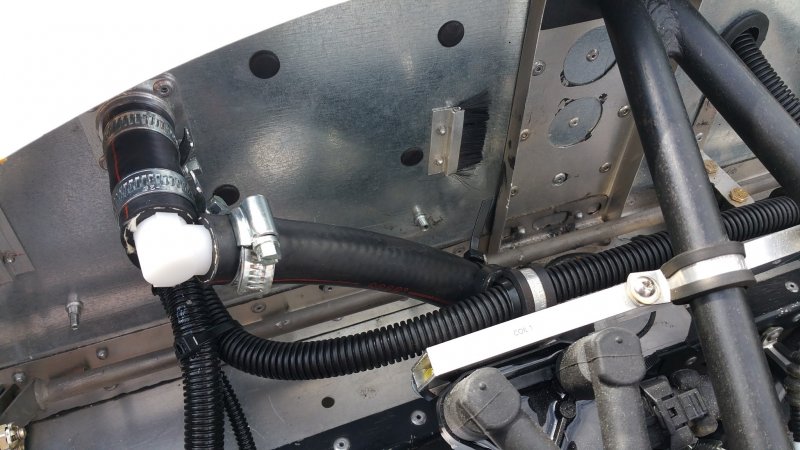

Got the cowl on and before that i connected the cabinheating hoses to the firewall, also some of the tape had burned really good so i stripped of some paint, lovely feeling, the paintbrush is comming:sweat:

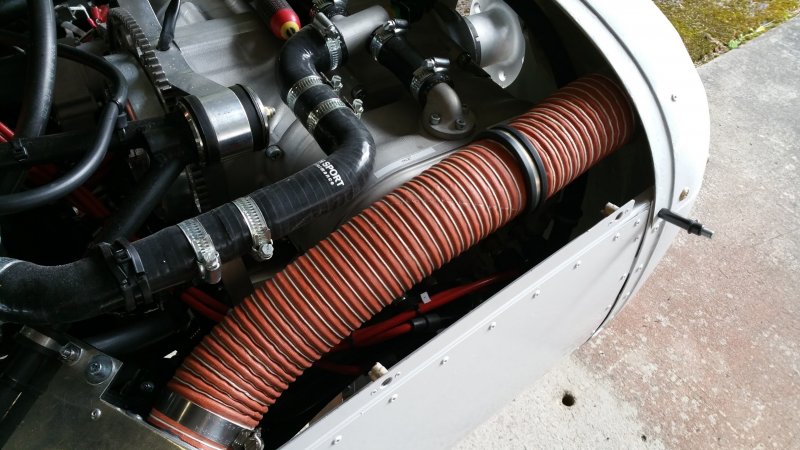

I also conected the oil cooler scat hose.

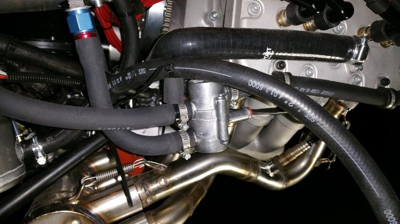

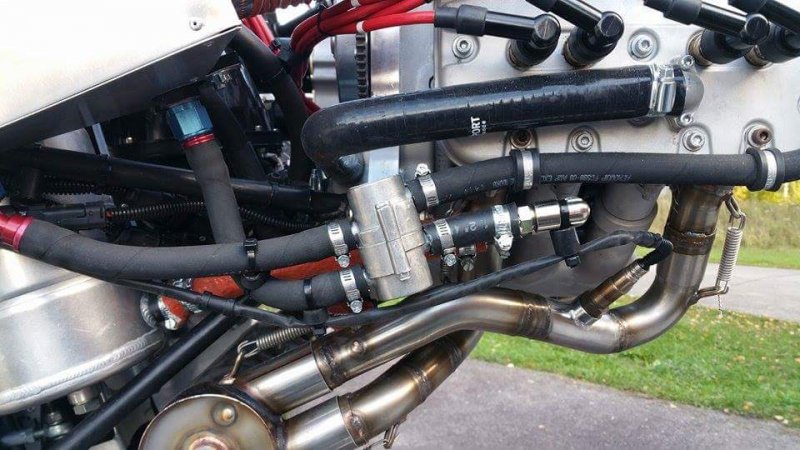

I installed a oil thermostat, engine manuf said my oil cooling was to good, bought a ordinary Mocal OT/1, saw the same on a Rotax and it was not the expensive on ebay, not yet completed since i wanted some firesleeve over the oil hose.

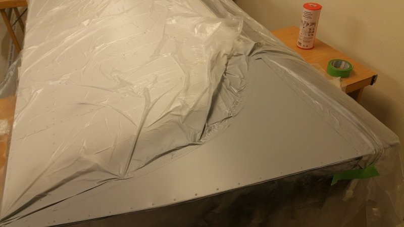

I wanted to remove the overspray so i roughed up the old paint and added new paint, that reacted with the old paint and made a raisin surface, it was easy to remove the paint down to the primer, i added new primer and new paint, lesson learned.

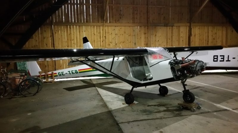

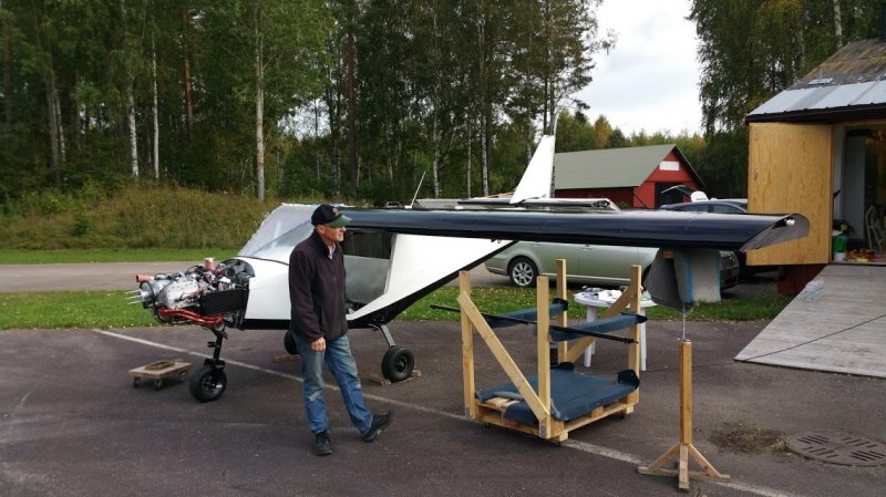

And a Great Sunday Resulted in the wings getting mounted! :rotary:
Gathered some friends and had a good time.
I installed a oil thermostat, engine manuf said my oil cooling was to good, bought a ordinary Mocal OT/1, saw the same on a Rotax and it was not the expensive on ebay, not yet completed since i wanted some firesleeve over the oil hose.[ATTACH]38084[/ATTACH]

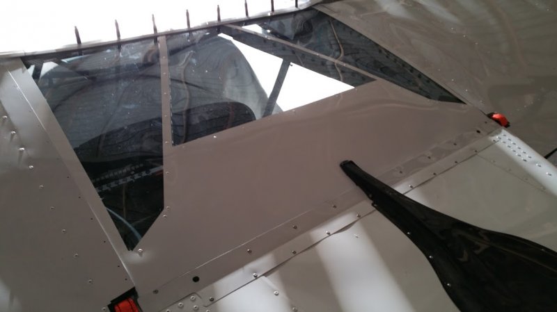

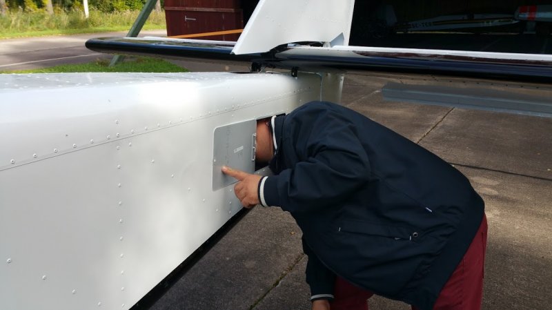

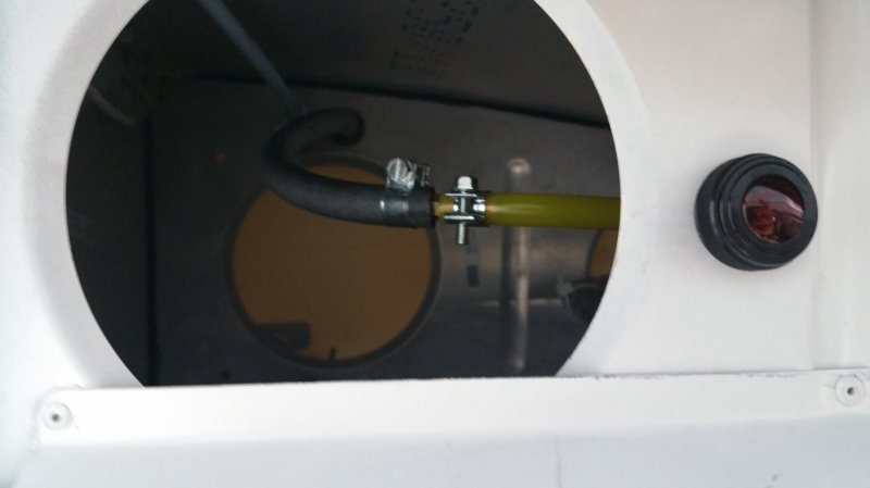

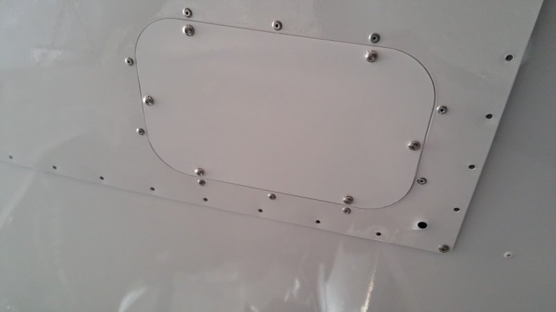

Inspections panels for wing tanks.

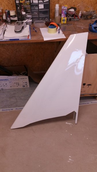

Stab/eleva wing tips.

I can see from the photos you have made some interesting modifications.
The small tank inspection panels are an icp thing, wrecked one tank panel and got one new with holes in, had to have symmetry, copied to other wing.

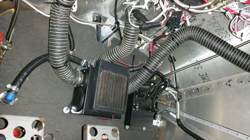

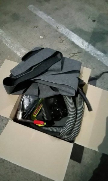

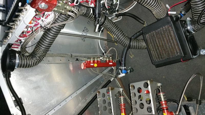

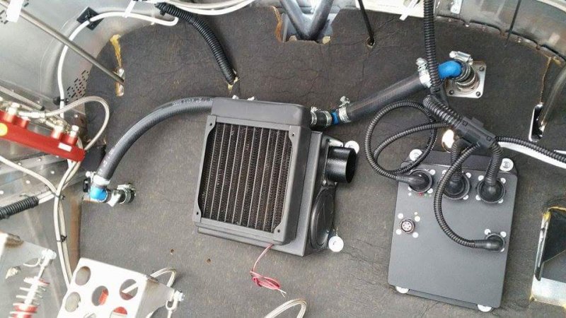

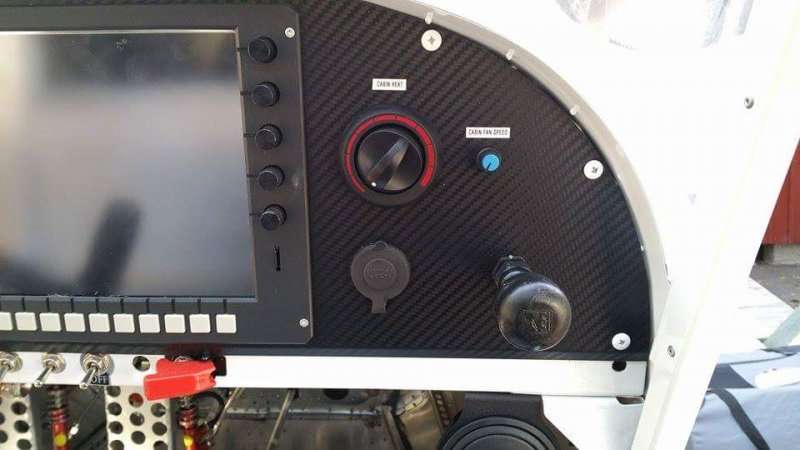

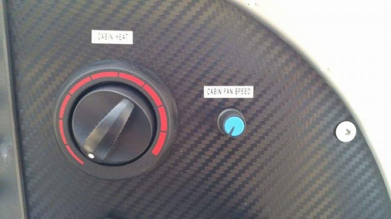

Installed the cabin heating.
And the oil thermostat.

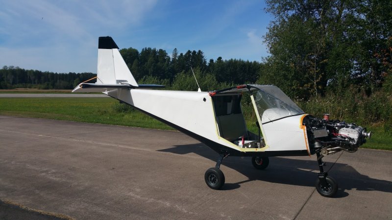

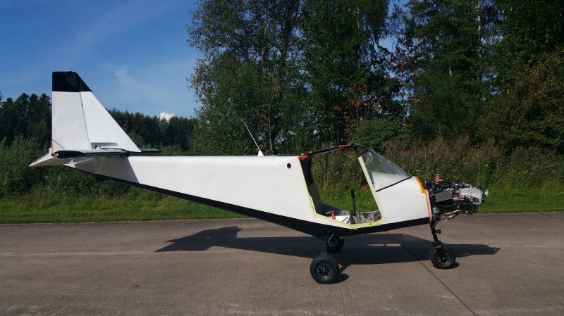

Small work tinkering.

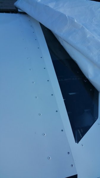

Riveting roof.
Gas return tube.

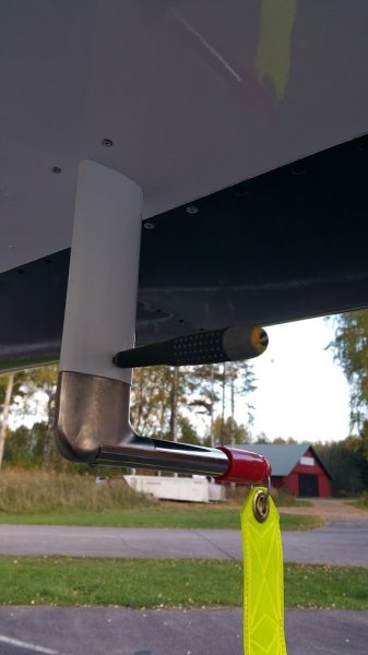

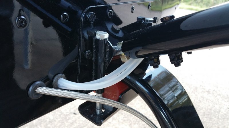

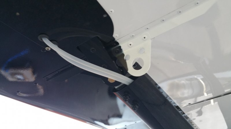

Pitot & Angle of attack tubing.
Petrol hose from wings
Cleaning up the bridles.
And Ailerons.
Just assembly of stuff to get it airborn :rotary:

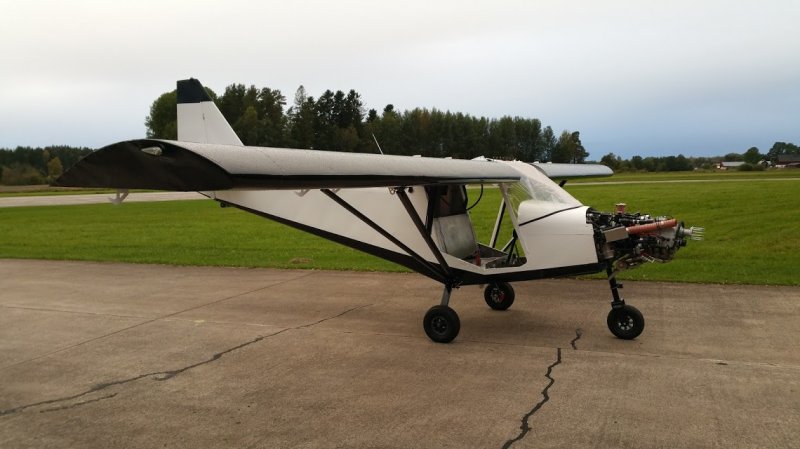

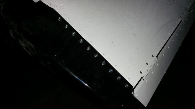

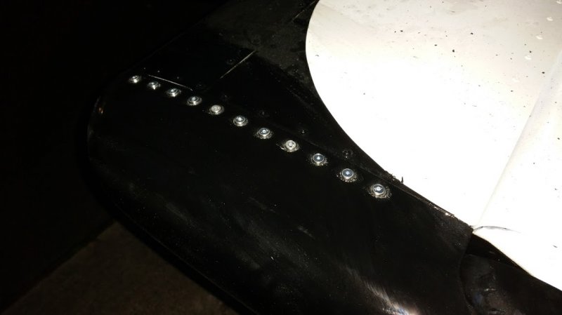

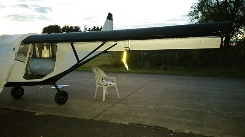

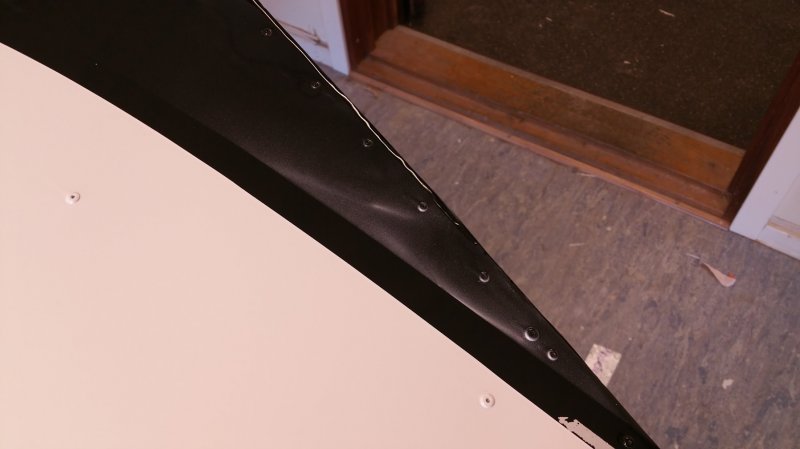

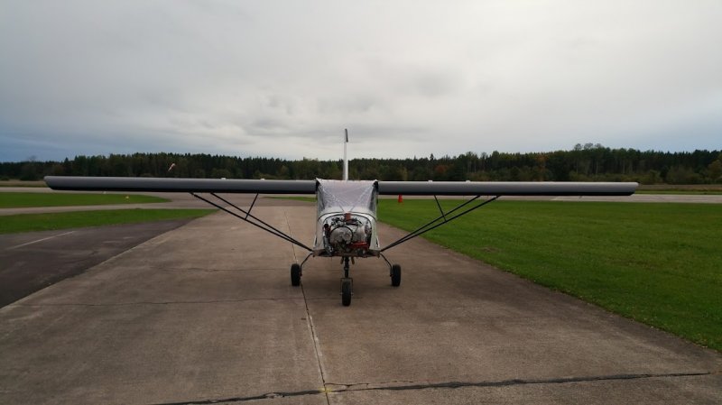

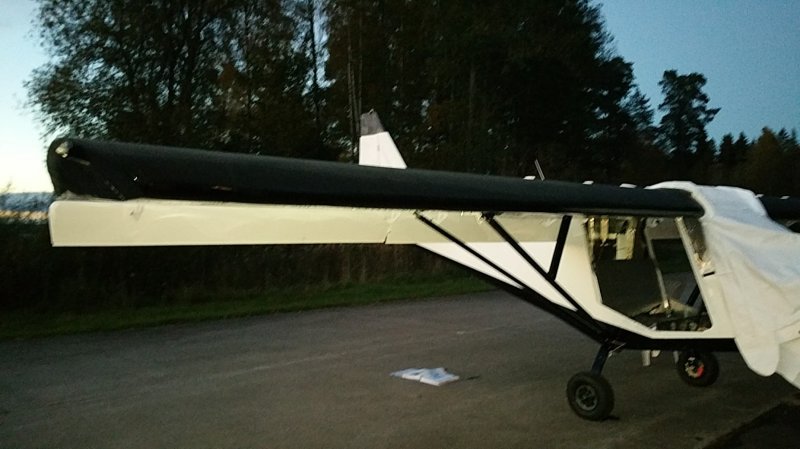

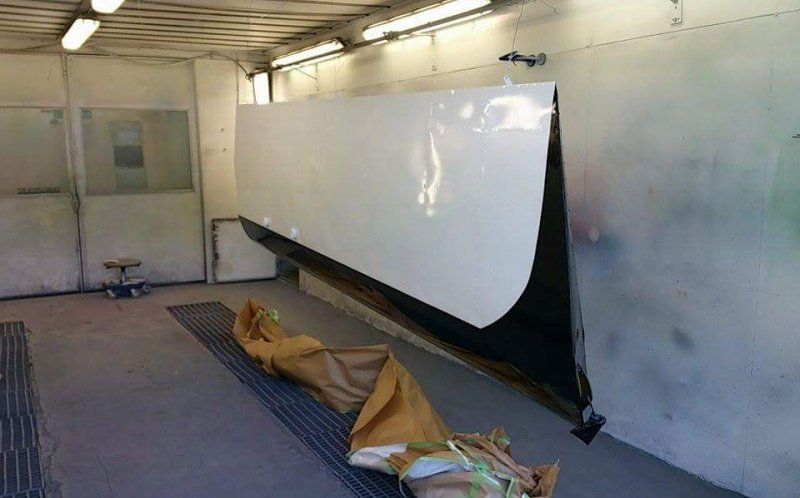

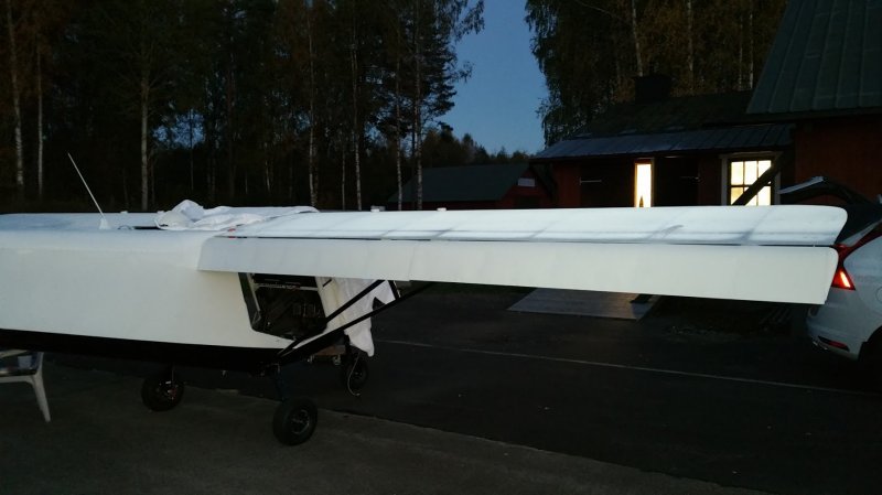

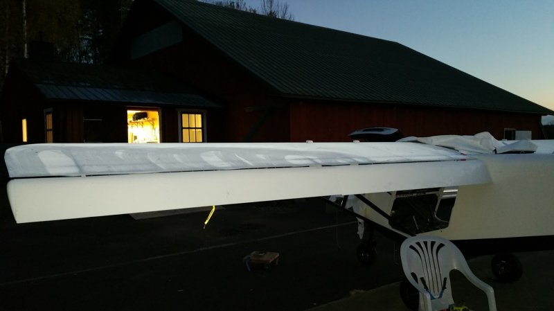

Just a weird thing i noticed today when sun was shining on the black surface, i got a big dent in the black leading edge of the wings, do they react on heat and expand ????
Very cold and some instant sun....
It can change shape...here in OZ certainly when it gets very hot but wouldnt think so where you are....just means the sheet was under some stress somewhere
Gundy built his with dark purple leading edge and had the same trouble, don't know that the sheets ever cracked but I did upset him while we were talking about it one day by crinkling a coke can until it fell in half.
I was standing next to Gundy's new Sav when he finished it at Monto then there was this almighty bang...frightened crap out of me...it was his nose D section on the wing changing its shape.

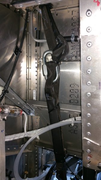

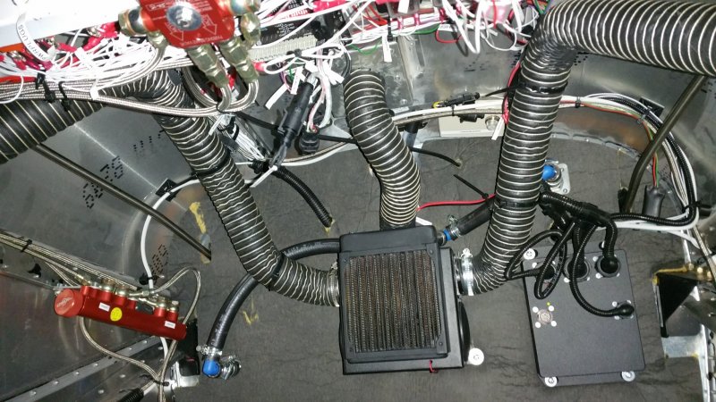

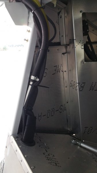

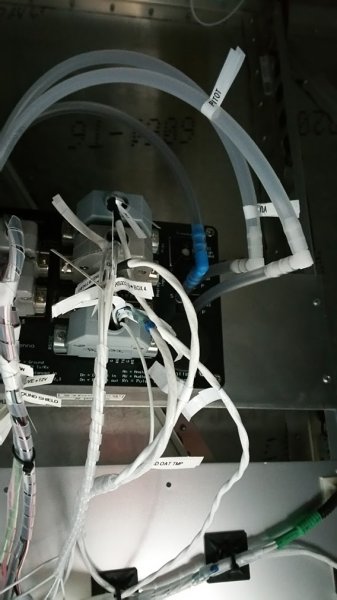

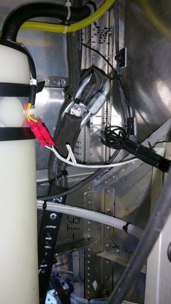

Cabin heating hoses installed.

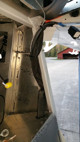

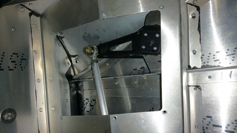

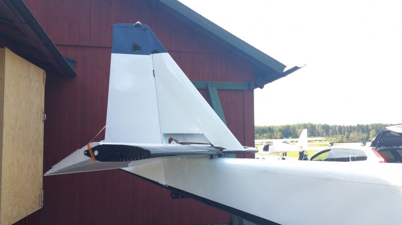

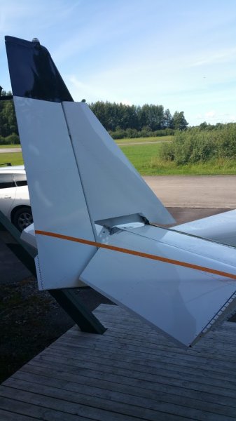

All the panels around the empennage installed, damn it was tight.
And control rods connected.
And some other small shit...010_chuffed.gif.c2575b31dcd1e7cce10574d86ccb2d9d.gif
