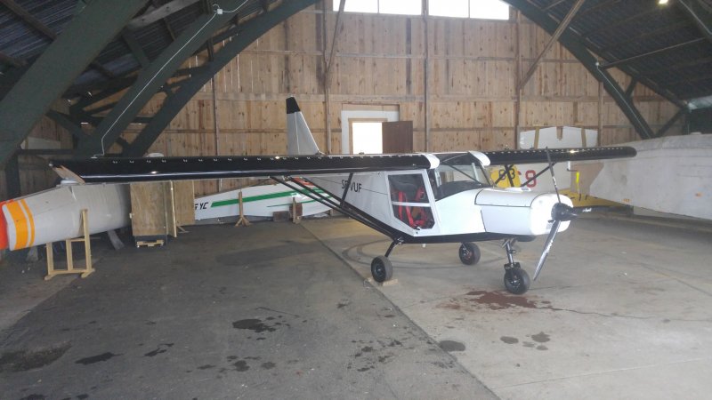

Ran the engine for a good 15 minutes, oil pressure went up to 5 bar and then settled to 2,1bar as temp went up, oiltemp didnt go over 68C, water went up to 101C then i turned on the watercabin heater and temp went down a few degrees, the funnel for the watercooler on the cowl is missing so, really nice...
  • 2 weeks later...

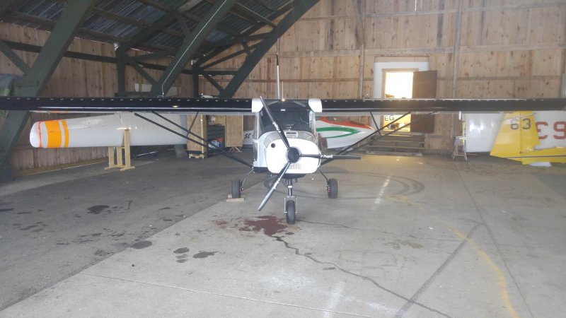

Its now ready, now lets begin final checks and flight testing.
Thought that was blood on the floor but there is no crime scene tape so you must have got away with it.
Actually is is blood from my aircraft 007_rofl.gif.8af89c0b42f3963e93a968664723a160.gif (oil)
Woo hoo! So close, do have permit to fly?
No do i need that? ,, kiddin ,, no not yet, there are some rigorous checks and groundtests before that shit can happen.
How long do you think before you commit aviation?
youve must have misunderstood me, this is just a ornament.
