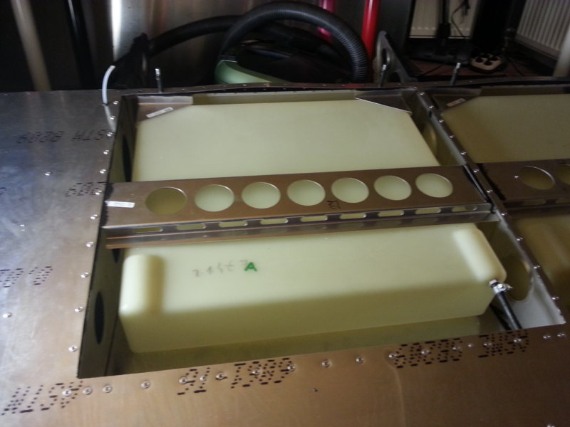

Whats on my mind now is if i should use Rivnuts to close the inspection holes for fueltanks or just rivet them, and at what stage to paint everyhing, really confused!
inspection wise i have easy access to optics to inspect the whole wing from my cockpit.

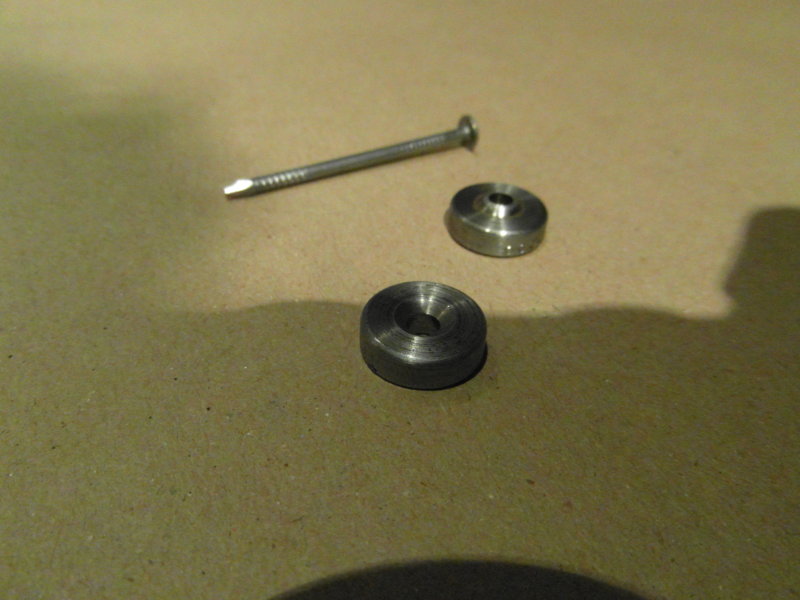

I have closed all four tank covers with 3mm countersunk rivnuts, ONLY on sides and rear, didn't want to drill big holes in main wing spar! As far as painting, just before engine and electrical installation , don't forget to do all the fairings and covers for strut attachment, wing roots and stabiliser etc.
I got mine from my kit supplier http://www.aerokits.net.au/product_6.htm , they were very much less expensive than the ones you found on ebay. He also has the 3mm stainless steel machine screws as well.
Ok, stainless steel? why not use Galvanized screws, its closer to aluminium in Galvanic relation?
http://www.scapro.se/images/galvanicrelationship.gif
I have used all 3 mm stainless pan head machine screws to hold the tank covers. Just be careful when pulling the rivets it is easy to strip the thread using the mandril in the puller also a good idea is to put a drop of loctite when putting the rivnut in before you pull it this will stop it from turning if it ever locks up. Also after pulling the rivnut I ran a 3 mm tap through it to make sure the screw went in without any grabbing in the thread
How would it go if you used 5mm screws along the main spar and threaded the pre-drilled hoes for M5
Thats one way going for it, intresting, but wont that induce cracking points in the main spar? i would rather use rivnuts in that case.

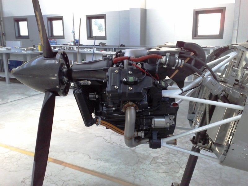

Engine choice is the ICP M09 Engine 115 HP. about 70kg
http://fly-buylsa.com/uploads/MotoreDellaNebbia.ppt Powerpoint
http://experimenter.epubxp.com/i/108002/26 article.

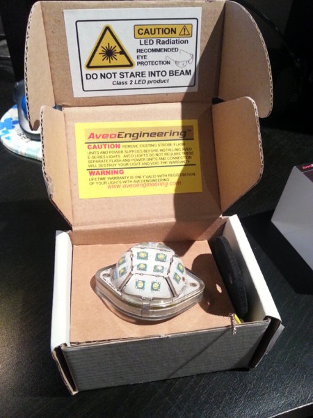

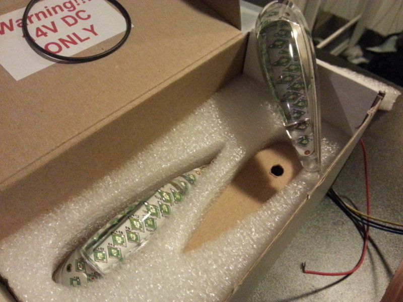

Im gonna use AveoEngineering POSISTROBE MINIMAX & POWERBURST
http://www.aveoengineering.com/index.php/product-info-posistrobe-minimax
http://www.aveoengineering.com/index.php/product-info-powerburst

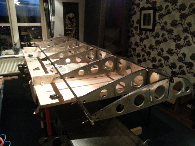

Thats how it looks like now.
inv.828.PDF
inv.828.PDF
inv.828.PDF

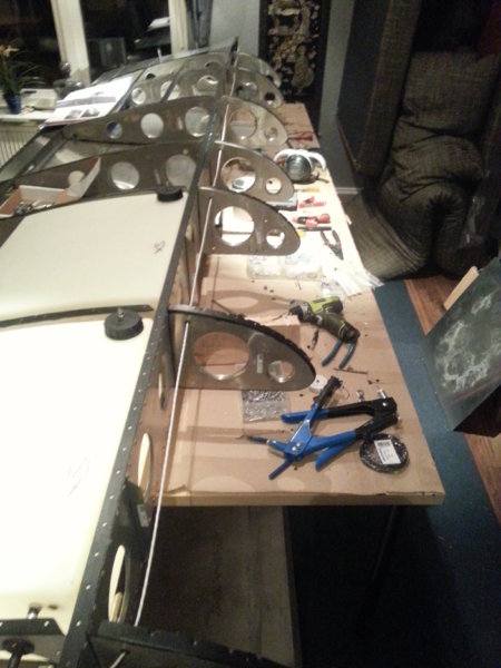

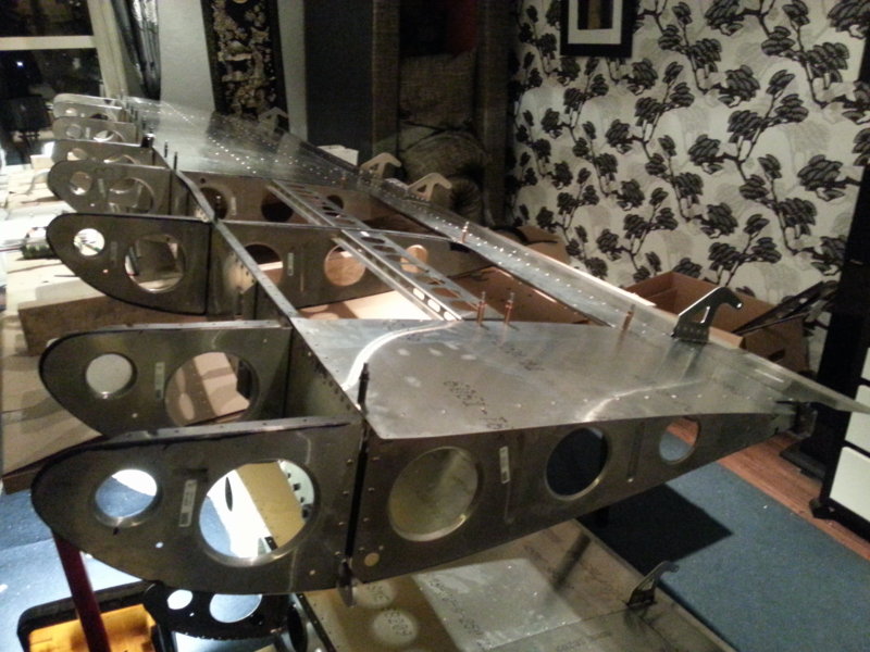

So yes left wing.

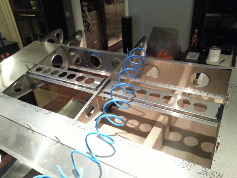

I dont have to read the instructions this time, i remeber everything, so it was just a matter of riveting everything.
Main construction, lower skin, skin by the Flaperons, outer bottom skin, flaperon consoles and console for vertical tip skin.

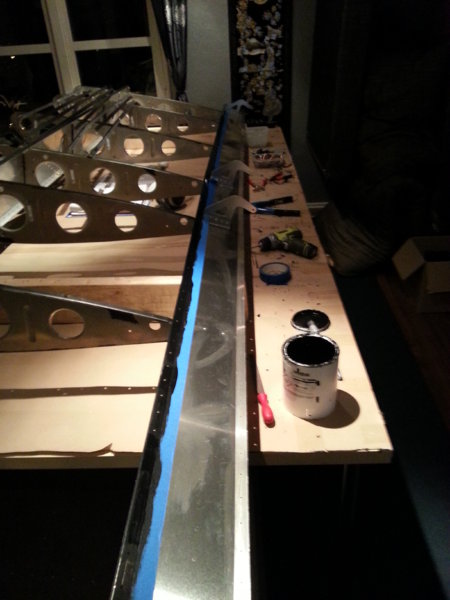

Tested out a new way to paint by masking so i wouldnt make such a mess, and it works =)

Its really cramped in here now.

Dennis what has ICP told you about the engine and when it will be available also a price?
Just about nothing, ive been trying to get some info so i can get it certified here in Sweden," yes ill fix" and nothing happens.
They said spring/summer.
all i know is in the yahoo group and the links above.

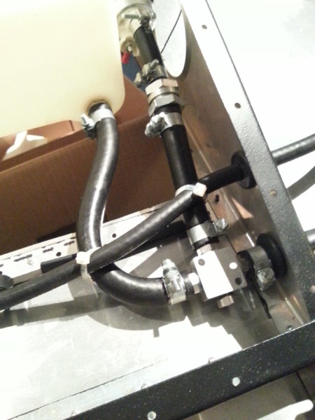

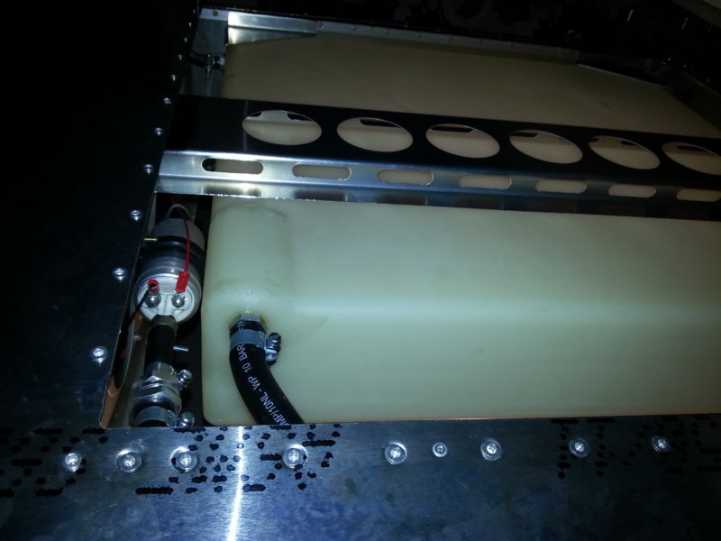

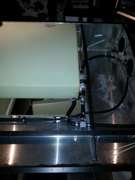

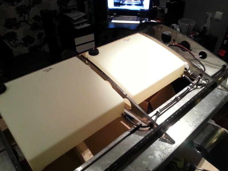

Been installing the fuel system today.
Even got the Molex plugs installed.

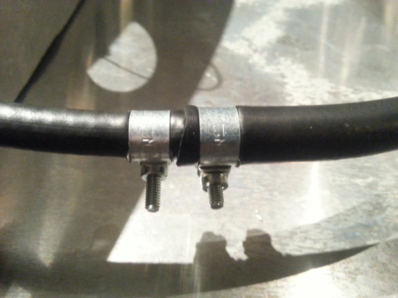

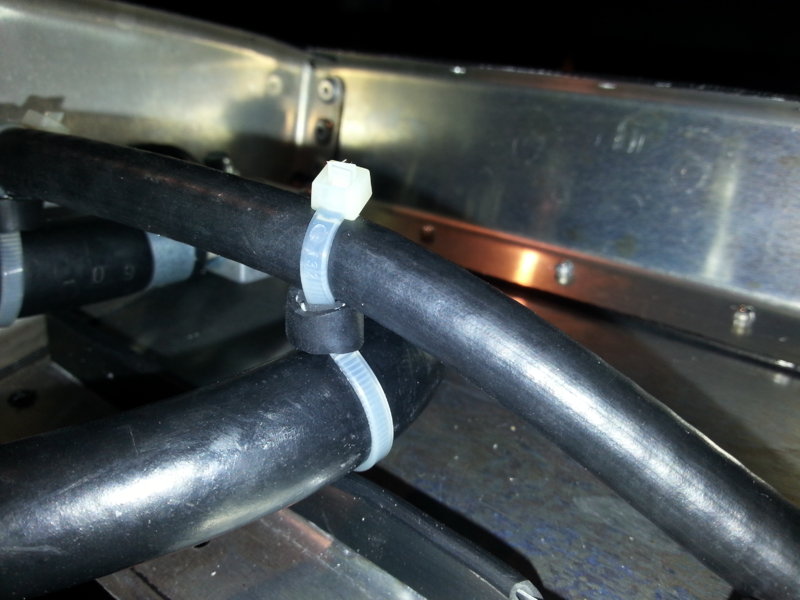

Hi Skee, I would add some kind of standoff between those fuel lines crossing over and touching each other. Either another zip tie wrapped around the one holding them together (between the two lines) or lay a small piece (5mm) flat of fuel line between them and then put the one zip tie through that to hold them. I am always surprised how much wear you get when hoses touch and can rub.
  • Caution 1
Like this?

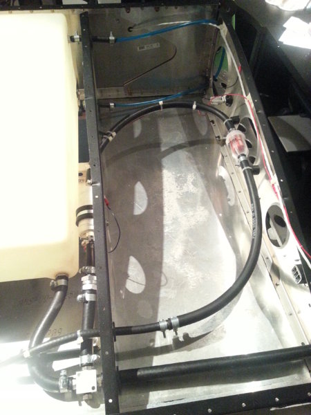

In the photo there's a blue hose, its smaller than the ordinary, but i had serious issues getting the ordinary 8mm hose into the smaller 5mm hose, so i changed it on both wings.
Also changed some other hoses that i thought was 8mm when mounted in Right wing but it wasn't.

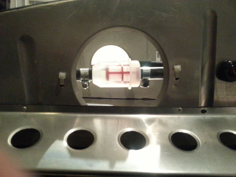

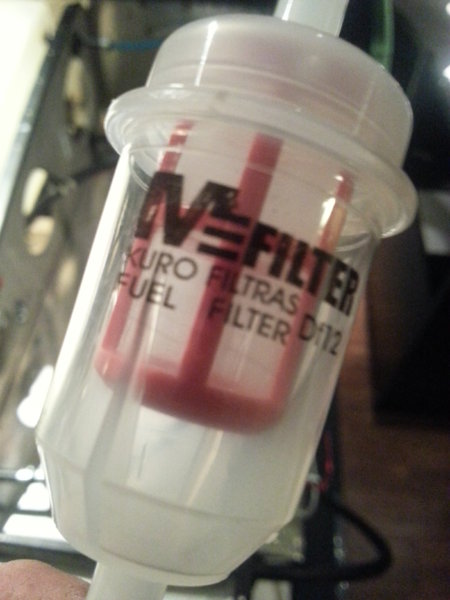

Today i also got the new clear Fuel filters so i could finally assemble system, filter was 8mm iD so had to make a coupling from the 5mm to a 8mm, i simply cut off the enlargement form the old fuel filter that had a 6mm & 8mm step and used it.

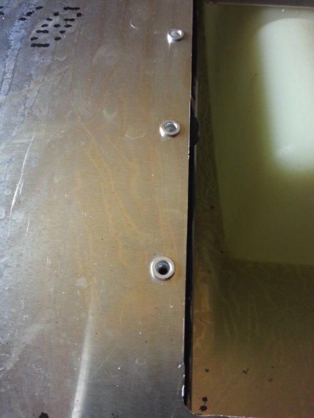

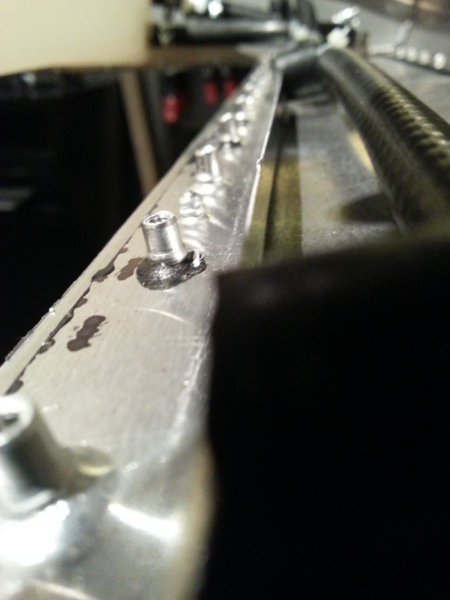

Also i mounted Rivnuts around the inspection hatch, this was a pain in the ARSE, they were so fragile, i had to redo several of them.
Rear part has counter sunken rivnuts and side has ordinary rivnuts witch makes them a bit taller.

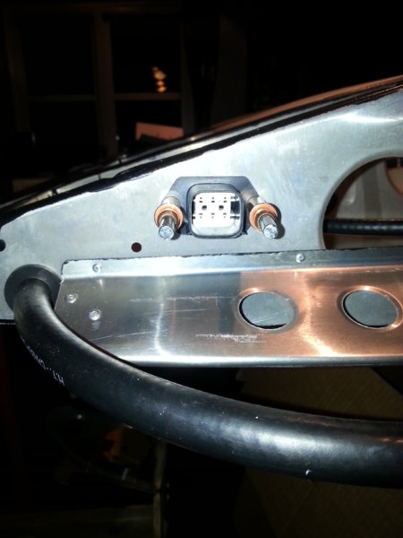

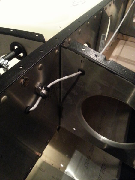

Also pulled a strobe wire. AWG20 3 wire shielded, that's some really expensive cable.
Were the rivnuts you used steel or aluminium? I had very little trouble with the steel ones on my tanks, except if you try to pull them too hard the thread pulls off centre, but there is no need to pull them that hard anyway. Aluminium one though are a real problem, nearly useless, the mandrel tears the thread out of them really easily so the screw probrably will too.
