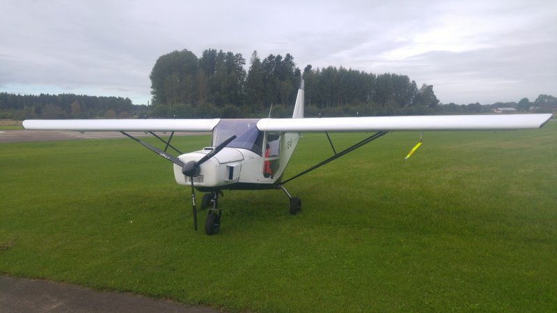

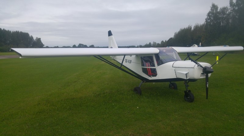

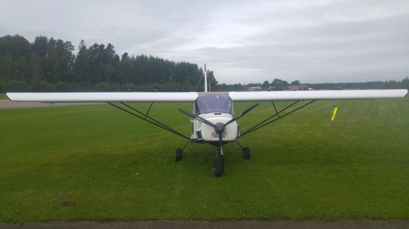

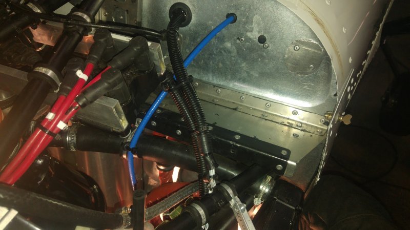

eightyknots Posted July 8, 2016 Posted July 8, 2016 Ok so i mounted the new air scoops and cooling is superb!It looks ugly but im not joning and pagent anytime soon. This makes me wonder if i installed the second radiator in vain now when it seems it was the scoops? [ATTACH]44152[/ATTACH] [ATTACH]44153[/ATTACH] [ATTACH]44154[/ATTACH] [ATTACH]44155[/ATTACH] [ATTACH]44156[/ATTACH] They look like big scooping air intakes. As Bob said, flow-thru air is the key (avoiding the flow-around paths). I hope you have that well sorted. One day, when you fly your aircraft to Australia, you'll still have plenty of cooling capacity to keep your engine at the correct operating temperature.

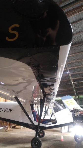

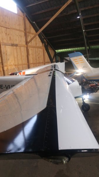

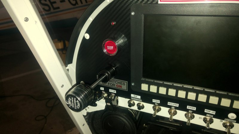

Skee Posted September 9, 2016 Author Posted September 9, 2016 So nothing much is happening now, inspection is approved and papperwork is taking way to long time, my technical advisor has gone missing so i cant get the final signature from him... The leading edge wing was black but i got so big movements when sun shined so i wrapped it in vinyl. I also removed the standard throttle handle and installed a vernier version from Mcfarlane. So for now nothing is really happening. 2
