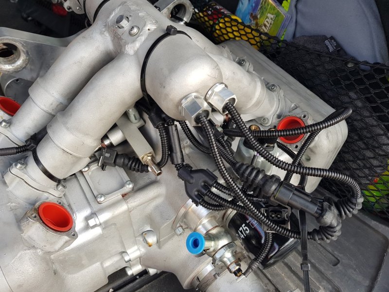

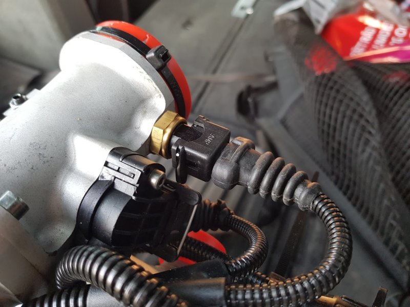

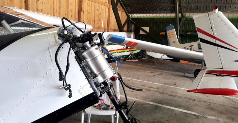

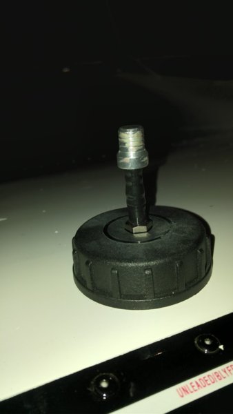

Skee Posted May 2, 2017 Author Posted May 2, 2017 So spring has been a real hassle, i did some changes and went flying again, and got a mid air stop again, so i tried to replicate the issue on ground, and yup after some full throttle something got hot in the motor electronics and engine shuts down, now we had problem sorting this out, and its as around the same time another guy got the same issue(he landed outside field), so D-motor sent us a new cam shaft sensor, we changed it and he went flying, and when climbing it stopped, so i refused to fly anymore until cause could be proved. It resulted in this! Engine is now on its way to belgium and i'm getting upgraded from Single ECU to a more well proven redundant ECU, taking the moment to also blast and powder coat my engine mount white. Summer is here and im still not flying :(

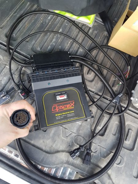

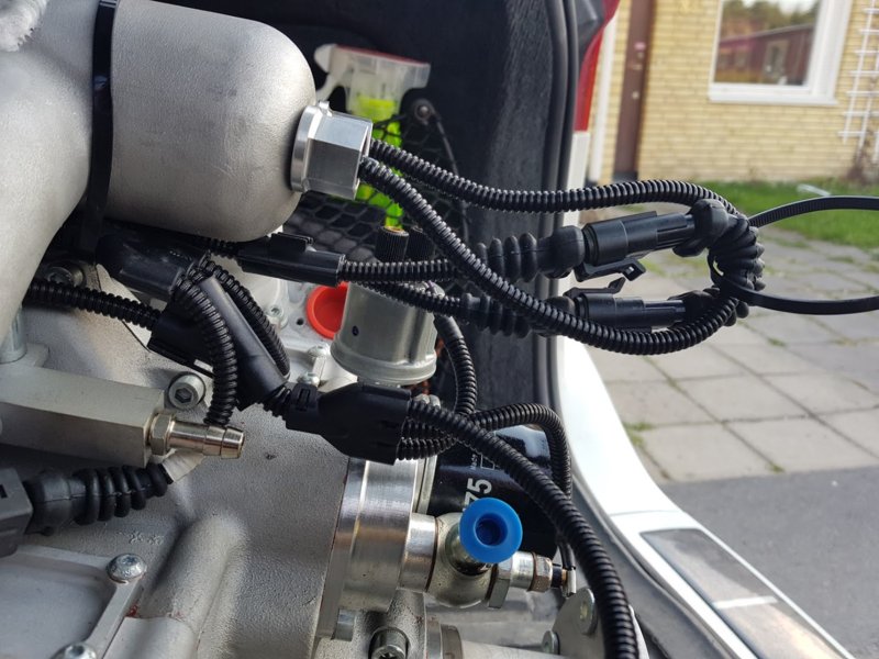

Skee Posted May 18, 2017 Author Posted May 18, 2017 A few more Sensors and a new Redundant ECU, to replace the older stuff. 1
Kyle Communications Posted May 19, 2017 Posted May 19, 2017 Are you putting the engine back in this weekend Dennis?....did they give you a actual reason?
Geoff13 Posted May 19, 2017 Posted May 19, 2017 Just caught up with this thread after a long hiatus. When I was researching engines, the one thing that I did determine was that had I gone with the DMotor it would certainly have had two ECU's and two batteries/power sources. As Mark asked any word on what the real problem was. I would certainly be doing more work on the inability to even turn the engine over after the in flight shut down.

Skee Posted May 20, 2017 Author Posted May 20, 2017 Are you putting the engine back in this weekend Dennis?....did they give you a actual reason? they couldn't replicate the problem on the Dyno(not as hot as in a cowl?), so no they couldn't which is a bit worrying. Of all engines he has sold it was only mine and one other guy here in Sweden who "had" issues with mid air stops.

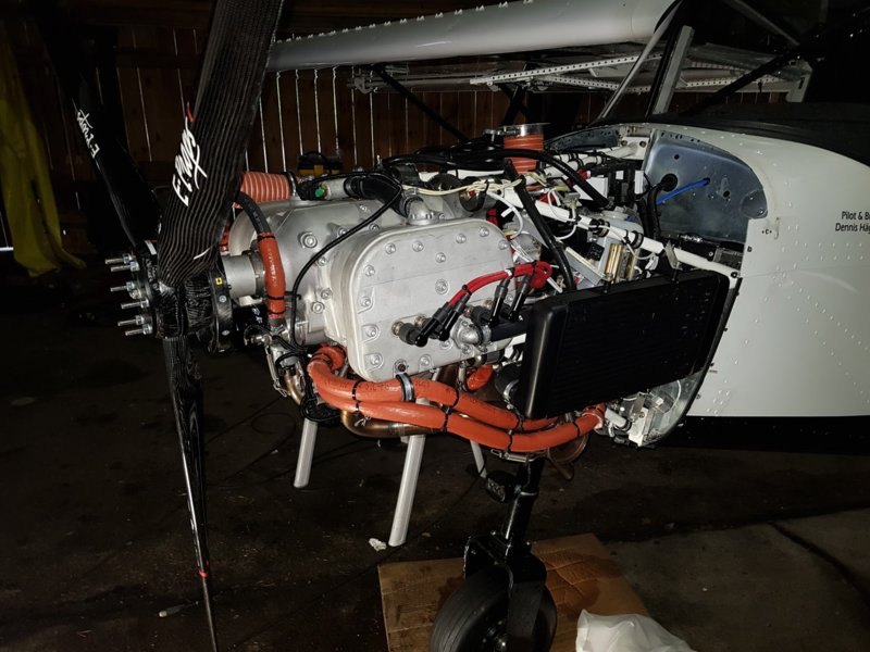

Skee Posted May 30, 2017 Author Posted May 30, 2017 Engine back on, windscreen changed, electronics all ok. Bad weather CHECK! 2
