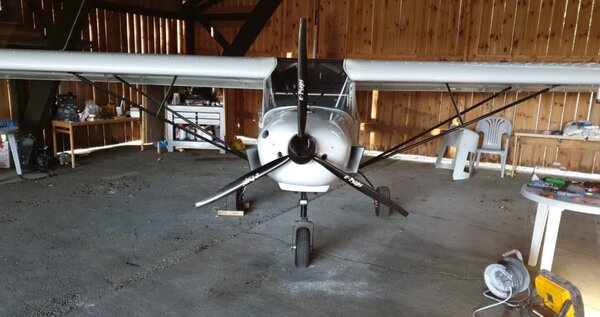

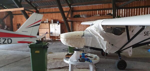

And i have now Lengthened the propflange 3cm and started with making my own cowling.
I poured foam over it and it looked like this.
And then i sanded it down a bit to get a feeling, and i like it allot more than the old one that was a compromise.

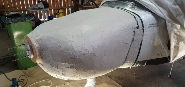

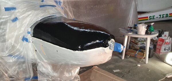

Got the shape ready, was a pain in the arse to sand the 2 part filler and now i have used liquid filler, next is to sand the filling one more time and then spray with 2 part paint and then on to the polyester mold.
Got the shape ready, was a pain in the **** to sand the 2 part filler and now i have used liquid filler, next is to sand the filling one more time and then spray with 2 part paint and then on to the polyester mold.

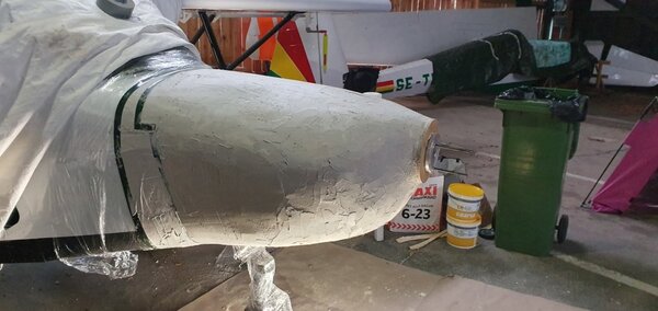

What a hell of a job, just spent another 3 days just fixing and sanding, jeeez, finally sanded with 400 grit & waxed, ready for mold.
[ATTACH=full]42351[/ATTACH]
Hi Dennis
Looking a nice shape. Hope you don't mind this question. Is your finish surface product suitable for the tooling gel coat or gel coat and layups? Wax alone will not protect certain coatings from reacting in a bad damaging way. Some coatings are damaged during the cure of the gel coat layer and result in a wrinkled mould surface. If your unsure about being a satisfactory product check with a local fibreglass shop experienced in moulding off patterns or atleast trial a sample piece before doing the mould layups on your cowl pattern. I learn't the hard way years ago. Cheers and best wishes

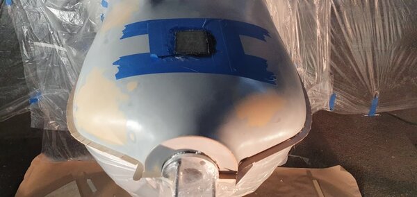

Gelcoat time.
And as Seperator i used tongue depressor and hot glue.
And another intresting fact, temperature rose from 5C to 24C in the pas few days, so filler expanded and i had to sand some spots...
Hi Dennis
Yeah thanks, i did a test sample and it worked out nice, the liquid filler did not like the curing heat so i lowered the mix volume of hardener and i used allot of extra wax.

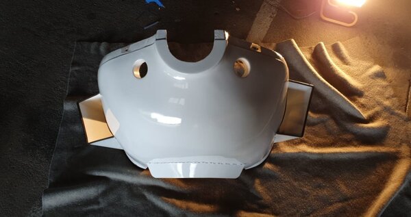

And its done, it took 2 months of active work on it.
Lets hope cooling works.
