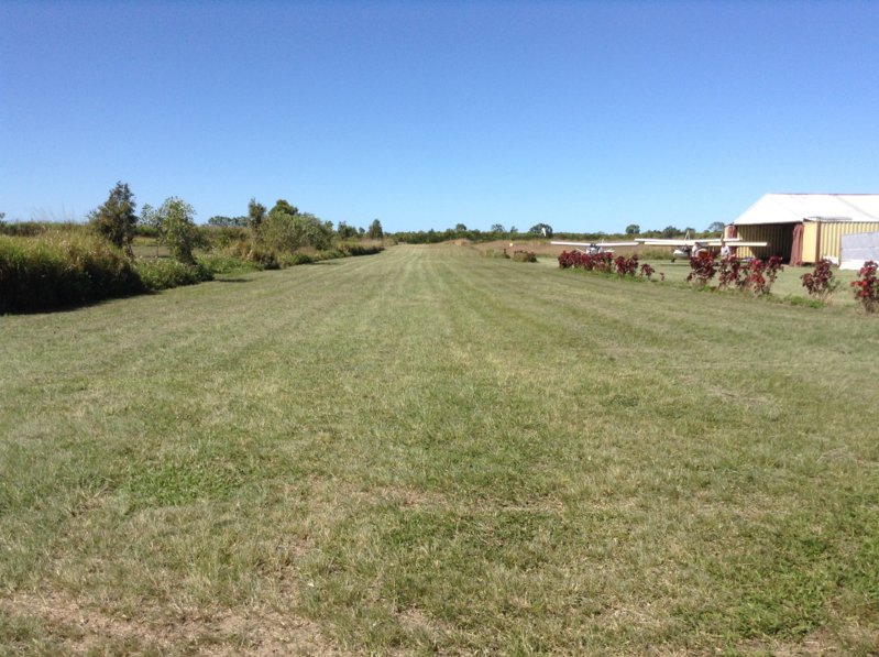

Guest Maj Millard Posted December 29, 2013 Posted December 29, 2013 I routinely go in and out of the short strip at Heathrow (photo) but as MM mentioned you must nail the approach speed and get back at idle at the right point, and always be ready to pour the coals on for go around if you get float, which can take you too far down the runway. If I'm not wheels on at the mid point, it's power up and out of there, for another go. Approach is either over cane or mangrove at the top end. Cane currently is around a meter and a half high, but will go up to about 4 mts over the year which makes it more character- building for sure..This goes for any shortish field ops, you must come over the approach end at minimum airspeed hanging a bit on the power, soon as you get rid of power you should drop on...you need some strip room to pull up. Jabs are not ideally suited to short field ops either landing, or take off, although there will be those who disagree with that of course...........Maj......
