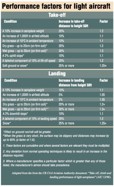

Garfly Posted December 30, 2013 Posted December 30, 2013 Regarding take-off and landing performance rules of thumb, here's a table from Flight Safety Australia (May-June 2001) and a FAA Wings Seminar handout by Amy L. Hoover: density-altitude-and-aircraft-performance-handout.pdf density-altitude-and-aircraft-performance-handout.pdf density-altitude-and-aircraft-performance-handout.pdf
Garfly Posted December 30, 2013 Posted December 30, 2013 I'm trying that Flight Safety table again as a pdf. hoping it won't be compressed beyond readability: PERF. CALCS..pdf PERF. CALCS..pdf PERF. CALCS..pdf

facthunter Posted December 31, 2013 Posted December 31, 2013 Good advice from Maj. The things that catch you are grass and effect of soft ground ,It is hard to evaluate these. As pointed out the effect of DA can be calculated so if you don't bother doing that and just take a stab you may get a shock that you deserve really.. The other thing is it will probably perform like a dog once airborne, at a high DA, so take that into consideration too. When conditions are marginal , pick a point on the runway where YOU should have reached lift off speed , and if when the take-off run is done you don't reach a good speed by the designated point. give the take-off away. Get the pax to go by car to some point more safe, and pick him/her up from there.. Nev 2 1
