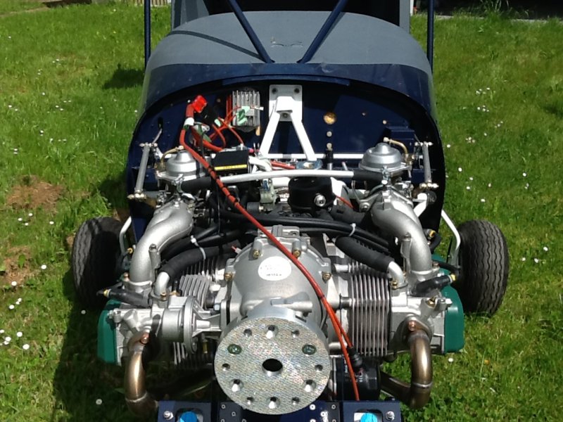

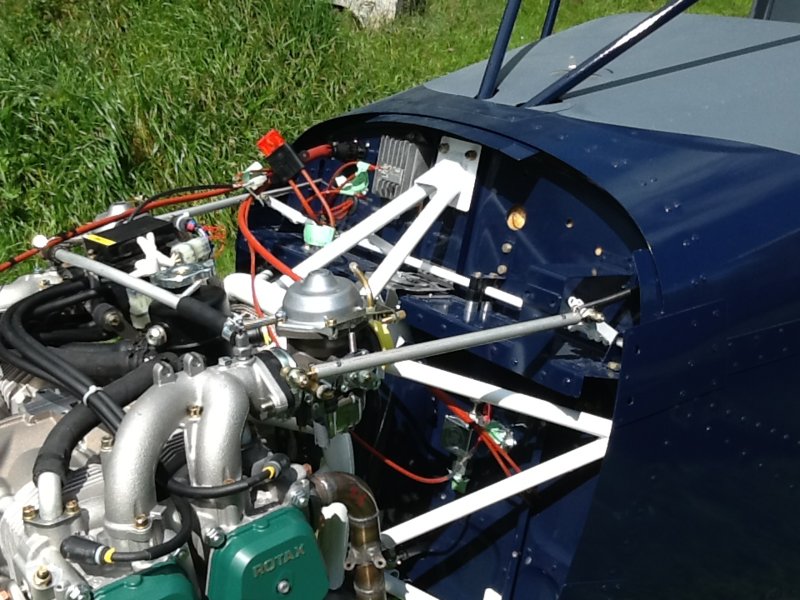

perrynz Posted October 23, 2017 Posted October 23, 2017 Hi Eric. I'm building a Savannah S. I didn't really like the cable set up either. It would probably work better if the cables were attached one on the LH side, and the other on the RH side, which is quite doable, but I really like the push/pull rod arrangement. It remains to be seen if there is enough engine movement to inadvertently affect the throttle operation, but by all accounts, with the "ring engine mount" system, it works well. Just last week I finished making the throttle set up using push/pull rods. As far as the hardware part numbers goes, I used what Rick posted regarding the rod-end bearings. (There's a RH threaded one and a LH threaded one for each push rod, which enables very accurate adjustment) Having access to a lathe is very helpful. You also need to purchase a LH thread tap. I purchased all of the hardware, including the LH tap, from Aircraft Spruce in USA. In addition to the rod-end bearings, you will need four "check nuts", that lock the bearings in place. (2x RH, 2x LH) For my rods, I used aluminium tube 0.500" x 0.058" 6061-T6, and turned up on the lathe the threaded inserts for the bearings to screw into. The inserts are held in place with rivets. I fitted my rods to the outside of the "fingers". It would be better to fit them to the inside though. To do this on the RH side is easy. In order to do this on the LH side requires removal of the throttle cable bracket. I didn't wish to do this just in case I need to revert back to the original cable throttle arrangement. Here's a couple of pics of my set up. I am very happy with the finished product, BUT PLEASE NOTE, I have just posted this to show what I have done. It is intended for information only. If you don't have the technical know how and access to machinery, then you are better off to stick with ICP's cable system. 1
