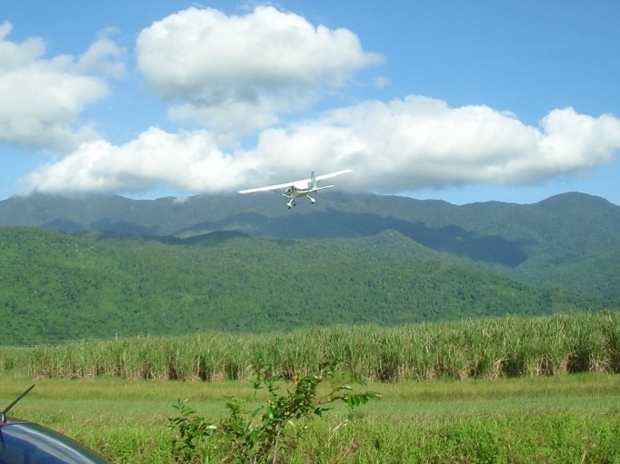

biggles Posted January 14, 2014 Posted January 14, 2014 Not sure how this thread drifted so much but here goes ......... Getting into a short strip is one thing , but getting out may be another . Some time ago I flew into Farri's property , just South of Cairns in the fully loaded J160 . The very scenic strip is grass , level , 500 metres long with cane fields at one end and vegetation at the other . The orientation is generally east/west and the wind when we arrived was a gentle Southerly .I figured the grass would assist the landing roll , and probably touched down about 150 m past the threshold to clear the vegetation . I finished up having to add some power just to get to the turning node . Getting out , a week or so later presented a totally different scenario , and , as we know , just about everything grows rapidly in that part of the world after a shower of rain . I walked the strip with the GPS to see if maybe one end was favoured , but no , no difference in level , and the grass still damp with that gentle , and unhelpful , Southerly again . Having regard to all the prevailing circumstances I made to decision to offload my 'navigator' , and Frank obliged by driving her to Innisfail airport , a few km South . I guess the point I make is that each take off and landing must be carefully assessed , having regard to all the conditions existing at the time . We shouldn't assume that because we landed at a certain place , in a certain aircraft last month , that it is necessarily safe to do now . Don't put yourself under any pressure , the sort of flying we do should be pleasure able and, above all , safe . I have no doubt that had I attempted to take off fully loaded , in those conditions in the J160 with its 80 HP engine, I may have been a statistic , whereas a 6 cyl Jabiru would have done it easy .The attached thumbnail shows me finally departing Franks strip ,heading South for the 15 min .flight to Innisfail. 1 3
motzartmerv Posted January 14, 2014 Posted January 14, 2014 Too right Biggles. Great example of airmenship with a real chance for a gotya. You could easily been sucked into a false sence of security after landing short on that strip. Thanks for sharing. 1 1
crashley Posted January 14, 2014 Posted January 14, 2014 yeah smart decision bob assess each take off and make a decision based of the conditions at the moment not what it was like last time or even last week 1
