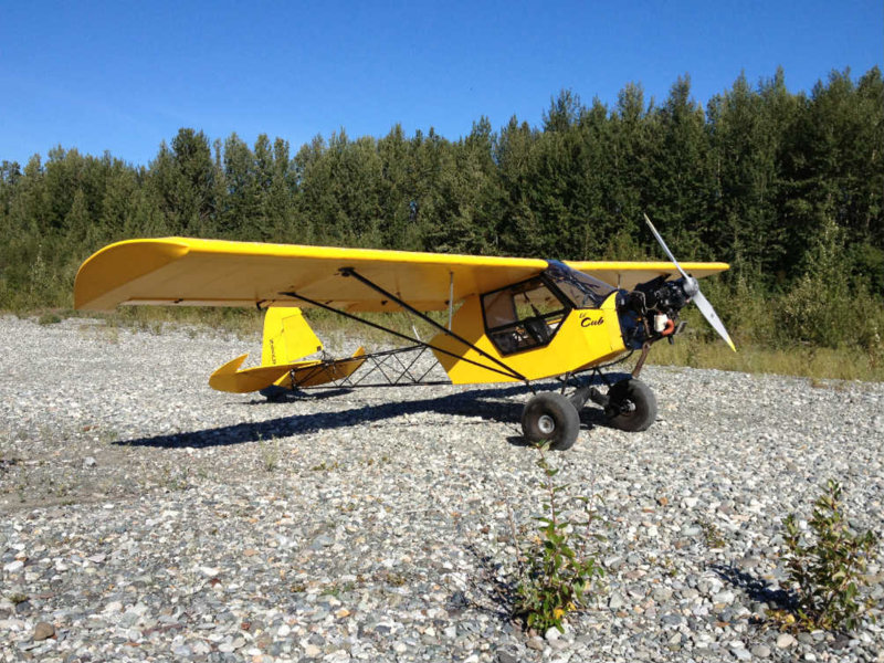

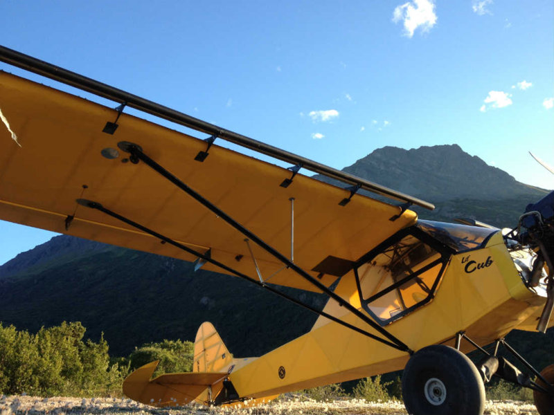

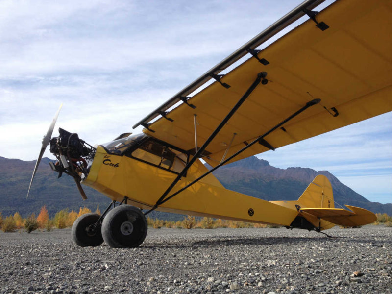

There's a small plane that was recently brought to my attention that a fella in USA built using some of the parts of an early Piper Cub. After his rebuild and modifications it's still a (close) tandem two seater and it won the STOL championships at Valdez (Alaska) last year. Some of the competitors there had spent half a million on their plane modifications and much to their embarrassment Frank came along and blitzed them with a budget toy. It's the yellow 'Lil Cub' at 1:00 min in the video and in the pics below. It has some pretty clever aspects to the design but there's nothing difficult about it. And Frank Knapp, who built and owns it, reckons it's more fun than anything else he's ever flown. He doesn't ordinarily use it for competitions, it's his local explorer the rest of the time.
I think something along those lines - tandem, commercial grade aly tube, gusseted/pop riveted, Rotax 582, Hirth 3203 or MZ202 engine, fixed slats, large flaps, fold back wings - could probably be built and operated quite economically.
What do you all think of the concept?
