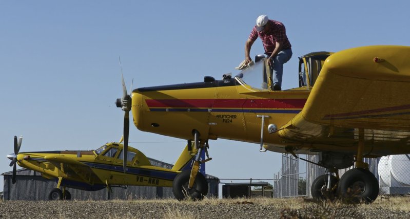

Stoney Posted January 17, 2014 Posted January 17, 2014 The wonderful pilots of the water bombing aircraft and their spotters, both fixed wing and rotor, helping to keep us safe from bushfires. I spent the day with the farm fire fighting equipment hooked up and ready, liaising with the neighbours and monitoring the three fires within a few kilometres. I was watching the firebombers come and go and listening to the sometimes frantic calls on the CFS radio, feeling the wind changes on the back of my neck and wondering how hard it would be on the pilots. On days like today, I don't have to fly, nor do I want to. I am very grateful to those that do. Whoever you guys are, a very heartfelt thankyou, I salute you. Gary 2 7 1
rgmwa Posted January 17, 2014 Posted January 17, 2014 We had the fire-fighting helicopters, the Erikson Skycrane and a couple of others, flying at tree-top level over our house for several hours last Sunday during the Parkerville bushfire in WA. They were drawing water from a large dam just across the road and dumping it on the fire front, which got to within about 2 km of our place before the wind shifted. In fact we evacuated at one stage, but returned later. Their circuit time was only about 5 minutes. Those pilots are very good. They have to maintain high levels of concentration for hours while flying at low level in hot and turbulent conditions, and in close proximity to other aircraft. Hats off to them. They do a great job. rgmwa 2 2 1

Garfly Posted January 21, 2014 Posted January 21, 2014 Stoney wrote: "The wonderful pilots of the water bombing aircraft and their spotters, both fixed wing and rotor, helping to keep us safe from bush fires … Whoever you guys are, a very heartfelt thankyou, I salute you." Well, I hope it's not talking out of school to reveal that one of those flyers is our own (rather shy) "Student Pilot". Go figure! …. with something like 25,000 hours at the stick you'd think ol' Stude would have graduated by now, no? (Okay, he does run out of fuel occasionally - but only in his vintage Land Rover ;-) 4

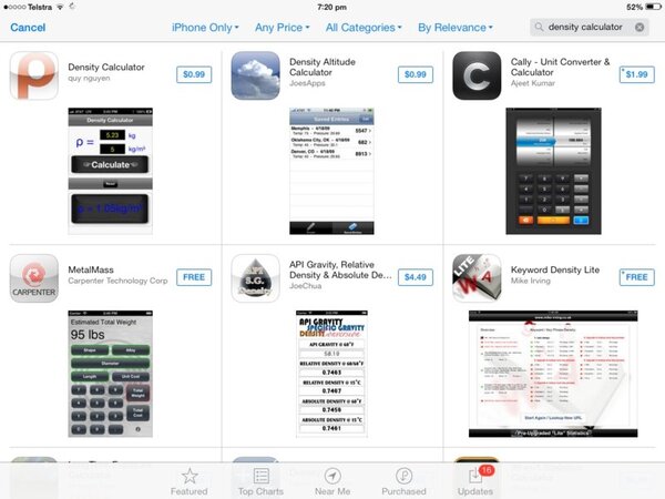

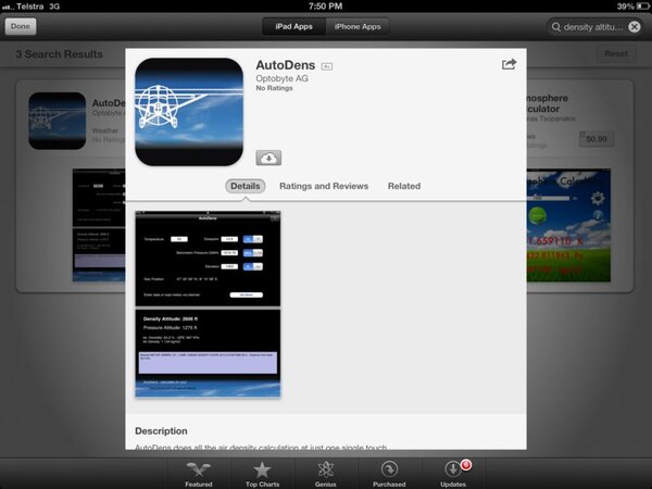

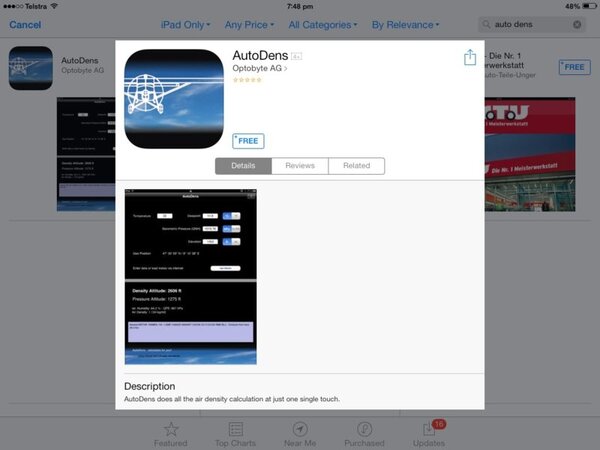

dazza 38 Posted January 21, 2014 Posted January 21, 2014 I have a density altitude App on my iphone . Its free and a great app. Go to the apple store and type in density calculator. If you dont have a iphone sorry i cant help you :)
motzartmerv Posted January 21, 2014 Posted January 21, 2014 Lol..You will then need to use maths!!!!..DOH!!!!
dazza 38 Posted January 21, 2014 Posted January 21, 2014 No maths involved if you are close yo s airport, just press one key and it down loads the current information. At home it picks coolangatta which is 15 kays from home. When at Boonah where i fly from, it uses Amberley which is close enough. Cool stuff, i showed my CFI and he loved it and down loaded it himself.
