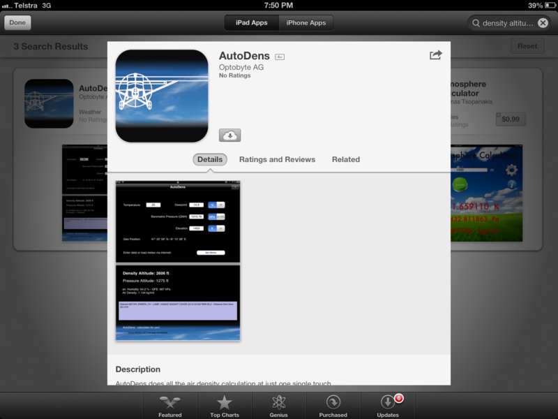

dazza 38 Posted January 21, 2014 Posted January 21, 2014 None of them it says auto dens . Im not too good with this computer stuff. I will screen shot it and have a member here that is on facebook put it on here.
DrZoos Posted January 21, 2014 Posted January 21, 2014 None of them it says auto dens . Im not too good with this computer stuff. I will screen shot it and have a member here that is on facebook put it on here. This one ? 1
dazza 38 Posted January 21, 2014 Posted January 21, 2014 This one ?[ATTACH=full]26997[/ATTACH] Yes mate thats it :) press the " get medio" icon and the phone via GPS will down load the latest data from the closest airport

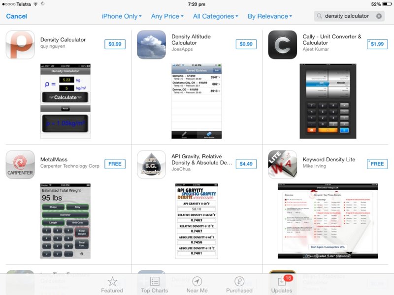

SDQDI Posted January 21, 2014 Posted January 21, 2014 Trying this I'm not the best at photo uploads, search 'density altitude calculator' and it is the second one that pops up:thumb up: 1
SDQDI Posted January 21, 2014 Posted January 21, 2014 Lol took me so long to work out how to post it that you already had it:smash pc: 1
