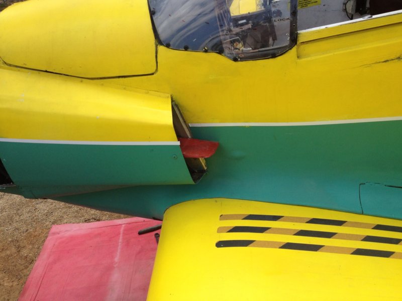

bexrbetter Posted November 25, 2014 Posted November 25, 2014 I have been using jab motors now for 10 years and I don't have any conplaints nor have i had any failures. I didn't follow the installation manual as I feel it will make your motor run hot. So "no complaints" except for the complaint, got it. Maybe you could share what your "anti-motor run hot" procedure is please? I know one guy who extracts the engine bay air from directly behind the Jab engine rather than a torturous exit path in an aim to help cooling for example. 1
Old Koreelah Posted November 25, 2014 Posted November 25, 2014 ...I know one guy who extracts the engine bay air from directly behind the Jab engine rather than a torturous exit path in an aim to help cooling for example. It's easy with a low-wing; exit in the low-pressure area above the wing LE.
bexrbetter Posted November 25, 2014 Posted November 25, 2014 It's easy with a low-wing; exit in the low-pressure area above the wing LE. Was a high wing but similar idea.
