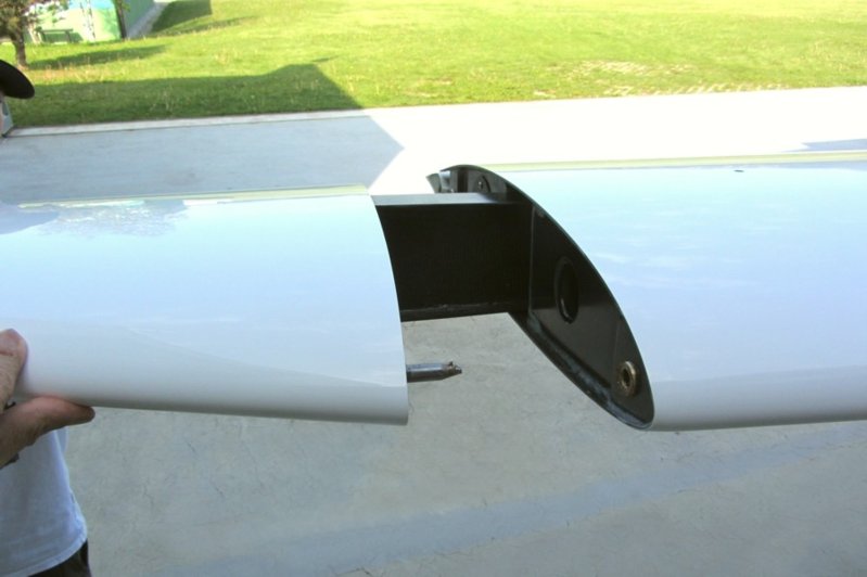

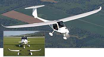

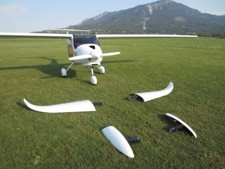

PA. Posted February 13, 2014 Posted February 13, 2014 A plane with wing options to give you choices? The Pipstrel Sinus Flex does that. 1
fly_tornado Posted February 13, 2014 Posted February 13, 2014 The virus has to have those tips to fit into a hangar though.
PA. Posted February 13, 2014 Posted February 13, 2014 You can fit either wing tips to the same wing. You can also remove them to help hanger the plane.

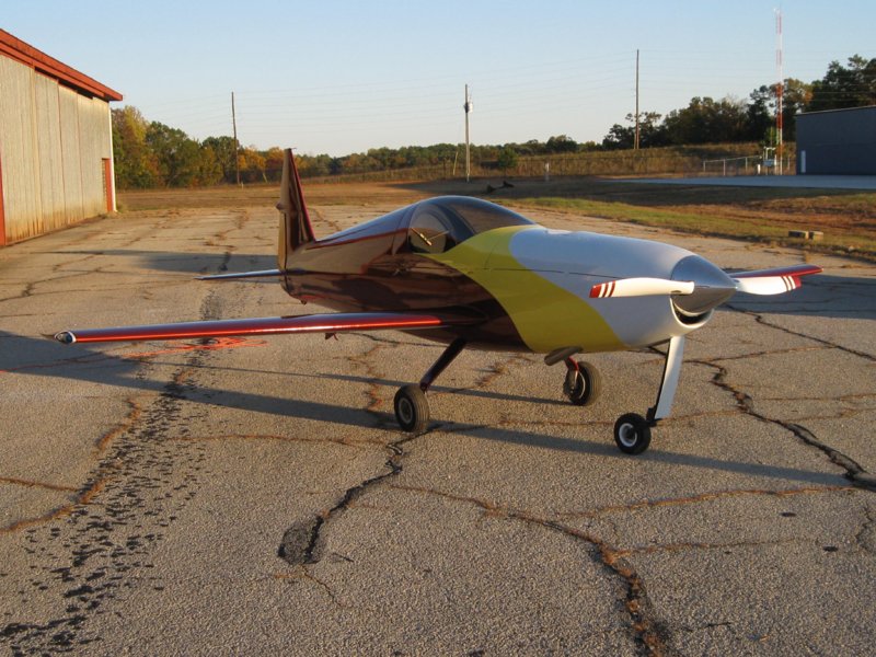

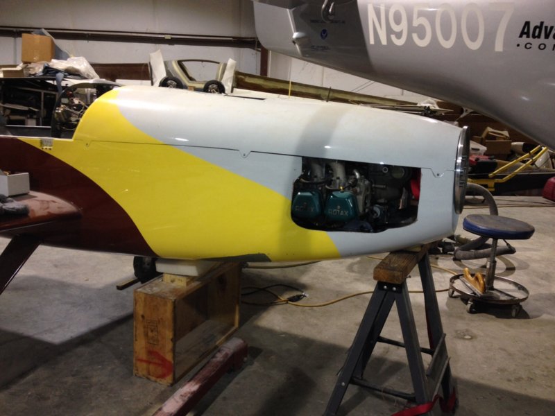

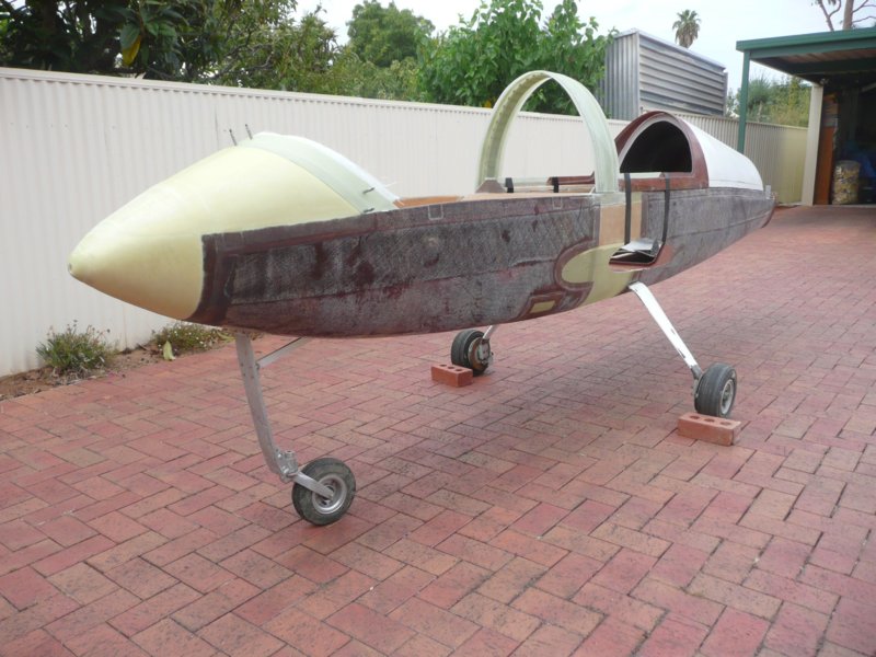

flyvulcan Posted February 13, 2014 Posted February 13, 2014 Fast!! Hence my Lightning Bug And my under construction Komet jet The sad thing is that I've not yet got to fly either of them. Since we bought the Bug, it's been having some mods done including the fitment of a Rotax 912ULS and the jet is still a little ways off flying. 3
Bob Llewellyn Posted February 14, 2014 Author Posted February 14, 2014 Fast!!Hence my Lightning Bug [ATTACH=full]27270[/ATTACH] And my under construction Komet jet [ATTACH=full]27271[/ATTACH] The sad thing is that I've not yet got to fly either of them. Since we bought the Bug, it's been having some mods done including the fitment of a Rotax 912ULS and the jet is still a little ways off flying. Does the Lightning Bug NEED a 912????
flyvulcan Posted February 14, 2014 Posted February 14, 2014 Hi Bob, The original Bug kit was sold way back in 1991 with the AMW808 engine of 90hp which was then subsequently upgraded to 100hp. AMW (Cuyuna) no longer produce this engine and in any case, it has not proven at all reliable in use on the Bugs that have flown. I, along with fellow Bug builder in Adelaide, Milton King, own the rights, molds, tooling, spare parts inventory etc. for the Bug and we intend to release an improved kit version later this year. For the aircraft to be successful, commercially as well as for our own personal aircraft, it needs to be easily built, FAST and reliable. While it performed quite well with the original 90hp (indeed, I own the wreck of the prototype Bug which was written off in a forced landing when it suffered an engine failure in the Sun100 air race during Sun'n'fun 1992 I think. It was doing 225 knots during that race), we wanted at least 100hp in the commercial venture, while keeping the weight down and giving it reliability and the Rotax912ULS is our preferred option. Our aircraft in the photo above is about to fly with the 912 installed. We are just waiting on a custom prop. We found that we only need to add very small cowl cheeks to fit the 912 so we can keep the lines close to the original, so we expect very little performance degradation due to the 912's opposed configuration. Here's a pic of the 912 being installed: So to answer your question succinctly, no it does not need the 912ULS or 100hp. However, we believe this engine to be the optimum choice for the Bug at this time. Cheers, Dave
Bob Llewellyn Posted February 14, 2014 Author Posted February 14, 2014 Looks very neat. Experimental I presume... I look fowards to hearing more! Hi Bob,The original Bug kit was sold way back in 1991 with the AMW808 engine of 90hp which was then subsequently upgraded to 100hp. AMW (Cuyuna) no longer produce this engine and in any case, it has not proven at all reliable in use on the Bugs that have flown. I, along with fellow Bug builder in Adelaide, Milton King, own the rights, molds, tooling, spare parts inventory etc. for the Bug and we intend to release an improved kit version later this year. For the aircraft to be successful, commercially as well as for our own personal aircraft, it needs to be easily built, FAST and reliable. While it performed quite well with the original 90hp (indeed, I own the wreck of the prototype Bug which was written off in a forced landing when it suffered an engine failure in the Sun100 air race during Sun'n'fun 1992 I think. It was doing 225 knots during that race), we wanted at least 100hp in the commercial venture, while keeping the weight down and giving it reliability and the Rotax912ULS is our preferred option. Our aircraft in the photo above is about to fly with the 912 installed. We are just waiting on a custom prop. We found that we only need to add very small cowl cheeks to fit the 912 so we can keep the lines close to the original, so we expect very little performance degradation due to the 912's opposed configuration. Here's a pic of the 912 being installed: [ATTACH=full]27272[/ATTACH] So to answer your question succinctly, no it does not need the 912ULS or 100hp. However, we believe this engine to be the optimum choice for the Bug at this time. Cheers, Dave
flyvulcan Posted February 14, 2014 Posted February 14, 2014 Yes, definitely experimental. The stall speed is a tad high... Hopefully the new Bug can tempt a few folks to diversify to the alternative side of recreational aviation, as a supplement to their "ultralight" endeavours. 1
