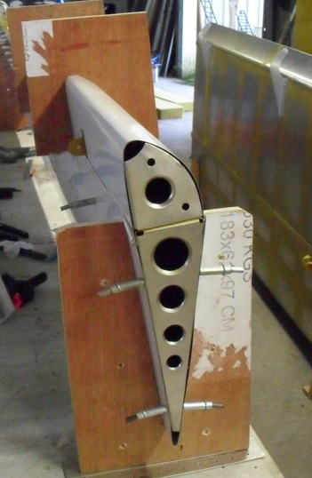

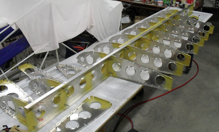

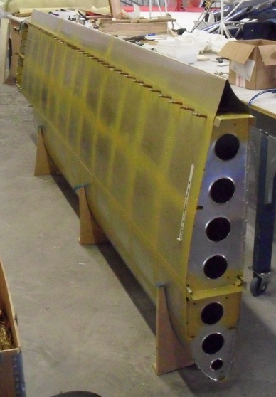

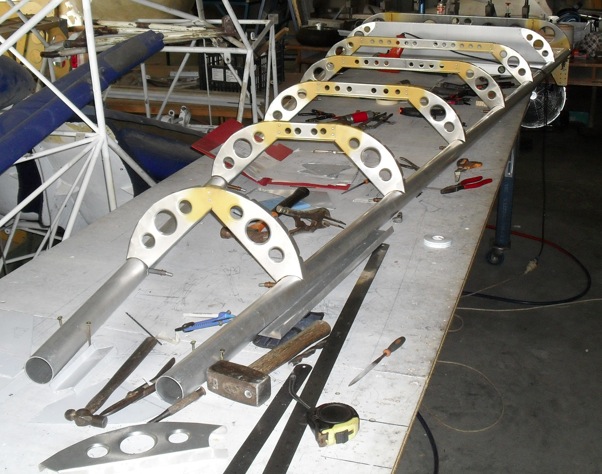

They are everywhere and I am sure that there are more to come in the scheme of things and in the interest of keeping statistics I am sure there are now around 300 in this structure of varying sizes. They have been filed and flanged and I feel I am nearly an expert on them.
I would reckon though that it still made the airframe lighter......so it could still be a lightening hole.
Definitely lightening holes and around 300 of them so far in the fuselage and more to come!!! They were certainly not formed by lightning although it might have been quicker but the hole shape and pitch would have been more erratic.

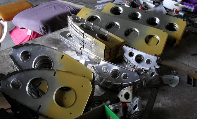

You flangeing them by hand , or do you have dies and a press? A die grinder with abrasive flapper wheels takes some of the hard work out of polishing the inside edge.
Have access to a series of dies and a manually operated press. Have basically completed a wing too which has many lightening holes in the ribs and spars that have been done in the same manner. I fly cut the holes or used a step drill.
It's fiddly work, but they look real nice when it's all done.
Lightening holes definitely give that 'aeronautical' look....

Yes and regardless I think I do damn good work for an amateur. Obviously I wasn't watching when you snuck those photos in!
You know the circular holes also add strength too. Amazing little holes they are. Looks really nice.
I just wanted to express the fact that I felt surrounded by lightening holes that was all Crayonbox and they grew in quantity again today. This little plane is a prototype. There is already a wing that is pretty well complete and another wing that has the spars together and the trailing edge skins pinned in place. Have been doing this around full time work for the past 10 months. The person who posted the photos is the designer and I am the builder and I say to the designer often - I want to fly it before I die!!! I so wish I had a magic wand 080_plane.gif.36548049f8f1bc4c332462aa4f981ffb.gif

For your further information, all of this has been a total scratch build and I remember well cutting out the ribs from 12 x 4 sheets on the floor of the hangar and how much my hand hurt 038_sweat.gif.5ddb17f3860bd9c6d8a993bf4039f100.gif
Can I ask, is the lip turned a full 90 degrees and is the radius different for different diameters?
The answer to that Downunder is probably in the earlier photos in this thread that were posted by pylon500. He made the set of dies that I am using and he is also designing this plane while I am just merely the builder. The dies range in size from 12mm up and there are 5 different sizes all up. There probably is slight differences in the angle of their flanged edges, etc but the dies were made not manufactured.
I can't speak for P47, but usually the flange on lightening holes is around 45 degrees. It is the flange that adds the stiffness.
